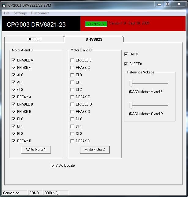

    I have inserted the snapshot of the DRV8823 EVM GUI. I have connected a 0.8A stepper motor. My Vref calculated was 4.24V which I have given externally (as the EVM POT limitation is 3.3V and DAC POT limitation is 2.5V)
    My stepper motor is not rotating and it gets heated up!!!
    Please help me with your expertise.
  • Hi Siva,
    The motor will not rotate as the current is not changing in the phases. The DRV8823 GUI allow for simple ON/OFF control of the H-Bridges to evaluate them. You would need to write your own firmware to modulate the current in the proper sequence for stepper rotation.
