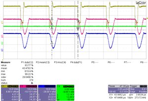

I'm using the DRV8332 to drive a BLDC motor using non-complimentary control. We PWM the driving phase and hold the other phase low. This works well most of the time but when the duty cycle begins to increase due to motor loading we see a state in which the high side is still PWM-ing however the other phases are in high impedance. It seems as if the low side FET is not on therefore the current stops and the motor stalls. Here is a plot of the phase outputs during a stall.
C1= Phase A, C2= Phase B, C3= Phase C, C4= 12V supply for GVDD.
During this conditions the FAULT line never goes low and the 12V supply is solid. The OC_ADJ resistor is 20K and is set for CBC current limit. The datasheet says " If you prefer PWM switching one channel but hold low side FET of the other channel on (and third channel in Hi-Z) for 2-quadrant mode, OT latching shutdown mode is recommended to prevent the channel with low side FET on stuck in Hi-Z during OC event in CBC mode."
The motor current doesn't seem high enough to trigger the current limiting feature but the low side FET stuck in HI-Z seems to be what I'm seeing. Can you explain what is happening and what I can do about it?

    It is possible that you are experiencing an OC event, as described in the 3rd paragraph of page 12.
    It is important to note that if the input to a half bridge is held to a constant value when an over current event occurs in CBC, then the associated half bridge will be in a HI-Z state upon the over current event ending. Cycling IN_X will allow OUT_X to resume normal operation.
    In the event described above, the FAULT signal will not go low.
    Please try cycling the output stuck in Hi-Z to determine if it recover. A small high pulse (50 to 100ns for example) at the end of the PWM cycle is generally all that is required.
  • Mike, depending on the measurement technique, the actual current might be higher than what you measured. Using a current probe around a phase wire is typically reasonably accurate.
    You could try setting OC latching mode, and verifying you get a latched shutdown. That would further confirm you're hitting OC. Or also try reducing OC_ADJ resistance.
  • Rick,
    Thanks for the response. This appears to be what is happening. We added a 100ns "un-latch" pulse on every cycle and the system performs nicely now.
