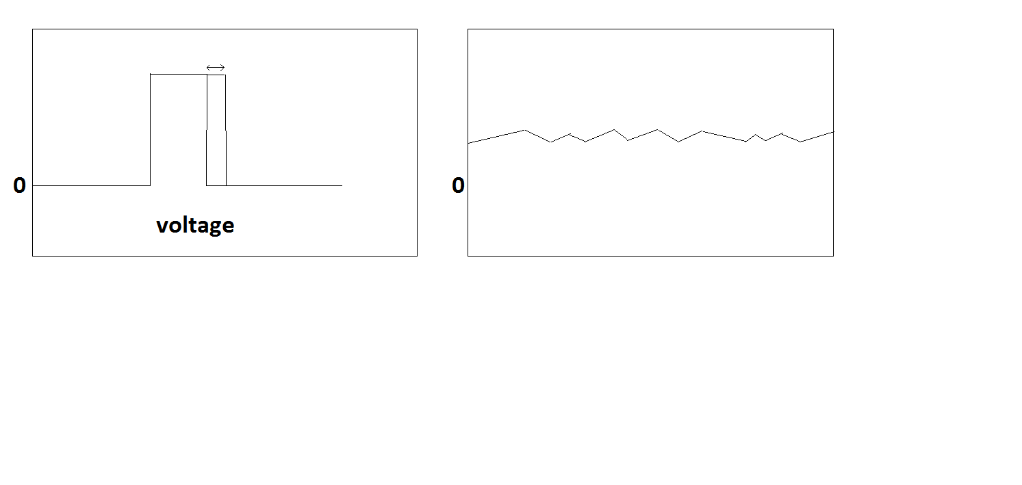

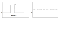

    The driving circuit of my design was the same as on page 16 of the datasheet. The FET I used was IRF7341, R_ISENSE was 51mR, optional filter was 100R and 560pF. The vibration went away by removing the 560pF and replaced 100R with 0R. I try to understand why would this filter create such an impact to control.
    When I measure the voltage and current waveform on the problematic driver side , I found the duty cycle on the motor was not fix and the current had some random frequency ripple during holding. It looked to me that the driver was constantly trying to compensate and regulate.  I drew the waveform out as the screen capture doesn't really show how it was.

  • Austen,
    The DRV8711 will employ current regulation to maintain the position of the stepper motor. The current regulation methods and how the level is determined are outlined in datasheet. An RC filter on the SENSE line could affect the accuracy of the readings from the internal amplifier. I would suggest removing this.
    Is there any particular reason you have an RC filter on the SENSE line?
