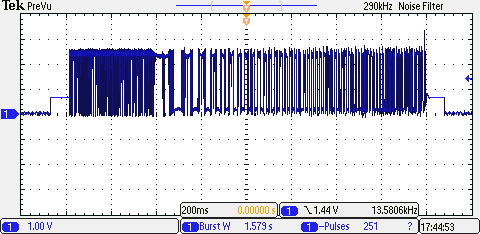

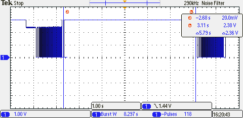

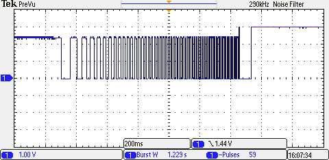

I tried to run a BL-DC motor from MAXON P/N: 455020 using DRV10963, I applied a 4kHz PWM signal to the PWM input, I am using 3.3V as Vcc. When the power is applied the motor runs for about 1.5sec and stalls little more than 5 seconds and run again for same amount of time. Datasheet of the motor says no load current at 6V nominal voltage is 38.6mA, the current draw is about 260mA running from 3.3V supply when the motor runs which is lower than the current limit of the iC. I have captured the pulse output from FG pin when the motor runs there are exactly 59 for each run cycle separated by ~5.8sec ..see the two plots below.
Any idea why it is doing like that.

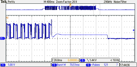

         Could you help capture the phase U current waveform?
        It is better to have one overview and another one with zoom in view(10ms/div) just before motor stop.

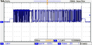

  • Hi Yisong, I do not have a current probe to capture the phase-U current as you have requested but captured the voltage at phase-U with respect to GND see the attached plots, the 1st plot is zoomed in towards end of run cycle. Thanks, Zahed
  • Hi Zahed,
    By looking at the voltage waveform, the VCC is about 2.5V instead of 3.3V. is it true?
    The motor stops when it is transfering from open loop to closed loop. DRV10963 control logic has a short period of time coasting the motor between open loop and closed loop. We expect the motor to do coasting for 2~3 cycles before handing it over to closed loop. The coasting relies on the motor inertial. If the inertial is not big enough and the friction load is big, motor will stop in this gap.
    Your case seems like this condition. If that is the case, DRV10963 may not be a good fit in your application.
