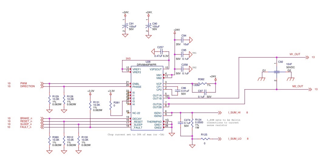

    Here's the schematic:
    The board is very difficult to probe while it's in the system, but we do need to confirm that we are commanding the driver the way I'm saying we are...

  • Hi Bill
    One possibility is that you only have one R381 at Pin I3 for the current setting, if any issue happened on R381, the current may be set to Zero then the outputs lost.

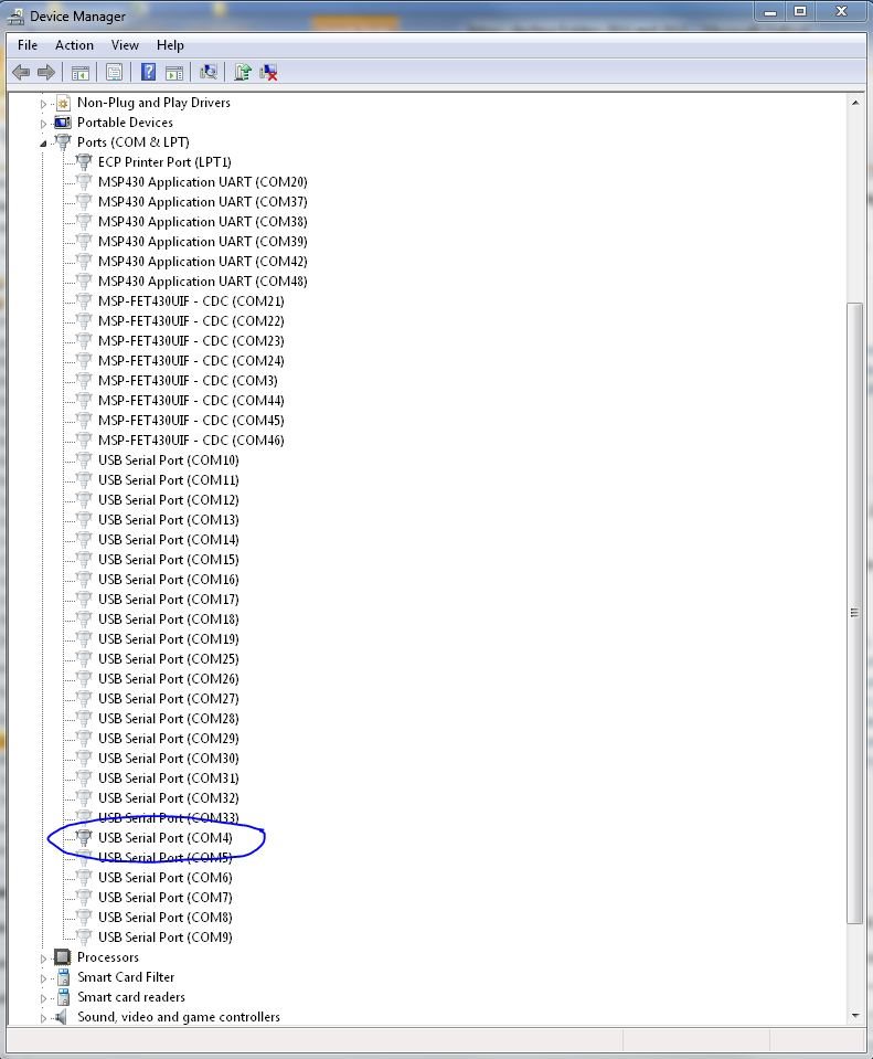

  • Hi Bill,
    This is strange. Would you try the following and provide a screen shot? To attach the screen shot, select "Use rich formatting" at the lower right of reply.
    Bring up Device Manager as you already have done.
    Open the Ports (COM & LPT)
    Select View and Make sure "Show Hidden Devices" is checked.
    Capture the ports and attach this.
    I am using Windows 7, but I think this should work on any version. Below is what is shown on my PC. Many of these are no longer used, so from time to time I have to go in and uninstall the COM ports.

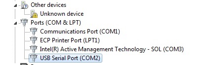

    Here's the screenshot (note it's now showing up as COM2 now that I forced it):
    I've since forced it to use COM4, and clicked through the dire warnings that Windows gave (it doesn't like having two COM4's active).  The 8840 application now has both COM2 and COM4 greyed out, and it says COM4 is not a valid port number when I try to "connect".

    Prior to sending, there is an Unknown device in the Other devices section.
    Can you uninstall that and COM2 and try again?
    It is surprising that there are no greyed out COM ports. Have you uninstalled all of them?
