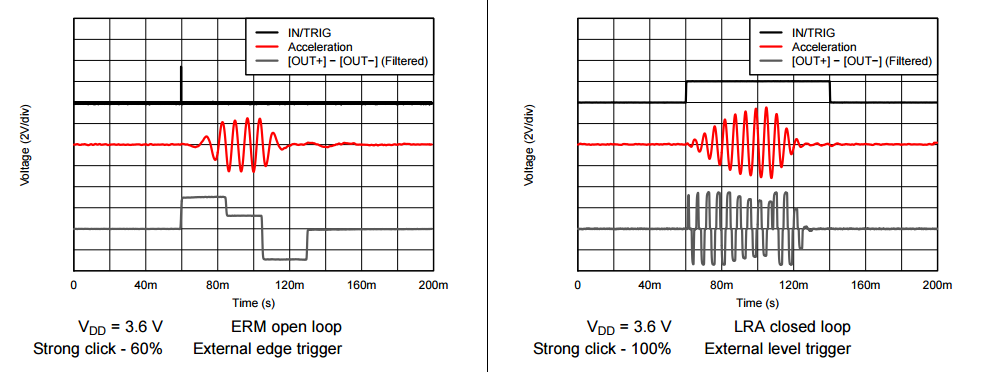

    The only way I can think of solving your requirement is to get away from the I2C expander and some hardware modification and some soldering. There are enough GPIOs broken out on the MSP430 to toggle GPIOs at 60Hz. We need to connect these to the TRIG pins of all the DRVs -> set it in external trigger.
    Here is a picture of the external trigger operation.

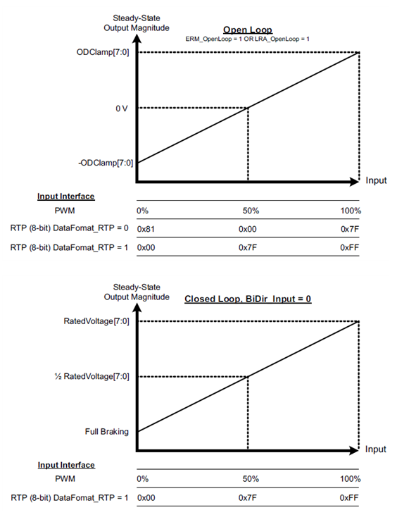

  • Thanks. I think my description of my approach was lacking. I'm using the RTP register so I'm passing a new value to the register at roughly 60hz. There are no effects, just a constant updating of the RTP register based on feedback coming from the simulator. Think of it this way, if you're in a flight simulator, you can feel how hard you're banking, even if you can only see clouds, so nothing is predetermined.
    I completely bypass the MSP430 as I'm using an FTDI I2C master to send commands directly to the DRV2605 RTP register.
  • Kirk,
    Hmm.. I see... Are you using the FTDI 2232 with the Multiprotocol Serial Engine?
    Then I would suggest that you use the RTP functionality with PWM interface where the duty cycle that you provide would relate to the drive amplitude. This could give you greater than 60Hz update rate.
