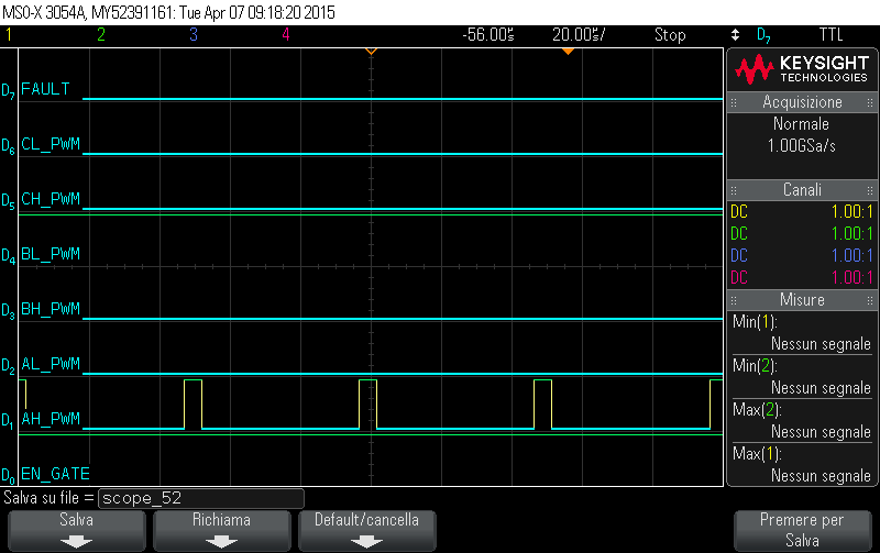

DRV8301 fault in 6 pwm mode
Other Parts Discussed in Thread: DRV8301
I'm working with the kit DRV8301-hc-c2 with a BLDC motor.
I would like to implement the switching scheme in Figure
When I apply this pattern, see state 0 (AH in pwm, BL in ON) ; you can see figure below ,
the device DRV8301 is always in fault.
Can I apply  this switching scheme on the kit DRV8301 hc c2 without any fault ?
I attach these files :
- BLDC_int.c , see the level 1 , to find "pwm1.CmtnPointer = 0;" . then , I'm testing the state 0
- f2803xbldcpwm_BLDC.h , in BLDCPWM_MACRO(v) see only v.CmtnPointer = 0.

  • Hi Dario,
    Have you read out the status register when fault happened?
    Have you attached the motor? Can you monitor the motor current?
    It is possible you met over current from the Vds sense. You can check with very small duty cycle first to see if the fault still happen.
    in the figure below, there is the contents of the status registers after fault's event.
    There is only fault's flag bit equal to 1.
    BLDC motor is not connected because currently the algorithm is fixed in this state:  AH (pwm), BL (ON).
    The event happens also with duty cycle equals to 0.05%.
    What do I should to solve this problem ?
    I have read the table 5 "Fault and warning reporting and handling" from the datasheet.
    Which did event happen on my kit?
    i think my fault is related to DVDD undervoltage.
