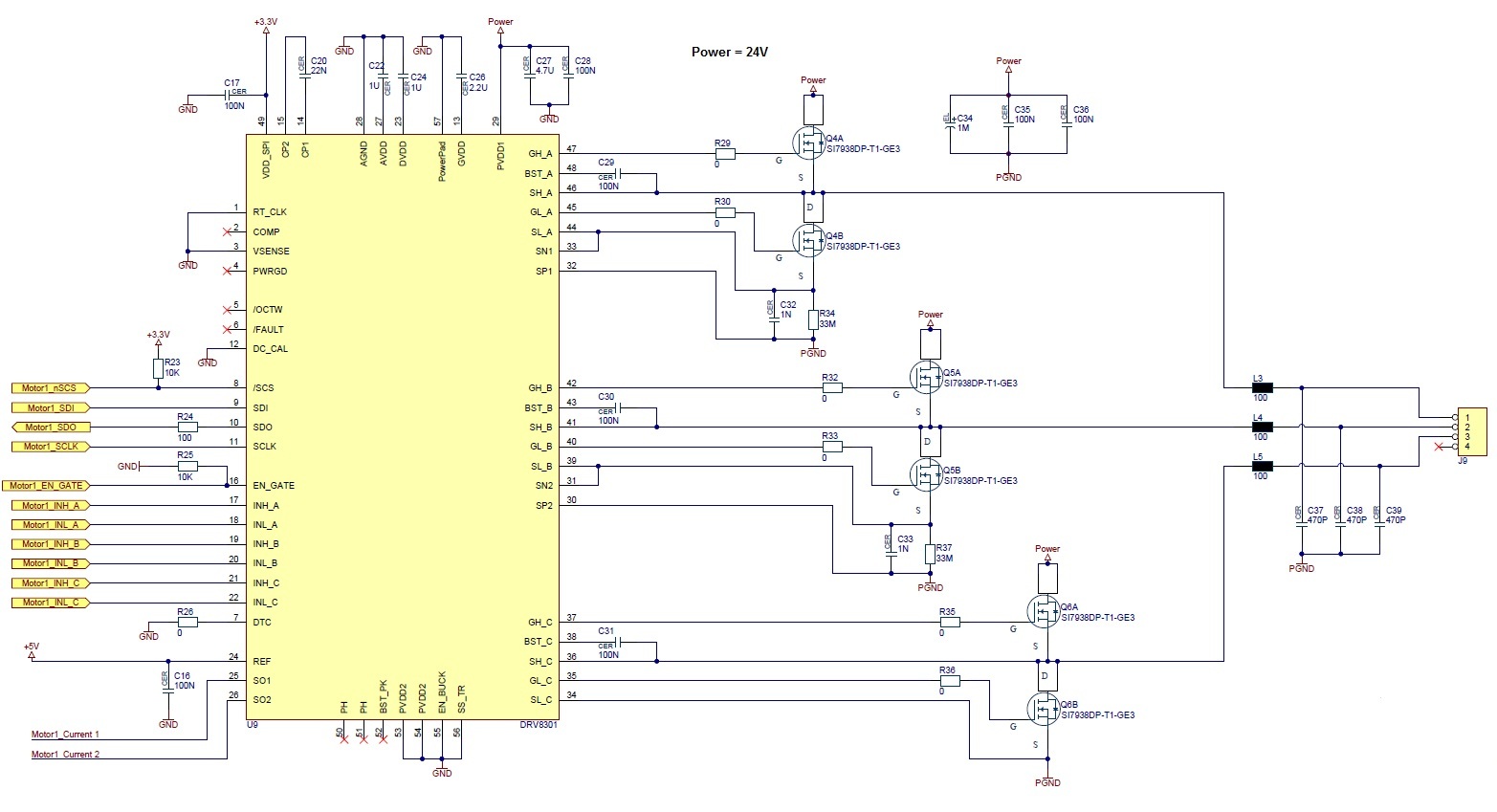

    • Can you provide a snapshot of the schematic around the DRV8301? We can set up a private communication over E2E if it is confidential.
  • Hi Nick
    Supply Voltage is 24V. Attached you find the schematic of the DRV8301. I have to take some scope captures. I will send them later.

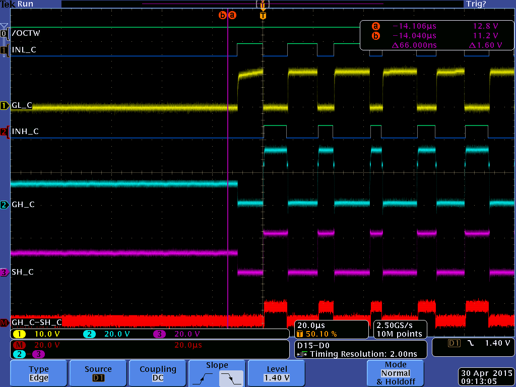

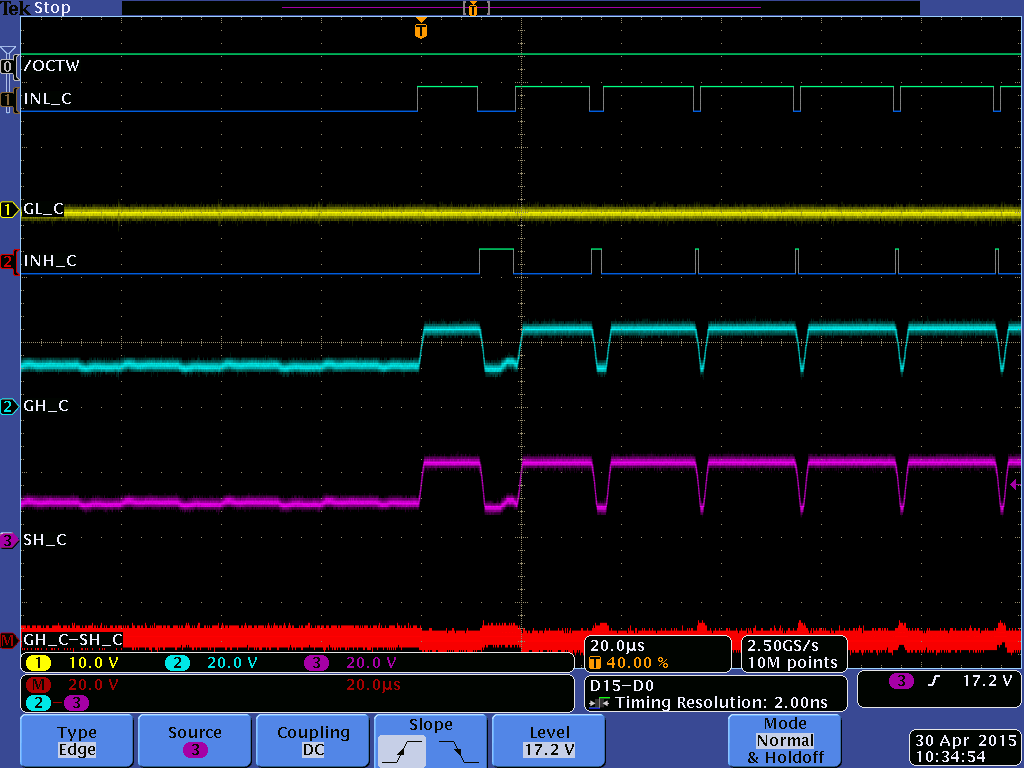

  • Hi Nick,
    I've done some measurements. Attached there are two screen captures of the scope. The first one shows normal operation. The second one shows the moment, when the DRV8301 ignores the low-side input signal. Measurements were done referenced to GND. So I added a math-calculation to get the real high-side signal on the FET.
    Normal operation:
    DRV8301 ignores low-side input signal:
    regards,
    Marco
  • I made an additional test with disabled over-current protection. The behaviour stays the same. Low-side input signals are ignored.
  • Hi Marco,
    This is quite unusual. I cannot detect any difference between the two scenarios. We have seen an condition somewhat similar to this (low-side not enabling) but it was related to power sequencing of the device. It did not affect normal operation after the device was successfully enabled and we have no seen this anywhere else.

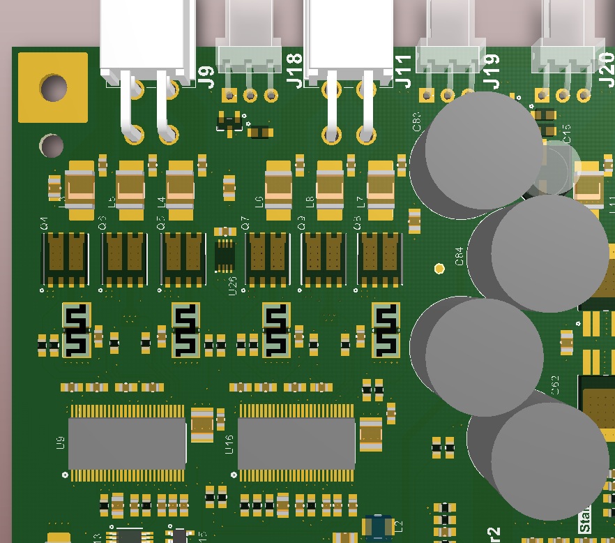

    I also checked the layout. I use a 4-layer layout with proper ground an power-planes. In the picture you see the placing. During the tests the second DRV8301 was disabled, so there is no interference between the to channels.

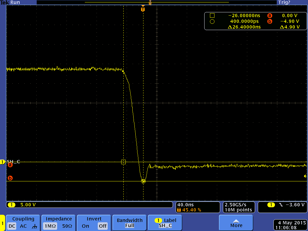

    Can you take a scope capture of the MOSFET Vds slew rates with the higher and lower current settings? What is the MOSFET PN you are using?
    The default setting (1.7A) is generally fairly high for a standard MOSFET. This can lead to very fast slew rates which introduce switch node ringing and other issues. We will generally lower the setting and introduce series resistance to reduce the strength of the gate drive.

    I measured Vds of the low-side FET of phase C (Designator Q6B) with 1.7A and 0.7A gate-current setting. As you can see, there is ringing and there is a difference between the 2 settings. Altough the difference is not that distinct.

  • Hi Marco,
    Yes, I would increase the gate resistance and reduce the gate drive strength. The ringing that you are seeing is still fairly severe.
    I would target a slew rate of ~100ns to try and reduce the ringing furthur.
    Can you try the 0.25A setting with 10Ohm of series resistance?

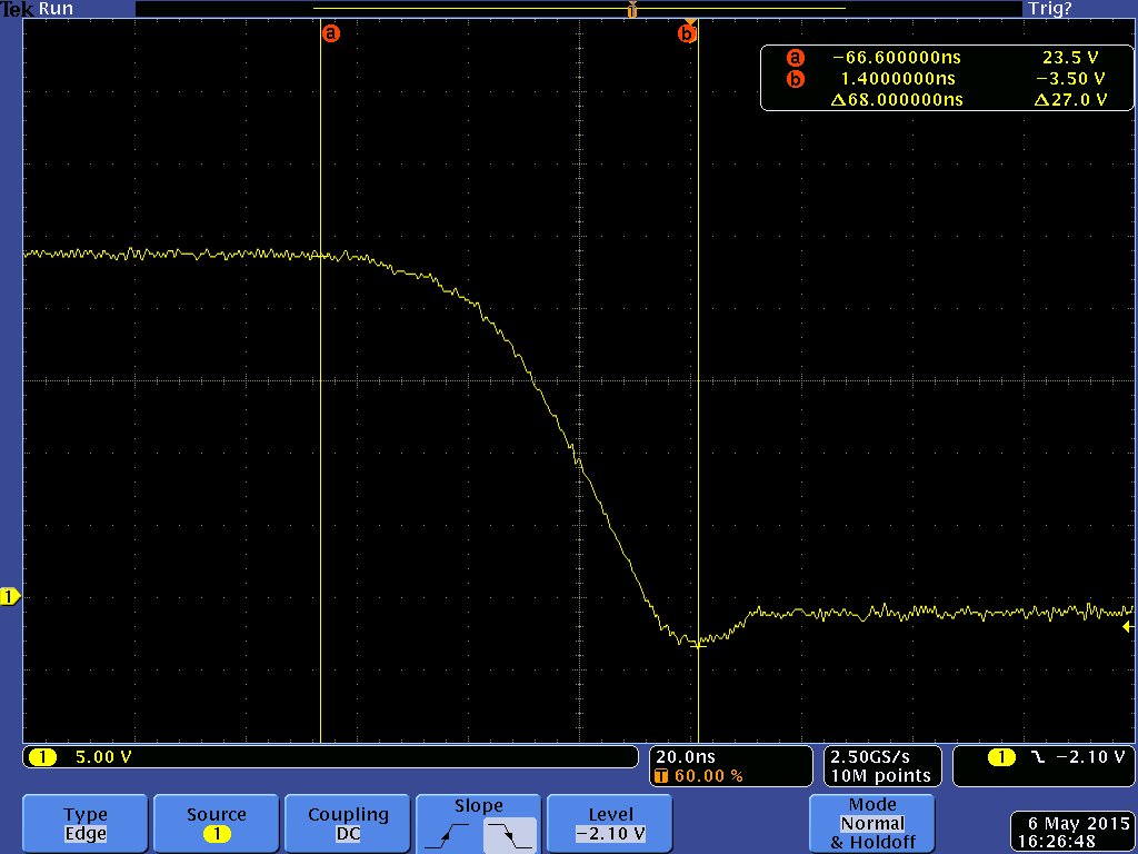

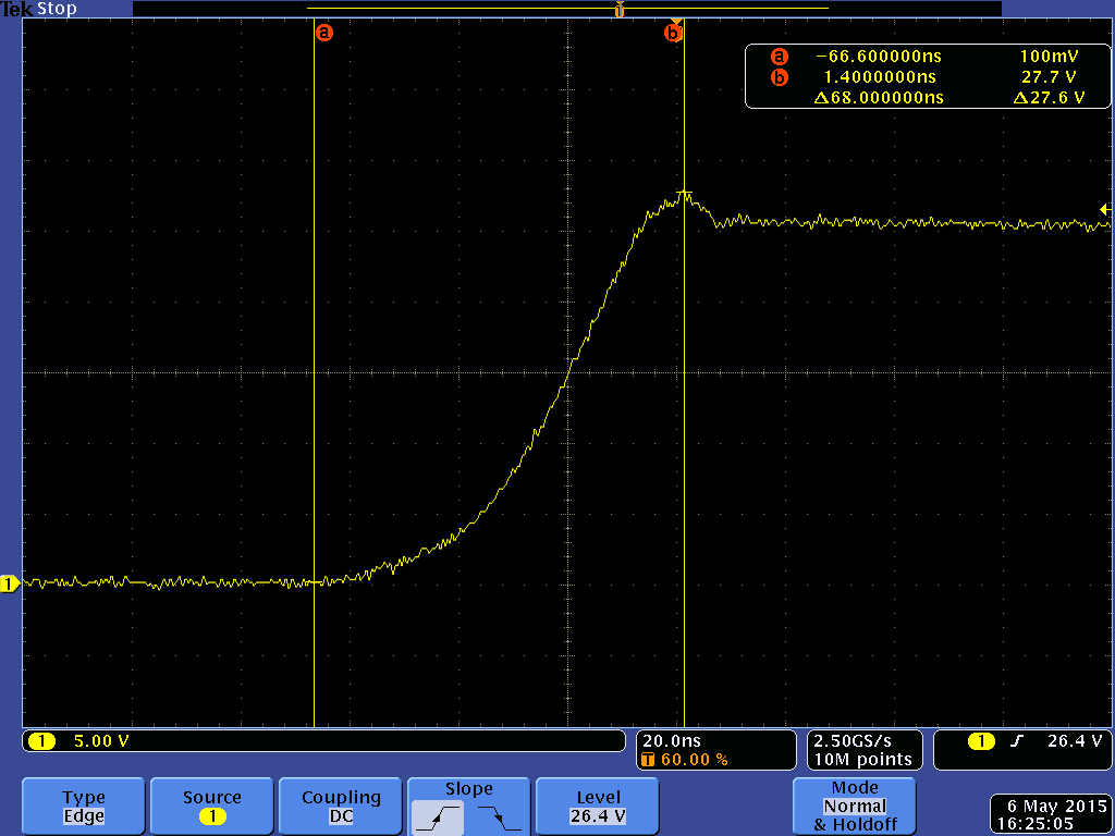

  • Hi Nick
    I tried different combinations of gate resistor and current settings. 0.7A setting and 10Ohm of series resistance seems to be a good trade-off between overshoot on Vds and fast switching. See attached the measurements of Vds. What do you think?
    switch-OFF
    switch-ON
  • Hi Marco,
    These slew rates seem reasonable.
