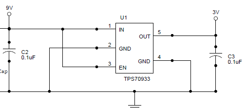

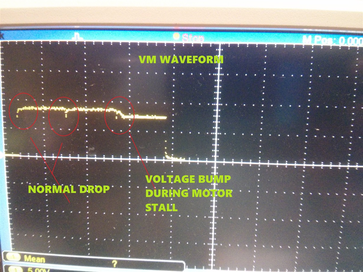

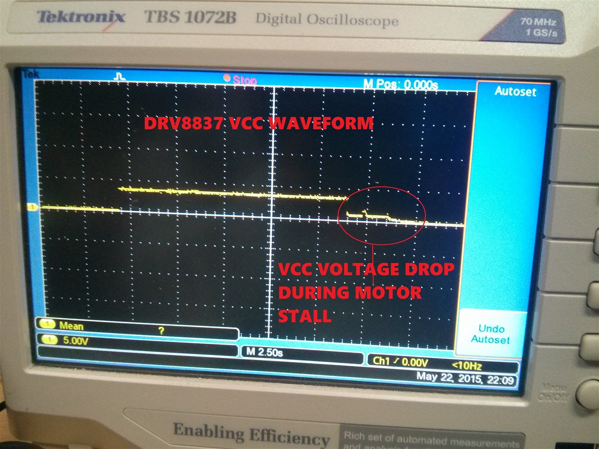

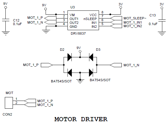

I am using DRV8837 to drive 9V dc motor consuming max 120mA current. Vm is connected to 9V battery.To generate 3.3V logic voltage I have used TPS70933. Everything is working fine when motor is running free but as soon as I load motor, regulator heats up instantaneously. Vm cap and vcc cap for drv8837 is 0.1uF.Kindly please suggest solution for this problem.
