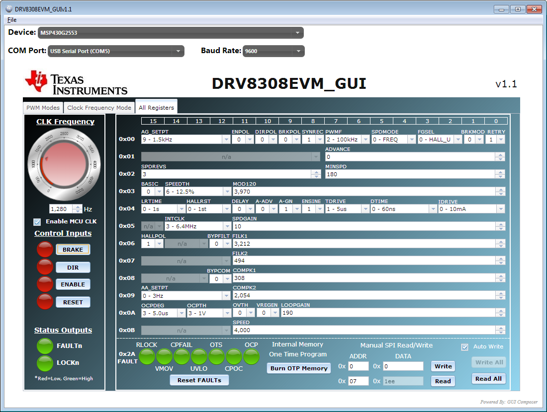

I'm trying to implement a motor control system using the DRV8308, initially with the EVM. Two recurrent issues at the moment, to do with locking the speed and stalling at startup.
At startup, sometimes the motor stalls and draws a large current from the supply. When it does this, current is going into one phase, out of another, and there is no current in the third phase - this is what I expect, but the motor does not start. Sometimes giving it a shake is enough to get it going but obviously this is not reliable. Any advice on how I can reliably get this started?
The second issue is with getting speed to lock. When I get the motor going, it gets up to speed, and the lock indicator is activated. However, it then sits pulsing on and off, indicating a constant loss and regain of the lock condition. I can increase loop gain to get constant lock, but when I do this the variation in motor speed is much greater (about 1% rather than about 0.1% when it is on the verge of lock. I guess it isn't safe to run it on the verge of lock? Is there anything obvious to do with the settings to get tighter speed control.

  • I had tried to attach a scrrenshot of the GUI, but it hasn't worked. Settings are:
    FILK1=4093
    FILK2=954
    COMPK1=308
    COMPK2=2054
    SPDGAIN=10
    LOOPGAIN=120
    SPEED=4000
    AG_SETPT: 1.5kHz
    It's running in clock frequency mode using Hall U, trying to match a speed of 1280Hz.

    Could you send a picture of your GUI?  If you can't get this forum system to work, you can always upload to an image sharing website and post the link here.  Maybe I'll spot something that looks unusual.
    RE
  • I have the retry bit set and it does periodically try to start from the stalled condition - it never succeeds though. My thought in swapping the Hall signals was that since current is being made to flow in two of the phases when it attempts to start (I can see it with a scope current probe), maybe it's flowing in the wrong phases to get it moving from that start position, perhaps because the position of the sensors is slightly off. Understood that ADVANCE makes no difference at startup. Anyway, here's the GUI, let me know if there's anything that stands out as not being right.
  • Those settings look great. Btw, the "Write All" button in GUI v1.1 has a bug that we fixed in v1.2, but as long as you have "Auto Write" checked it doesn't affect you.
    Based on your past messages, it sounds like problem with starting up the motor only occurred when you used BRAKE without toggling enable. Another option you have is to set BRKMOD=1 and then toggle ENABLE when you want to brake/stop.
