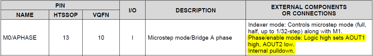

Hi Team,
I would like to know about M0/APHASE pin.
I understand that there is “pull down resister = 200kohm(typ)” if CONFIG pin is Low and there isn’t the pull down resister if CONFIG pin is High.
Is my understanding correct?
And, I have one more question.
I understand that there is “pull down resister = 200kohm(typ)” at M0/APHASE pin when VM=0V.
Because, I guess that this pin is APHASE  (so CONFING pin is pulled down) when VM=0V.
