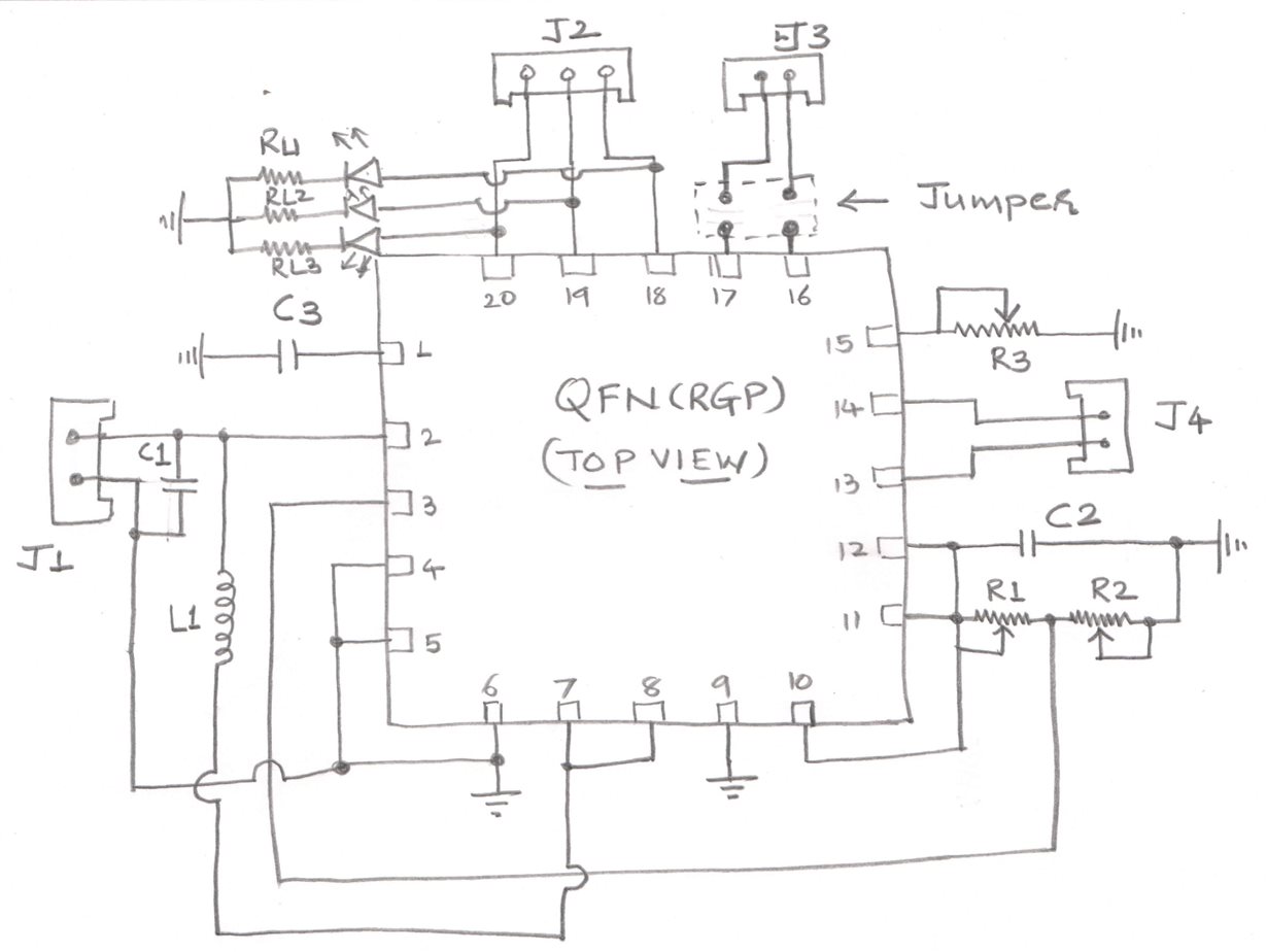

Hi i am designing high voltage amplifier to drive high value resistive load, i built the circuit based on the evaluation board of DRV 8662, here i have attached the circuit diagram of this IC, please check if this is wrong, i fabricated the PCB based on this circuit, now when i tried to test this board with capacitive load of 100nF, 400V, i do not get the expected output. i applied input of 200mVpp sine wave, gain set for 100, (G0=1, Vdd, G1=0 GND, EN=1, Vdd) Vdd=5V, R1= 392k, R2= 9.76k Rext= 7.5k, L=4.7uH, now, if C1 , C2(Boost capacitor)  and C3 (Pump capacitor) 100nF, but voltage rating are not matching to the specified in the Evaluation board, does it make any difference, if it makes then that may be the reason why i am not getting correct out put? anf if it works can i use the same circuit for DC voltage amplification?
  • Hello Chintan,
    Could you describe in more detail what you mean by the output isn't working? Also, you mentioned 400V, but this device can only go to +/-100V. Could you clarify?
    Finally, the capacitors should be rated for the voltage they intended to be exposed to.

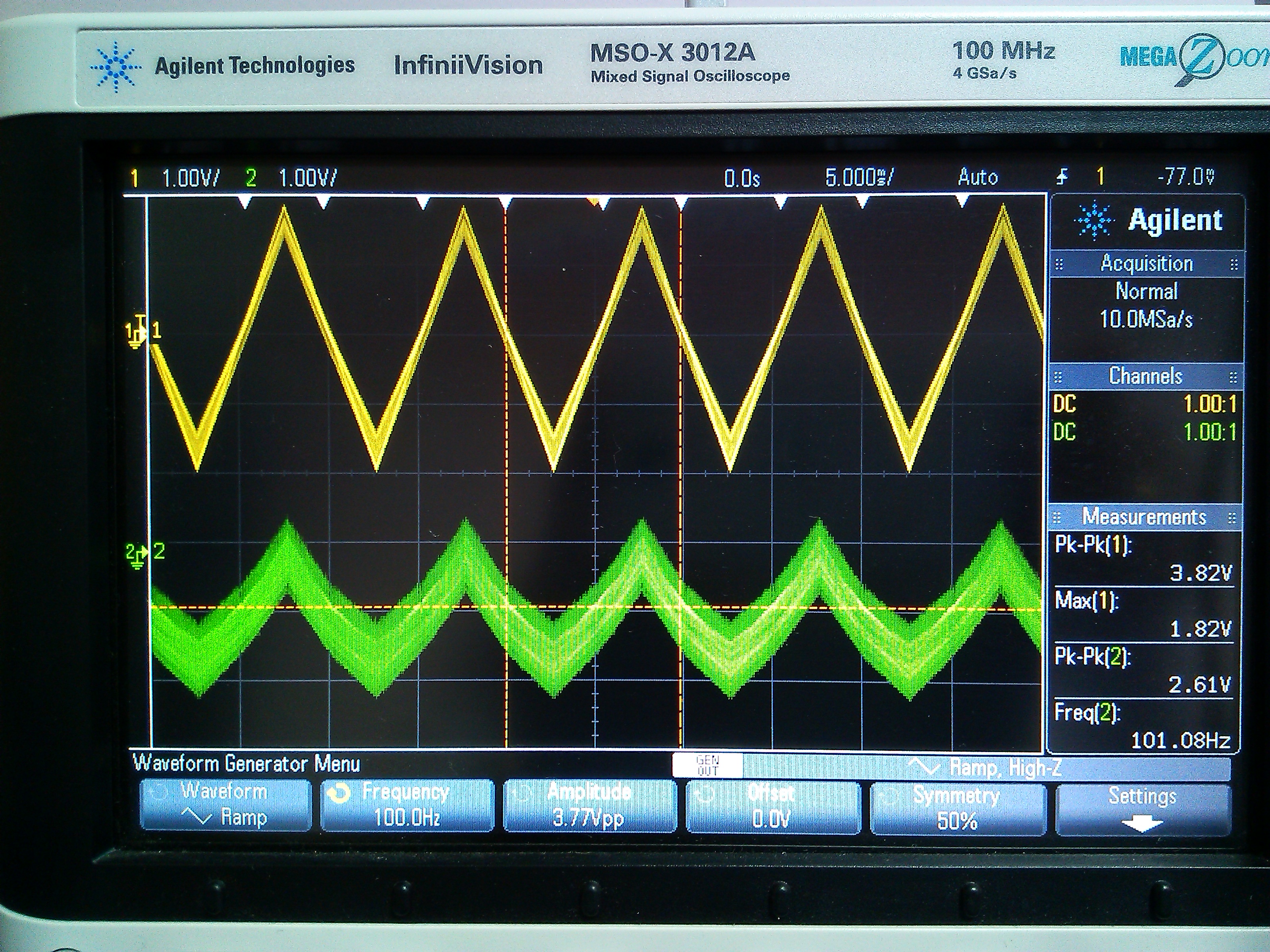

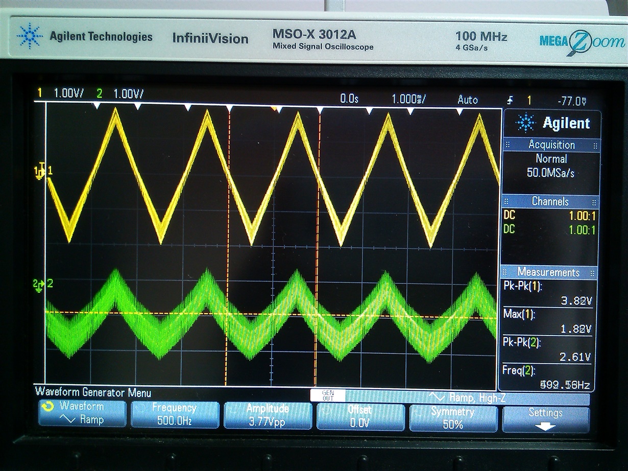

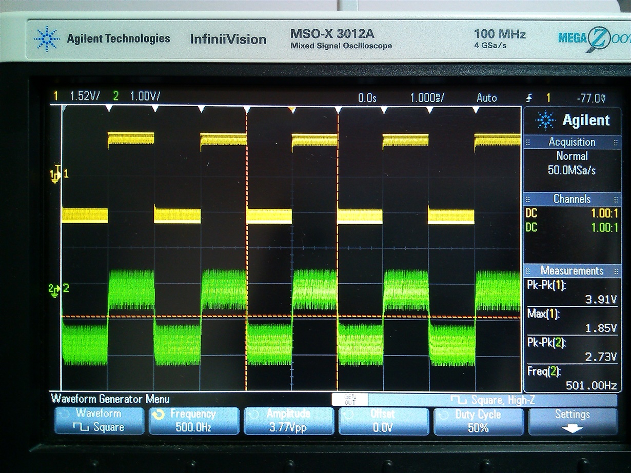

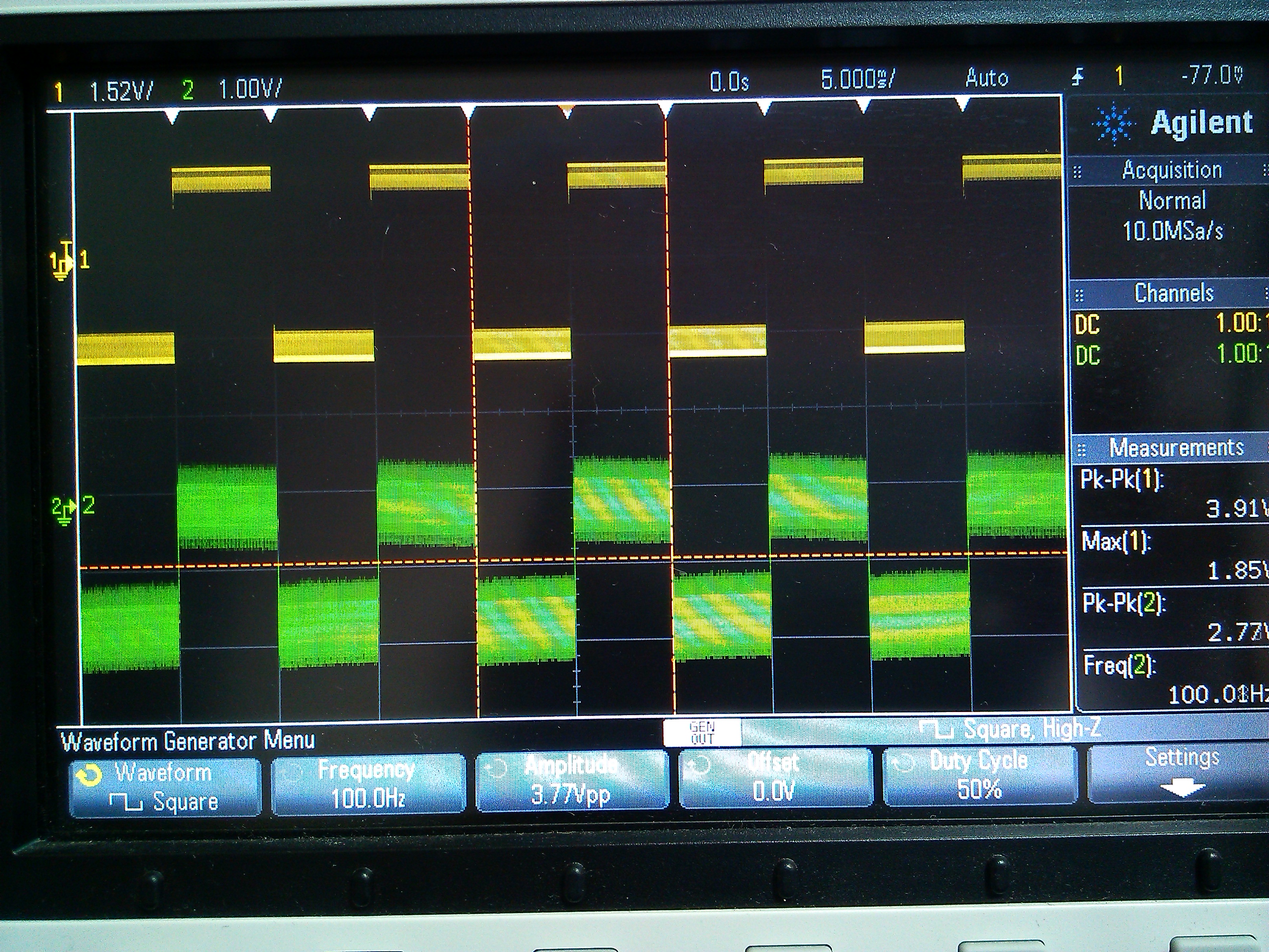

    here i have attached the screen shots of input and output waveform for two different types of signal for two different frequency.
    i also tried to check if changing gain resolves the issue but still output is same as for other gain setting, does it mean my amplifier section has some issue?
    because as per the gain setting boosting circuit works perfectly fine, please have a look at these screen shot and guide.
    with best regards
    Chintan
  • Chintan,
    You are correct, these signals do not look correct. How are you grounding your scope probes? In order to take these measurements, you need to connect a probe to OUT+ to GND and OUT- to GND and then do a math function to subtract the two. (This can also be done for the input side..)
