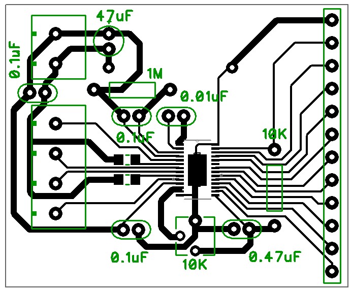

We have created DRV8825 driver pcb using through hole components and its working properly (With some issues mentioned over here https://e2e.ti.com/support/applications/motor_drivers/f/38/t/421282 )

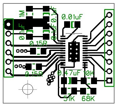

Now we have created same pcb with SMD components and addition of voltage divider resistors for Vref.
This circuit is not working, I am not getting 3.3V across V3P3OUT pin and after disconnecting voltage divider resistors from Vref pins, i am getting 3.3V at vref pins
w.r.t ground. and across CP1 and CP2 i am getting 24V w.r.t ground.
I am attaching both pcb layouts
Following is not working
Following is working
Can anyone tell me where i am going wrong?
