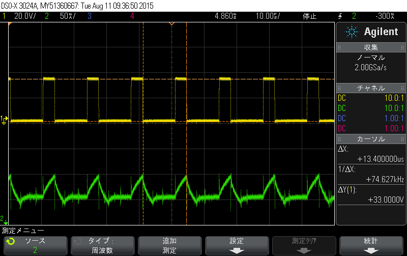

I confirmed waveform of operating current at occurring issue.
Current ripple frequency was 72kHz.
I think a noise(sound) cause is current ripple.

  • Hi Wilson,
    Thank you for your support.
    Please see the attached file.
    Seting is the following.
    - TOFF : 10us
    - Deacy : Adaptive decay
    - Step : 1/4
    - VM : 33V
    - chopping current : 0.5A
    - torqu: 100%
    We will not hear anything at the PWM frequency is above 20kHz. I think so too.
    But I heard noise.
    I don't understand this mechanism of this issue.
    For the reason, I guessed that something in the motor vibrated by switching frequency and noise was heard.
    Could you advice me this mechanism of this issue, please?
    Shimizu
  • Hi Shimizu,
    Yes. That is true 74kHz. Can you hear noise just when you stop the motor and hold on a position with above current?
    For the noise, mostly there are two kinds. One is the PWM switching noise which is usually a high tone. It could be just the PWM frequency or the lower sub-frequency. The current regulation level changing during micro-stepping will also cause noticable noise even the PWM frequency is higher than 20kHz.
    Another one is the running noise which is due to the current shape or non-smooth change of the current, the tone is much lower based on the speed. Also it is the same range of the mechanical vibration when running.
    The combination of the two kinds noise are always there. Especially a stepper motor which is controlled rushing step by step.

  • Hi Shimizu,
    Checked on bench and I think I can understand the noise you mentioned. The main reason is because of in adaptive decay setting, there will be some current level setting points which made the device changing the decay mode adaptively always. So you will hear something just when the decay mode is changing. The changing happens at a lower frequency band which is hearable especially when you at high VM voltage.
    You can verify this by holding the motor at one step, then just change the current level setting with GUI. You will find at some level the noise will be much noticable. Then, at this point, you can just turn off the adaptive decay, and select a fixed Mixed decay mode, you will find the noise pattern changed and lower.
  • The sub-frequency is usually 1/n of the PWM frequecy, the current chopping is not a single frequency wave. If your scope can do the FFT, you will see it.

  • Hi Shimizu,
    Adaptive decay it's self means changing the decay mode between SLOW and FAST mode just as need all the time automatically. So you will not hear things when the state is stay in SLOW or FAST mode, but it is possibe to produce some noise when just at the time shifting the mode from FAST to SLOW or reverse, because there will be a tiny current shape change there and cause the motor have a tiny shaking. It is really dependent on the motors and VM level on how loud this could be.
