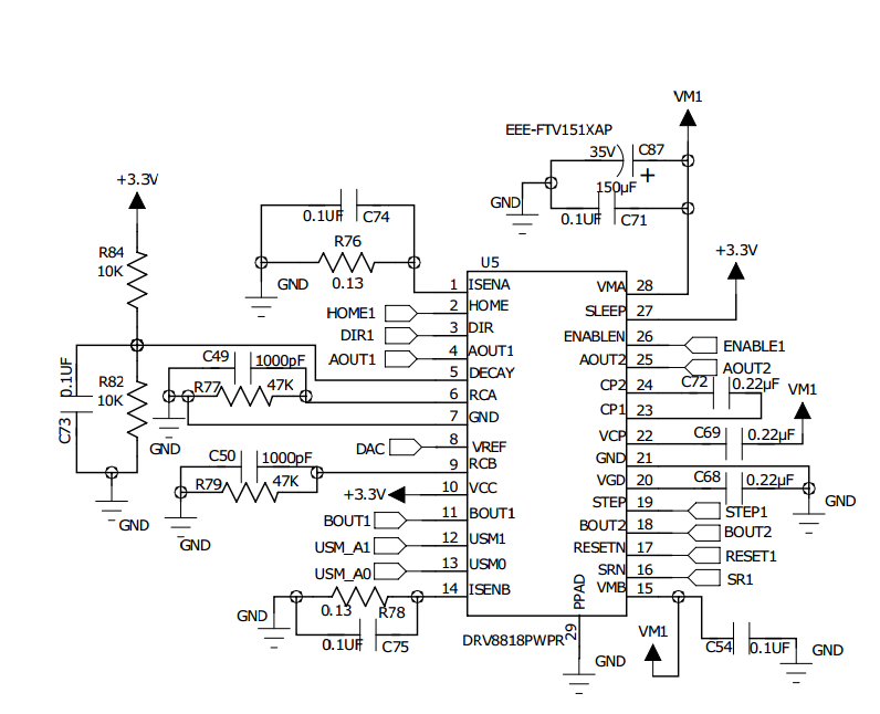

This is the first time I work with a stepper motor also as stepper driver and I'm using the stepper driver 8818 now! The problem is I saw that the holding current always has a minimum value which I can decrease it anymore even with Vref = 0. I also have tried with different motors and I saw that this minimum value is also different with each different motor/ Does anyone have the solution or explanation for this? Please show me!

  • Thank you for quick reply, Wilson!
    The image below will describe how I config 8818 driver
    Best regard,
    Tri
  • Thank you! So by a simple checking, you can just set the decay pin voltage = logic LOW to set the decay mode as fast always. If you see the minimum current goes away, the root cause is identified. If you think fast decay is good enough for you, you can keep it. Or you can try to still using the mixed decay mode but set small C as Tblank = 1400*C.
    Tblank can be set < 1us. So you can try 470p. Just a rough suggestion. More carefully optimizing may need for your motor.

  • Hi Tri,
    That is strange, have you tried another board of device? When you set Vref = 0, have you just tested the points of the Vref pin and the GND pin close the device?
  • By checking on DRV8818 EVM I can see the current can be regulated by the Vref voltage. But it is true we can see phase current at the rising section even when set Vref = 0 @SRn = 0. Could be more than 100mA seen from the phase. But if you look at the power supply current, it is still very small (<10mA normally) which means the average current is still controlled down to only like 10mA. This current we seen is related the slow decay on the rising cycle, also it has something to do with the SRn setting. If you put SRn to HIGH, you should see the current gone. But SRn=HIGH may give worse performance of the current regulation ripple and noise.
    I think there is not much side effect to the application since we are normally not using Vref to stop the current, but just to set as a half level control for holding the position.
  • Dear Wilson
    So you are right! It's the phase current and if put SRn to HIGH, the current were gone and the stepper have ripple and noise, too!
    I'm now using the holding current as 1/3 as rated current and driving current as 7/10 as rated current for power purpose. The stepper ran good!
