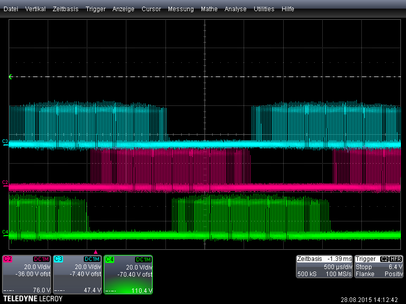

    I had a colleague take a screenshot of the phase voltages (see attached - blue red and green are U, V and W phase voltages measured with reference to ground of the motor), but he had trouble measuring the phase currents. What do you suggest for a good phase current measurement setup without a dedicated current probe?

  • Hi Sebastian,
    A common practice other than current probes is shunt resistor and differential opamp. Current can be measured by connecting low value resistance (typical mΩ) in series with motor phase and then measuring differential voltage using differential amplifier across resistance.
    Capturing phase current, bus current and phase voltage on single plot will be useful here.
    I see one issue with motor is that it’s electrical time constant (L/R) is very less (~52 µSec). Recommended electrical time constant for DRV10983 is greater than 100 µSec. Built in back emf observer might have some phase lag in estimating zero crossing and hence more current consumption because of lower electrical time constant.
