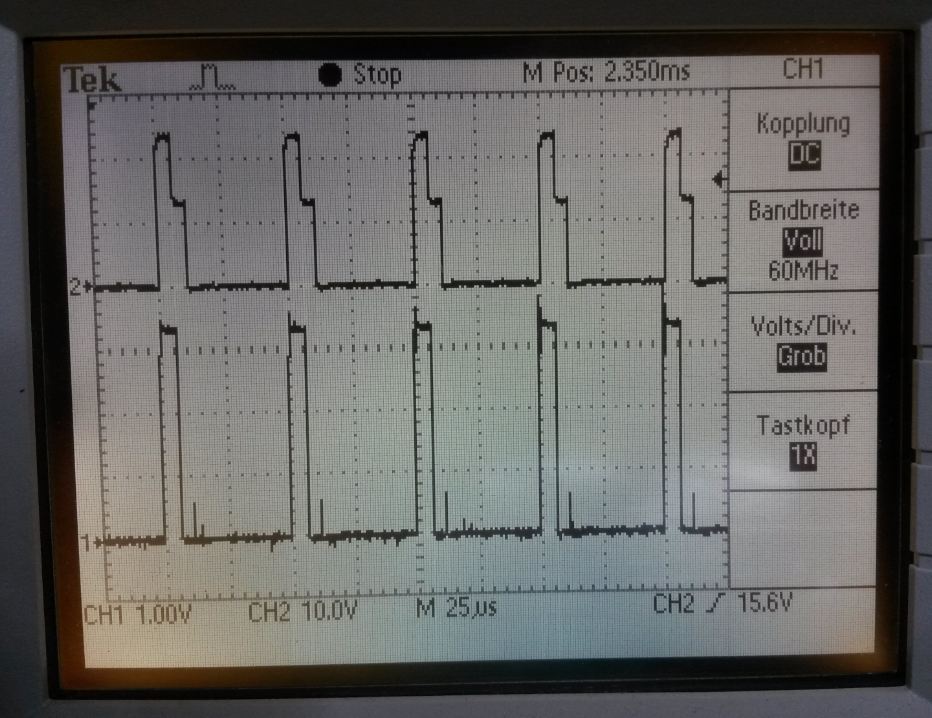

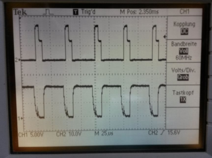

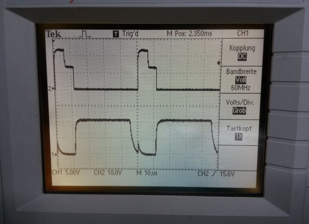

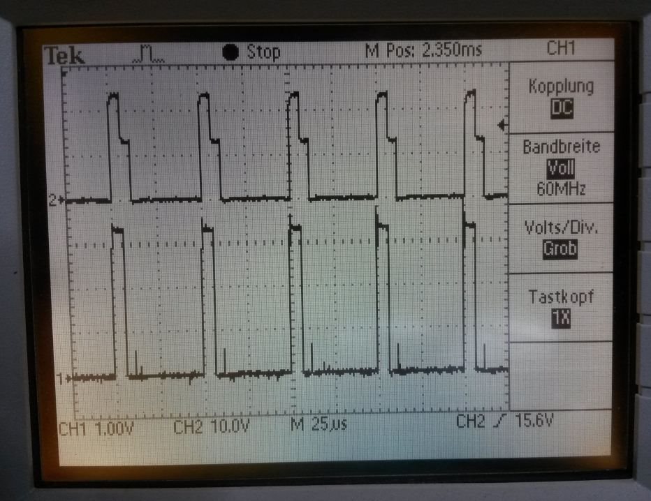

When I set EN_GATE to HIGH there is no output at the gate-side. There is also some cheeping noise to hear. After a few seconds the DRV stops doing that and I have to set EN_GATE first to LOW that to HIGH to repeat that.
While this few seconds the FAULT asserts to LOW but makes every 1,6ms a spike to HIGH. While this time GVDD is about 11V and DVDD about 3v3, but just while this noise. After that it goes to LOW.
Power supply on PVDD1 looks okay on the scope.
I have also tried to set OC_ADJ to 3v3 to disable the overcurrent control, without success.

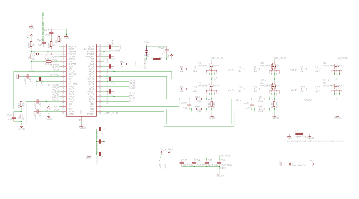

I have added my schematic diagramm. As you can see I have changed it a little bit. SN2 and SP2 are connected to the SL_C and PGND and not as in the datasheet to SL_B and PGND. Is that the problem?
(If you wonder, I have labeled PGND as GNDIO)
