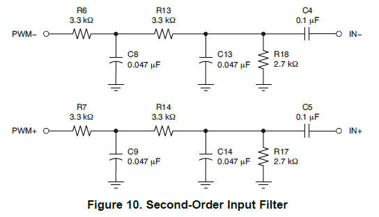

May I know what's DRV8662 filter formula for first-order & Second-order schematic design as below?
Thanks.
