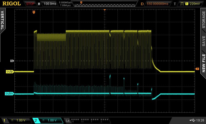

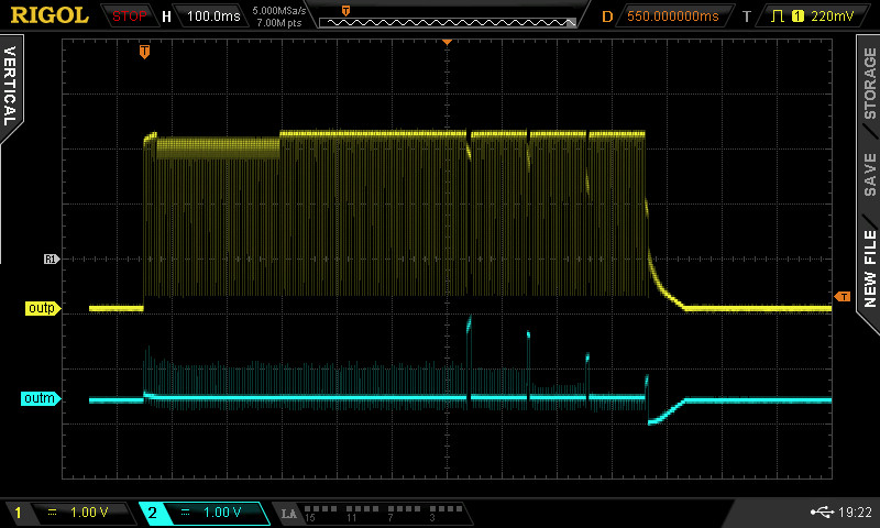

  • Karl,
    On ERM #1, could you please provide a complete register dump of all the registers?
    Any oscilloscope captures of the AutoCAL will help. From what I can tell, it looks like the Back Emf is too high.
    On ERM#2 the DCResistance is too low. We require at least 8ohm load for operation.

  • I've included 5 register dumps. A power on reset dump, a pre calibration at 0x16 set to 141 with corresponding post calibration and scope capture, and a pre/post calibration at 0x16 set to 129 with corresponding scope capture.
    Understood, regarding the second ERM.
