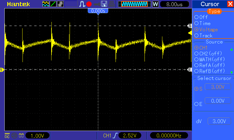

I made a circuit that moves a 24V 3A DC Motor with a DRV8801 motor Driver. I have the sense output connected directly to ground. A microcontroller ramps up a 31KHz PWM on the Enable Pin (To limit the startup current of the motor). If it detects an Fault signal, the PWM is started at 0 and ramped up again. The IC is making overcurrent faults when the current is <2A. I attached an 1 Ohm resistor before the motor and measured the current with an oscilloscope. The cursors are located at 3V, showing the 3A theoretical minimum peak current limit of the DRV8801, where I am expecting the OCP to trigger.
After the fault is detected, the motor stalls and the current is increased again because of the pwm ramp up. The voltage on the resistor looks much more noisy when I am driving the motor with the H-Bridge than when I drive it with a DC source. This is the graph of the motor being drived by the H Bridge:

  • Sorry, the images were not uploaded. Here is the graph showing a fault using the driver:

    Here is a graph of the Fault. As far as I can see, the current does not reach 3A. I don't think it is a thermal shutdown, because the driver instantly continues its operation (much lower start current due to PWM ramp up).. Do you have any other ideas what the problem can be? I switched to fast decay mode, but it makes no difference. Thank you and have a nice weekend!
  • Hello Forum,

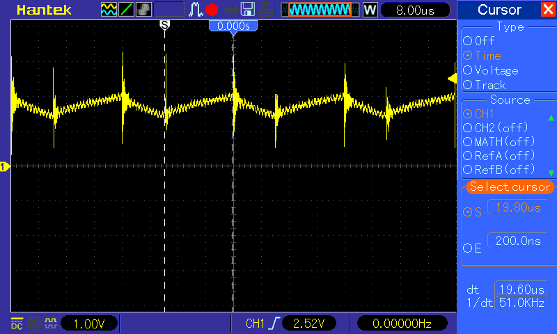

    I noticed one more thing: Before the Fault, the current goes up and down, partially exceeding the 3A limit:
    The Frequency of the rising Current (~51KHz):
    Frequency of falling current (~83KHz):
