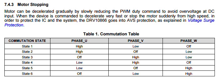

Hi
My customer is using DRV10866
Could you let me know the method of BEMF detection, please?
-> Compare voltage of COM pin and shut-off phase pin(W or U or V)?
Shimizu
