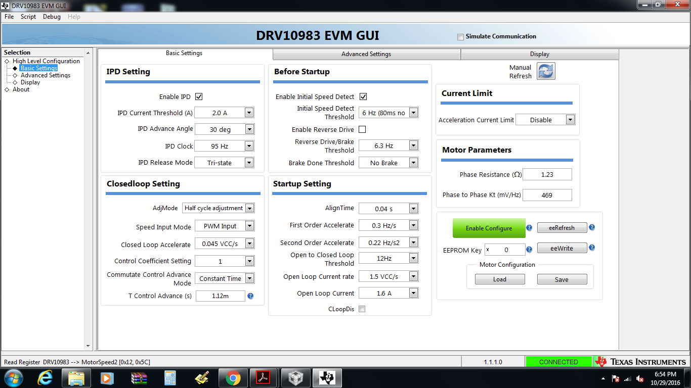

First of all I'm using sensorless BLDC motor and manufacturer datasheets says that it has 3 phases, 4 magnet poles and with 8V supply it's maximum speed is 15,000 rpm. It's resistance phase to phase is 1.61 ohms and BEMF constant 30mV/Hz.

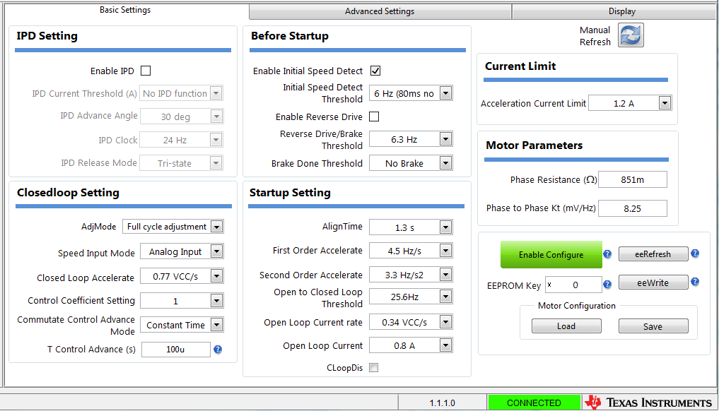

While using DRV10983EVM GUI I achieved best performance (highest start up success rate) with phase resistance = 1ohm and Kt = 6.42mv/Hz, instead of calculated phase resistance = 0.8ohm (delta design) and Kt = 8mV/Hz.

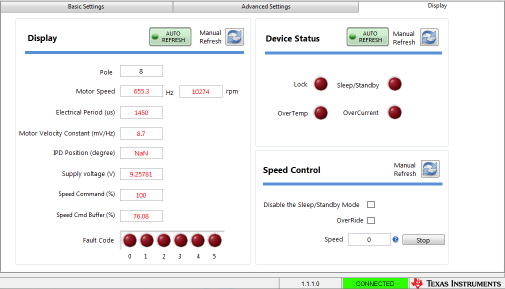

I achieved almost 100% success rate of start ups and I'm able to control speed up to 10,000 rpm and this is the point where I hit the wall. I can't speed up more. GUI shows that motor is spining with 655 Hz so it's far from driver limit. Also sometimes overcurrent fault appears even when supply shows 0.5A of current consumption and current limit set to 1.2A. Do you have any advices how to solve this problem?

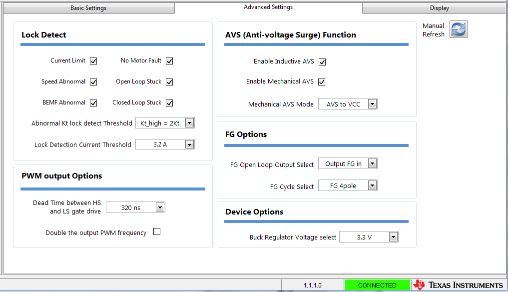

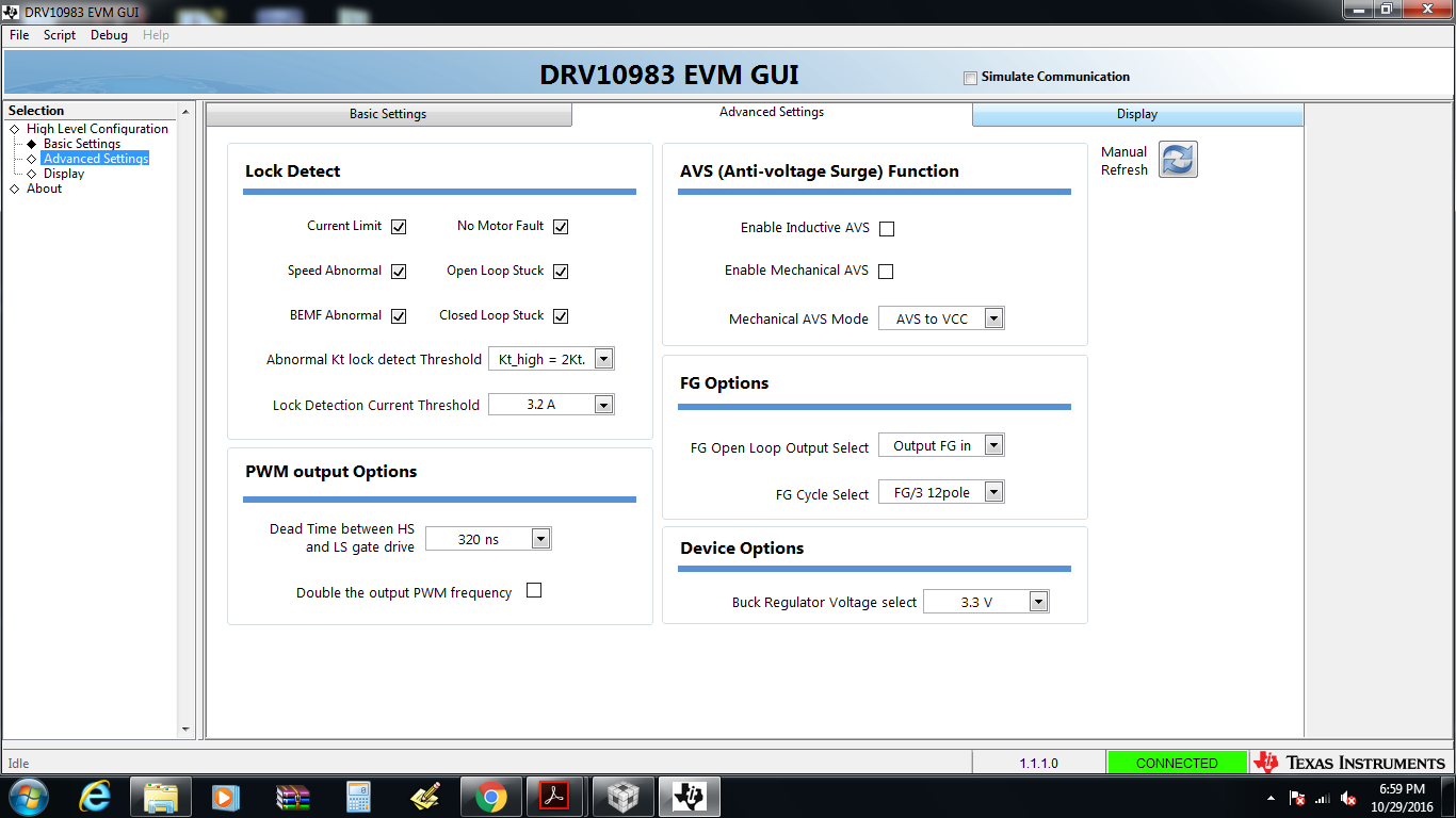

    Are you referring to lock detection current threshold or over current protection? Over current protection triggers when winding current gets bigger than 3.5A.
    Th lock detection current treshhold is programmable through GUI under advance setting -lock detect section.
    I would recommend you to raise lock detection threshold and see whether it solves the issue.

  • Hi Seil,
    setting Lock Detection Current Threshold to 3.2A  helps with OverCurrent faults, but it haven't help with breaking 10,000rpm speed barrier.

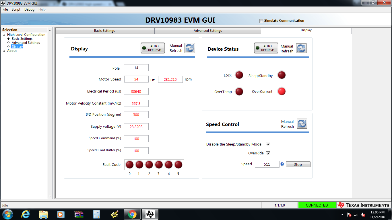

    Below are screens with parameters I'm using and display at maximum speed.
  • Hi Jakub,
    Two things I can see from "Display" tab is that yous supply voltage is only 9.25V. CAn you check your supply current rating and make sure they are not coming down to 9.25V.
    Your input command is 100% but device is only applying 76.08%. Can you increase the acceleration current limit? It will limit the PWM input.
    Seil

  • Hi Jakub,
    Uncheck 'Enable Inductive AVS' and 'Enable Mechanical AVS' box on Advanced setting page to resolve problem of acceleration at lower speed command value
    What happens when you increase acceleration current limit?  Can you share phase current plots during fault condition. Are you seeing any fault LED turn ON?
    Startup can be improved by tuning Startup Setting, try reducing 'First Order Accelerate' and 'Second Order Accelerate'. After that try tuning 'Open to Close loop Threshold'

  • Hi Vijay,
    Can you please provide phase current waveforms and can try changing following couple of setting
    - 'Acceleration current limit' -  can you change it some number instead of disable on basic setting page. DRV10983 doesn't have current loop, it uses parameters like 'Acceleration Current limit', motor resistance, Motor Kt, commanded duty cycle/speed to calculate the applied voltage, so device cannot limit itself in terms of current, it can only control applied voltage.
    - Check box ' Double the output PWM frequency' on Advanced setting page, sometimes higher frequency can provide better control.

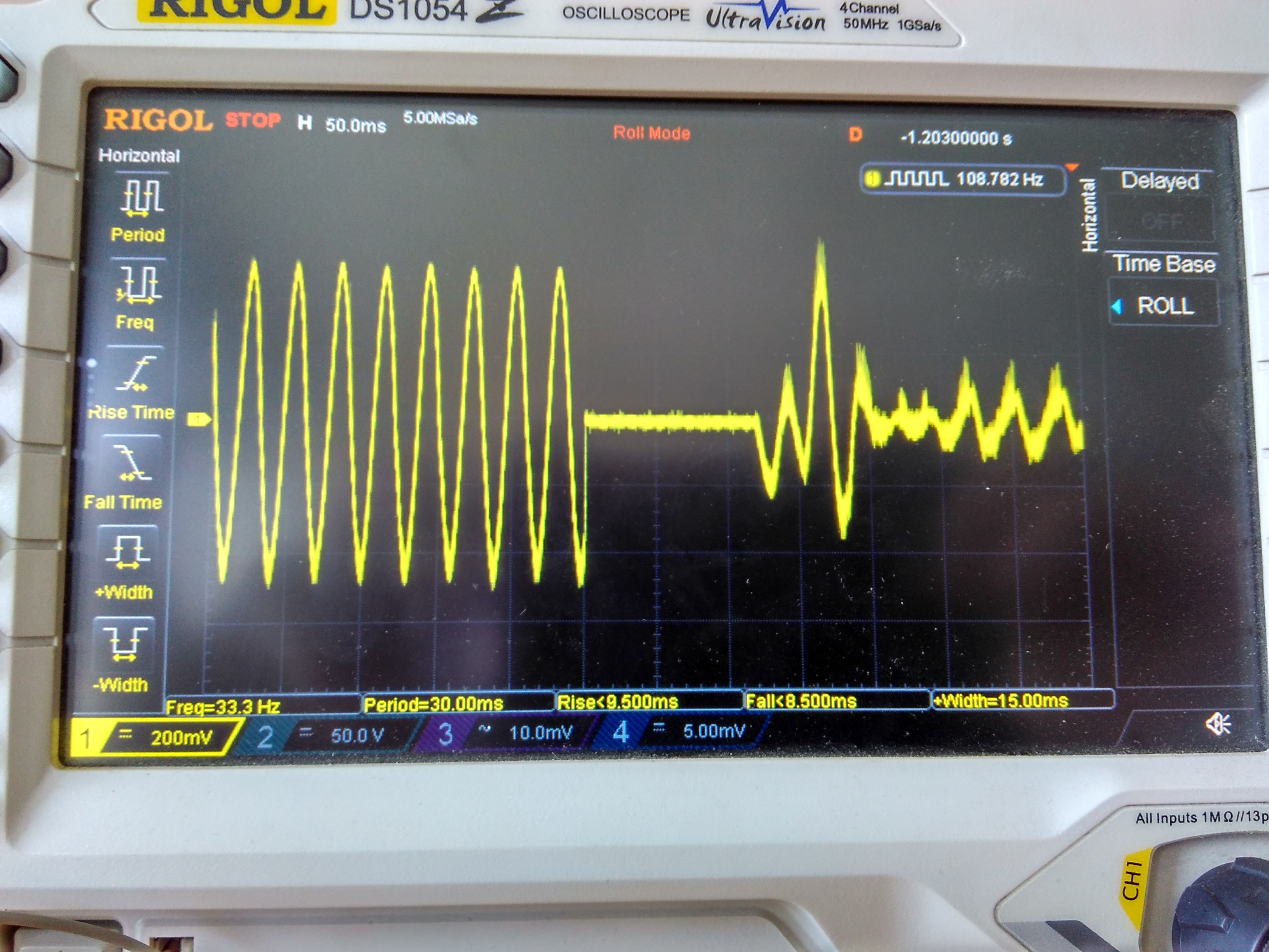

  • Hello sir,
     I have tried with
    1> Acceleration limit setting to 3A-->i got peak performance of motor gets reduced which is not feasible as per application requirement
    2>Double output PWM frequency check-->same overcurrent problem faced and started restarting as before.
    Here i have shared with you current waveform at the time of overcurrent error:

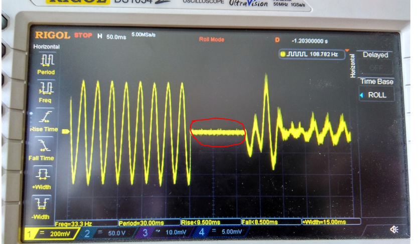

  • Hi Vijay,
    It looks like driver stop driving during the interval highlighted below, did you command zero speed ?
    What is scaling for current waveform ?
    Can you set acceleration limit to 3 A and increase value of programmed phase to phase Kt slowly until you achieve maximum speed. What other performance are you not able to meet when you set current limit to 3 A ?
