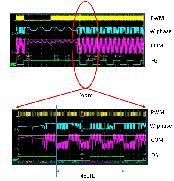

My customer is using DRV10866.
Could you let me know Open loop jump speed, please?

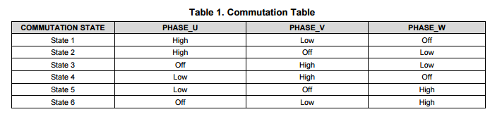

At 7.4.1 Start-up in datasheet Page 9, there is the following wording.
"When this occurs, device commutation logic jumps over the open-loop start-up process and goes to closed loop directly."
I would like to know minimum motor speed to enter closed loop directly.
