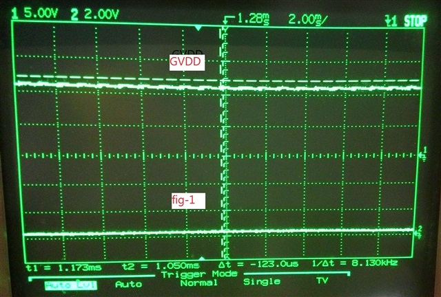

hi, I am doing a BLDC motor driver design using DRV8301, and my circuit is similar to Boostxl-drv8301 kit except the FET used. Here is schematic and PCB file:
Cadstar-drv8301.pdf
https://e2e.ti.com/cfs-file/__key/communityserver-discussions-components-files/38/stpmtc001v03_2D00_gerber_2D00_150910.7z

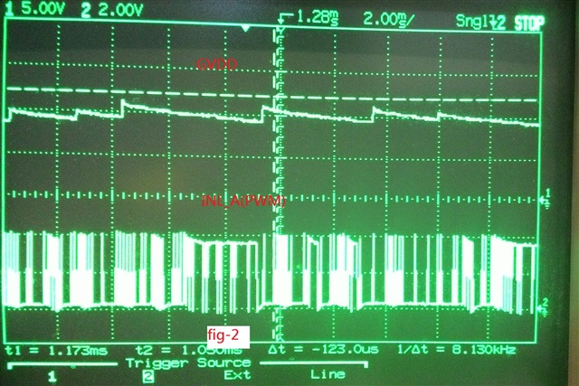

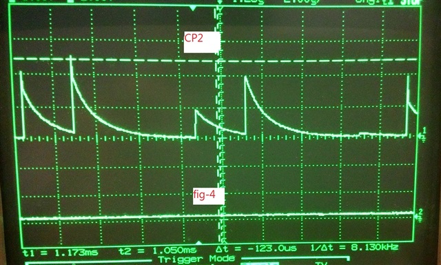

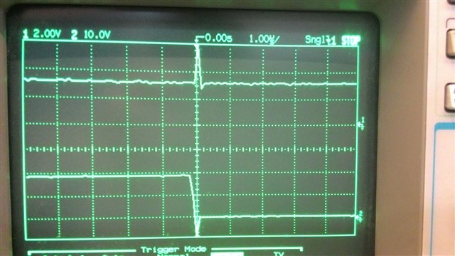

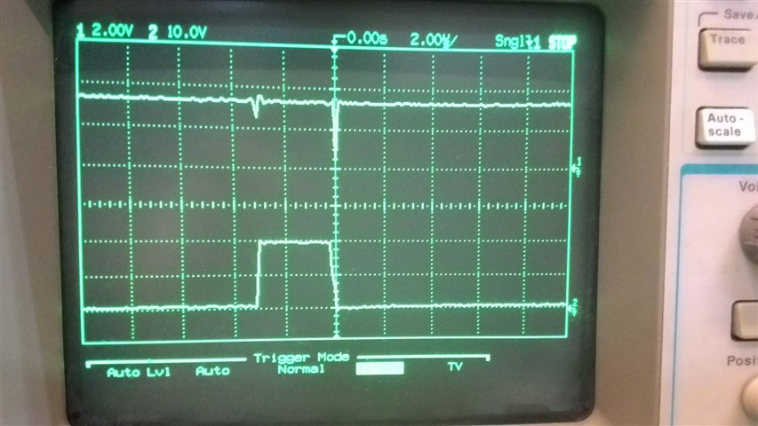

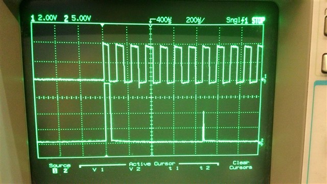

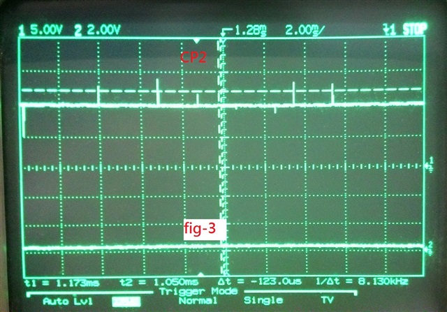

But when I use TMS320f287 to control it, the gate driver signals did work properly. And I have compared to the proper worked kit, I think it's caused by charge pump problems. The charge pump and the GVDD wave form is below:
The above wave form are taken from the Drv8301 GVDD, CP2, INL_A(PWM) pins. Before the PWM signal enables, the VGDD is about 8V, and CP2 is biased at GVDD with some pulse as in fig-1, fig-3. And when PWN is enabled, the GVDD has a lot noise as in fig-2, and the CP2 can not be biased at GVDD as I compared to the working Boostxl-drv8301 demo kit.
I thoght it was caused by the PWM frequency and high Qg of FETs, I have lower down the PWM frequency to 8Khz and use the low Qg EKI06108(Gg 36nC, ).
But the gate driver signals still is not working. We have made several boards, some boards can work good but for just a few seconds then the waveform is bad again.  Is there any suggestions?

  • I have tried the enlarge the Cap at CP2 from 0.022u to 2.2u, the voltage on CP2 is increase to be bias at 5V but still not as high as those working one. The working Drv8301 the CP2 is bias at about GVDD level. The bypass at GVDD is enlarge also, the ripple on GVDD is improved but the gate driving signals are still not working. I have set break point is software the any error flags set in Status1 will be stopped, but the Status1 does not report any error!

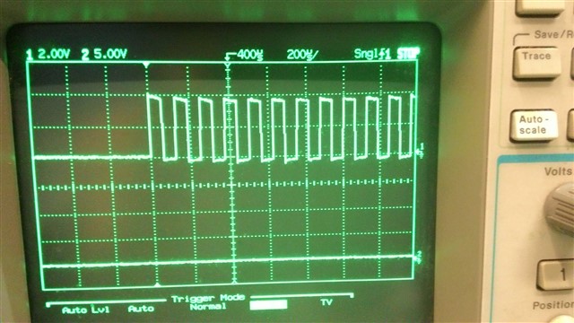

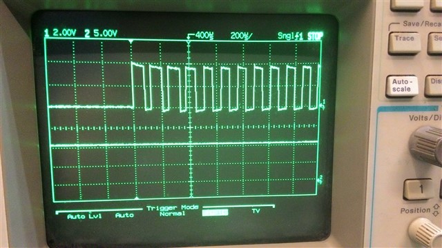

    These values all seem nominal. Can you now try and toggle one of the phases with no load connected and capture the waveforms (SH_A, GH_A, GL_A, GVDD).
    Trigger on the first rise and falling edge of the phase. We want to see the first transistions.
  • PWM_AH vs SH_A:
    pwm_ah vs gah,gal:
    pwm_al vs gal:
    pwm_al vs gvdd:
    It seems the only the first rising edges are good

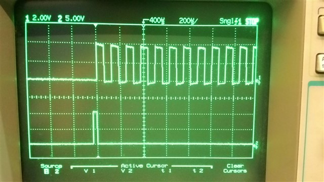

  • Here are two more wave form from ENGATE, GAH:
    The spike on ENGATE is so high that the TMS320F287 will lost control by ICE when PWM out out is enabled by setting run at GUI Composer. The spike does not come from coupled parallel signal. I have tried the cut out the trace of ENGATE from TMS320F287 and connected it direct to 3.3V, but no good. Add a 33u cap to ENGATE will help, the GAH output wave form's good working period is prolonged but still not completely OK.
    After I cut trace from TMS320f287 and jump a wire to 3.3V, the pin on ENGATE still has spikes:
    What might cause it to behave so? Is the improper DRV8301 layout will cause such big spike?

  • Moving from 20-30 nC to 30-40 nC should not be an issue. Layout will have a significant effect on the performance of a switching power design. Can you try reducing the gate drive current? This will reduce the slew rate of the MOSFETs.
    Can you verify that none of the external MOSFETs are damaged or a short? Oftentimes when only a short spike is seen this points to an OC event.
    If the DRV8301 has been damaged by a high voltage transient it will need to be replaced.
