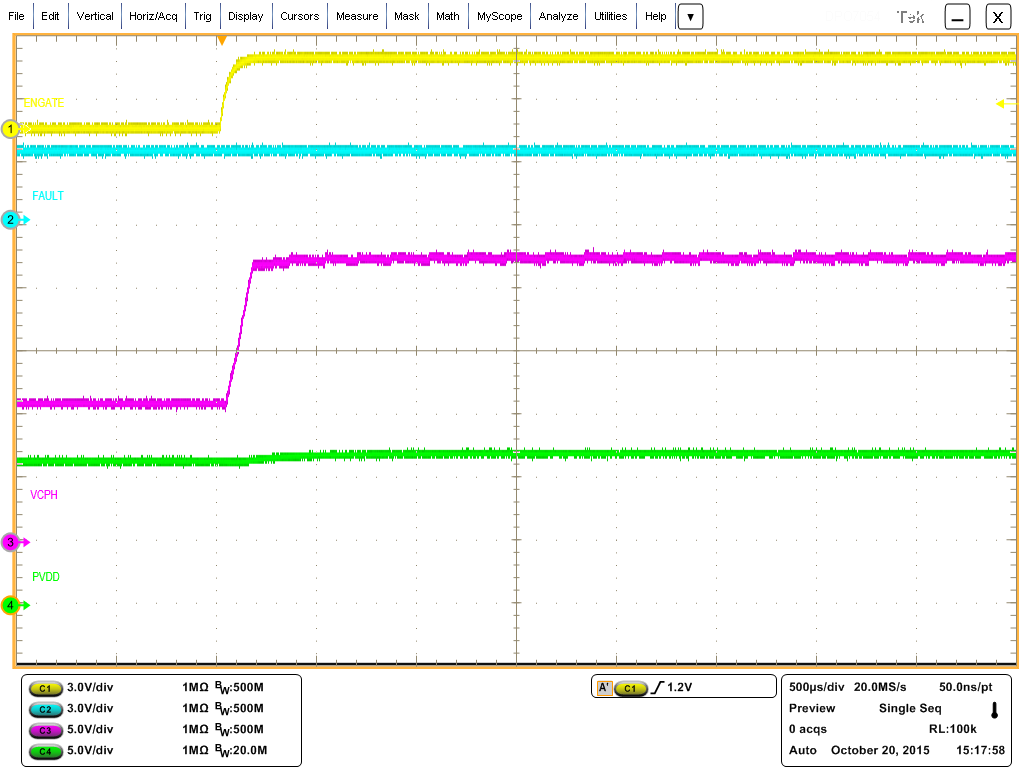

    Can you get a scope capture of the EN_GATE pin and VCPH pin when you enabled the DRV8305 (can trigger on EN_GATE rising). Preferably at ~500us timescale.

    Below is a waveform taken on our EVM board showing a normal gate drive power up sequence EN_GATe LOW to HIGH. You can see VCPH rising and FAULT does not ever assert. I do not see any warnings either.
    Can you try and get a similar waveform with EN_GATE, FAULT, VCPH, and PVDD. Have you tested this behavior on multiple PCBs? Is it similar on them all.
