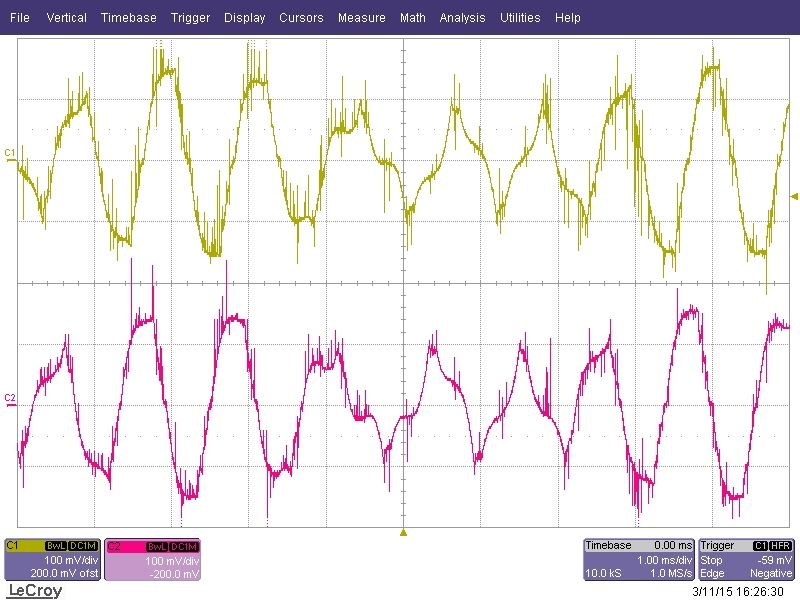

    See scope trace below for odd current wave form. As you can see the wave form isn't a constant shape. It seems to flicker between two forms before the motor desinks.

  • Hi Nick,
    Thank you for the information. Can you clarify which of the three models is being used in the scope captures? If the 0100 or 0300, how are the A/A' leads connected (series or parallel)? What is the VM voltage?
    Automixed decay will restart the chopping cycle when a step pulse is received. Please refer to the first paragraph after Figure 10 in the datasheet for more information.
    It appears you may be outrunning the ability of the system to inject or remove current into the winding. This has been observed at high microstepping rates with higher inductance motors and at lower voltage.
    This is based on the following assumptions:
    At 1/16 microstepping, it appears a step pulse is issued every 18us.
    So the DRV8711 indexer table may be lagging in the current regulation.
    Please try the following:
    1) Change to 1/8 or 1/4 usteps and reduce the number of steps per second by half or 1/4, respectively? Lowering the steps/second allows more time for the current level to be reached. Does performance get better?
    2) If the voltage is low (12V to 15V), can you raise the voltage to 24 to 36V? Raising the voltage improves the ability to inject or remove current from the winding.
  • Hi Rick,
    Sorry, The motor in this scope trace is the 0300 wired in parallel. The VM is 31V there but I have experimented up to 48V already and it seems to allow me to pass though the trouble point at that speed but the problem becomes present again at a higher speed (I'm guessing the next harmonic of resonance for that motor?? or it just shifts the resonance to a higher frequency).
    Thanks for pointing me to the location in the data sheet where it states that auto mixed decay starts a new chopping cycle when it receives a new step input signal. Thought I was going mad!
    What you are telling me seems to be matching up exactly with what I have found out through experimentation already. This effect is reduced greatly, but not eliminated, by running in half stepping (or a lower microstep setting as you suggest). Increasing the voltage to a point allows us to pass this band of resonance.
    Ideally we would want this motor to run up to 2000 rpm at 1/16 microstepping and 36v like the other motors we use as specified by our customer.
    Nick
