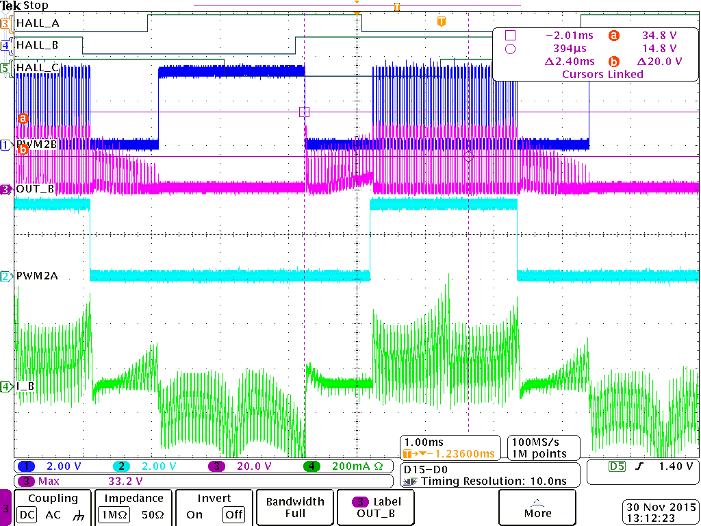

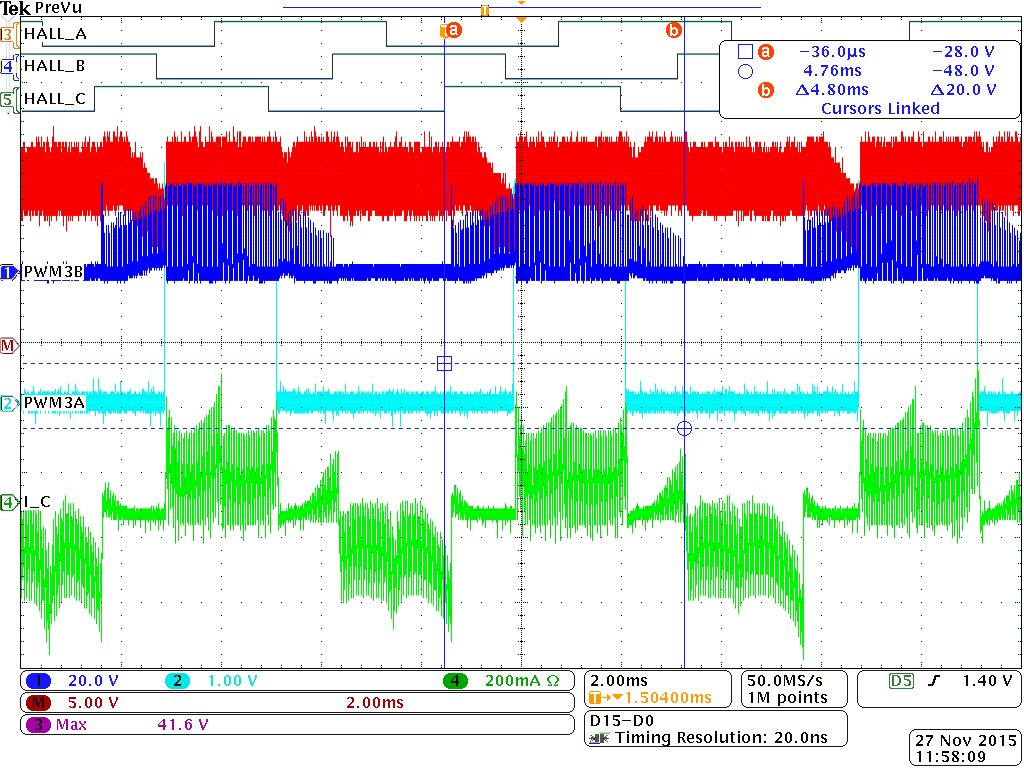

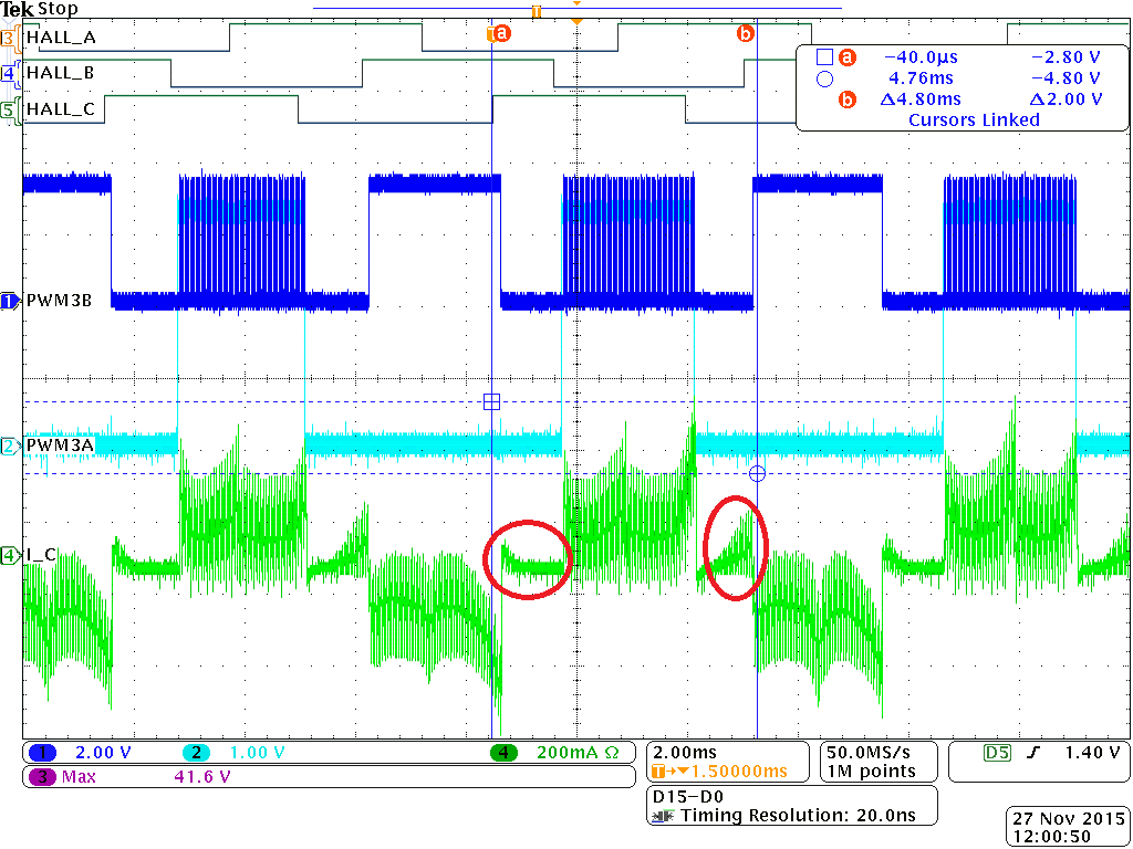

I have DRV8312-C2 kit. Using BLDC_GUI code, i get this current waveform for both the sensored and sensorless options.
Any idea, why current still flows on the red circled areas? Technically, at those instances, the current should flow on the high and low side FET (i.e. high-impedance state). Hence, in those areas, it should just be a flat 0 A level. The green curve is the current measured on phase C of the motor that came with the kit.
Any ideas?
  • Could you also give the phase node voltage waveform? Is above sensored or sensorless?
  • Hi Wilson,
    I see the same curve for both sensored or sensorless.
    The dark blue curve labeled PWM3B is actually the phase node voltage and PWM3A is PWM3 of the motor driver DRV8312.
  • It is possible that some of the recirculation current during PWM off may take the path of the third high Z phase body diodes. Could you check a state in 100% duty cycle running, to see whether there is still the current in HiZ phase?

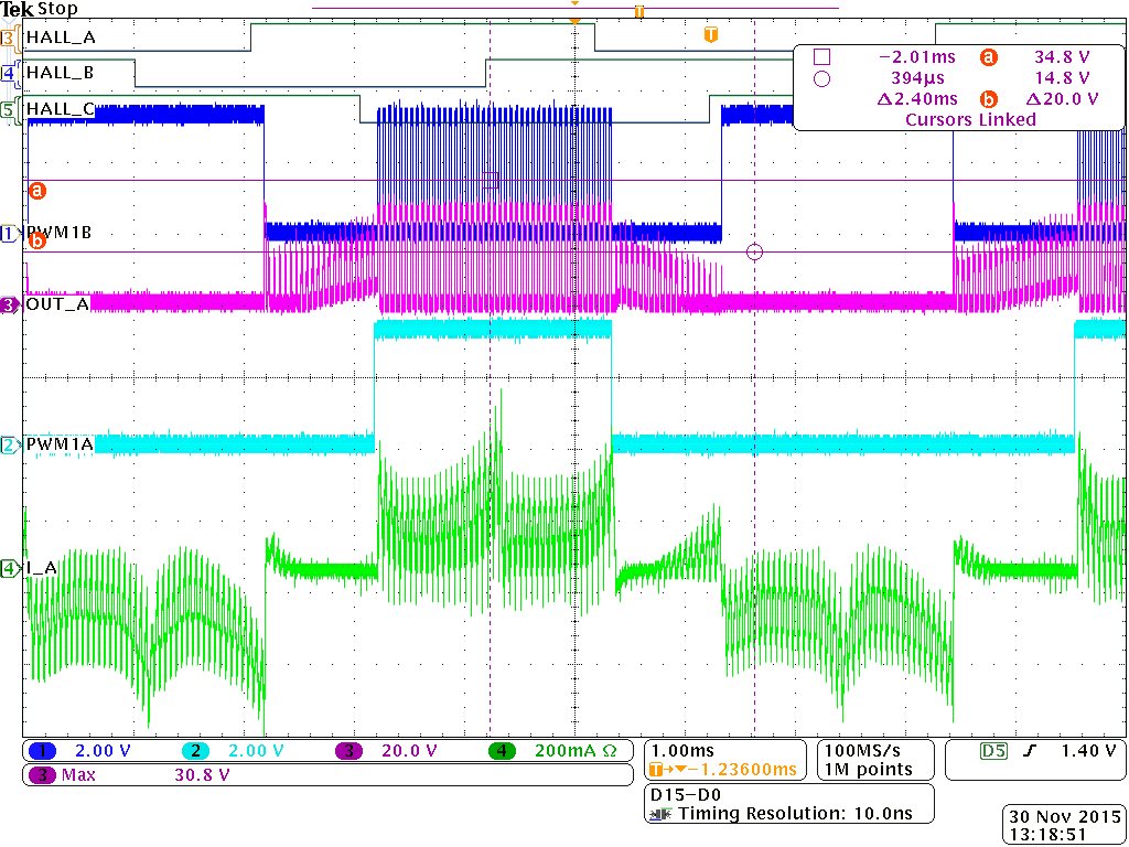

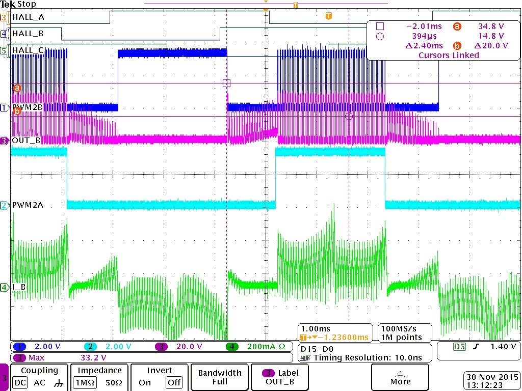

  • Here are the waveforms for the 2 other phases:
    By Vm you simply mean the phase voltage, right?

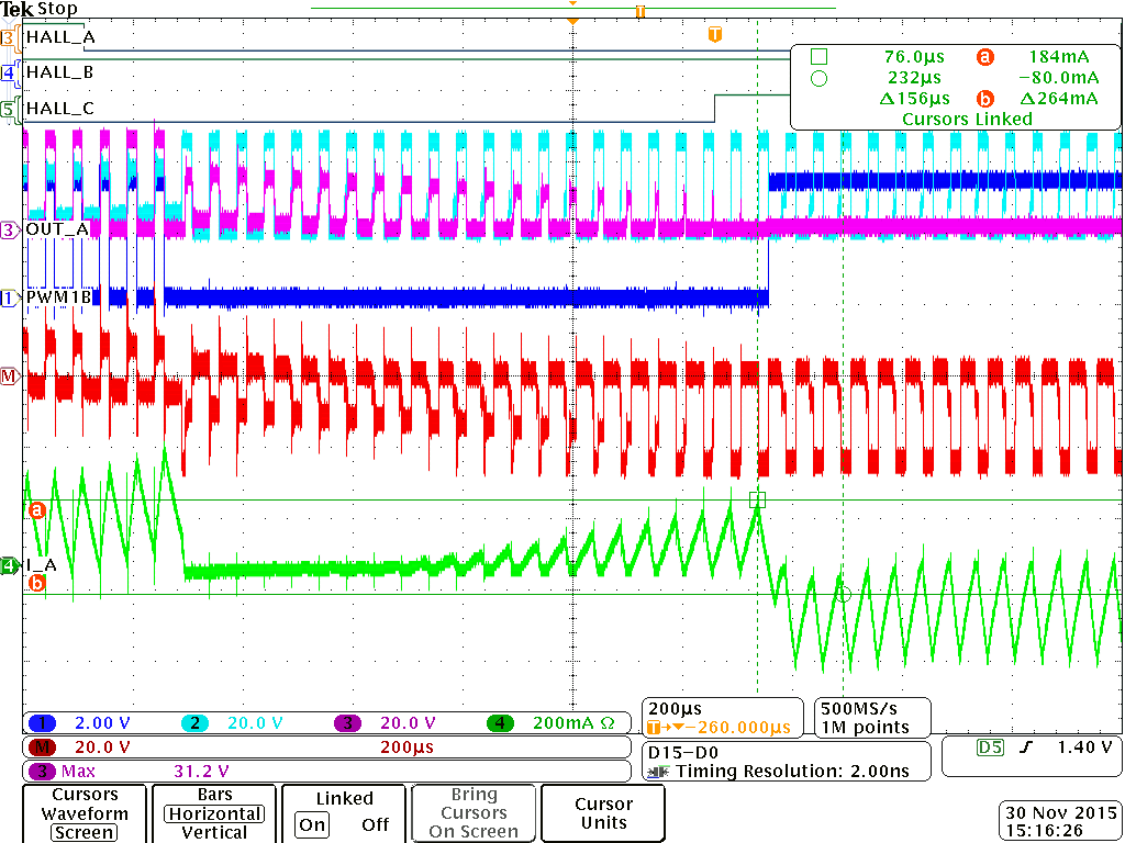

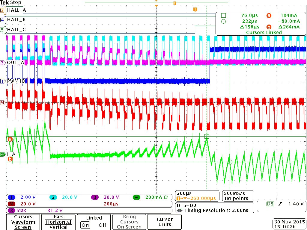

  • Hi Wilson,
    Maybe I am missing something. But i just don't see the whole point of either CBC or latching shutdown would matter. The ODC_Adjust resistor on the board is 30kohm setting the max current threshold to 8.8A.
    Question about ODC_Adjust resistor, what is the minimum current threshold that can be set? Table 2 states 200 kohm value for 1.4A.
    The motor coil resistance is measured to be about 1.8 ohms.

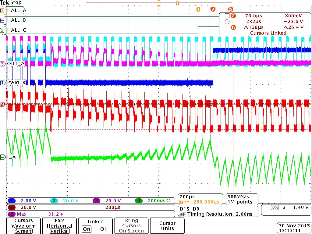

    The Math Function for the oscilloscope plot below is OUT_A - OUT_B. This value is 800mV (at the current overshoot of the supposed 0 Ampere level current).
    The current at this point is 184 mA (see plot below).
    So 800mV / 1.8 ohm = 444.4 mA which is way above than the measured value of 184 mA.
    Hope you can shed light on this matter.
