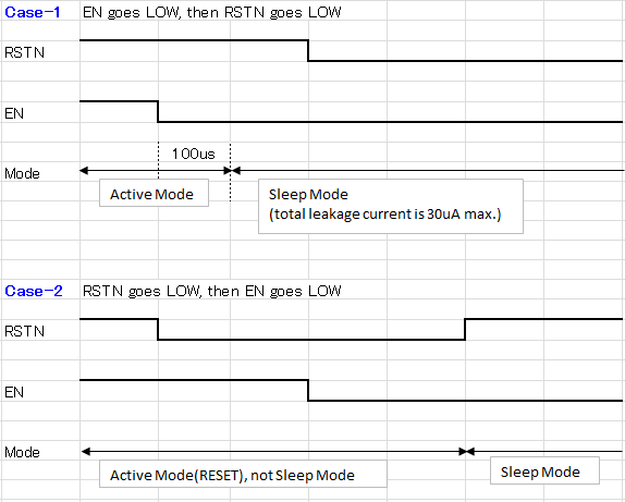

Please confirm my understandings of Mode behavior is correct or not for Case-1 and Case-2.
Best Regards.
Best Regards.
Hi Ushikubo-san,
Your understanding in both cases is correct.
