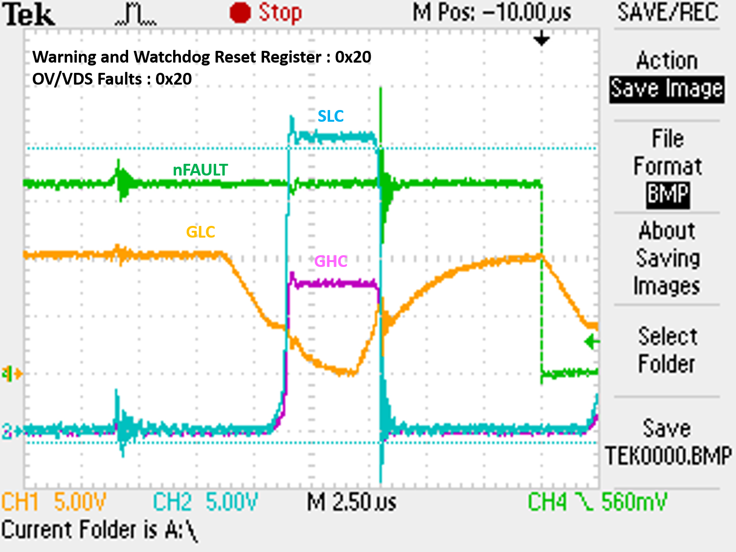

  • Additional information
    sometimes, "Warning and Watchdog Reset Register : 0x20 and OV/VDS Faults : 0x20" occurs.
    The following waveform was captured when "Warning and Watchdog Reset Register : 0x20 and OV/VDS Faults : 0x20" occurred.
    (Additional question) Could you tell me why OV/VDS faults occurred if you can know from this waveform.
    Also, The following waveform was captured when "Warning and Watchdog Reset Register : 0x20 and OV/VDS Faults : 0x00" occurred.
    I'm not sure that the waveform is useful for understand why OV/VDS Faults shows 0x00 because other channel waveform(A and B) isn't captured.
    Thank you in advance,
    Shirai
