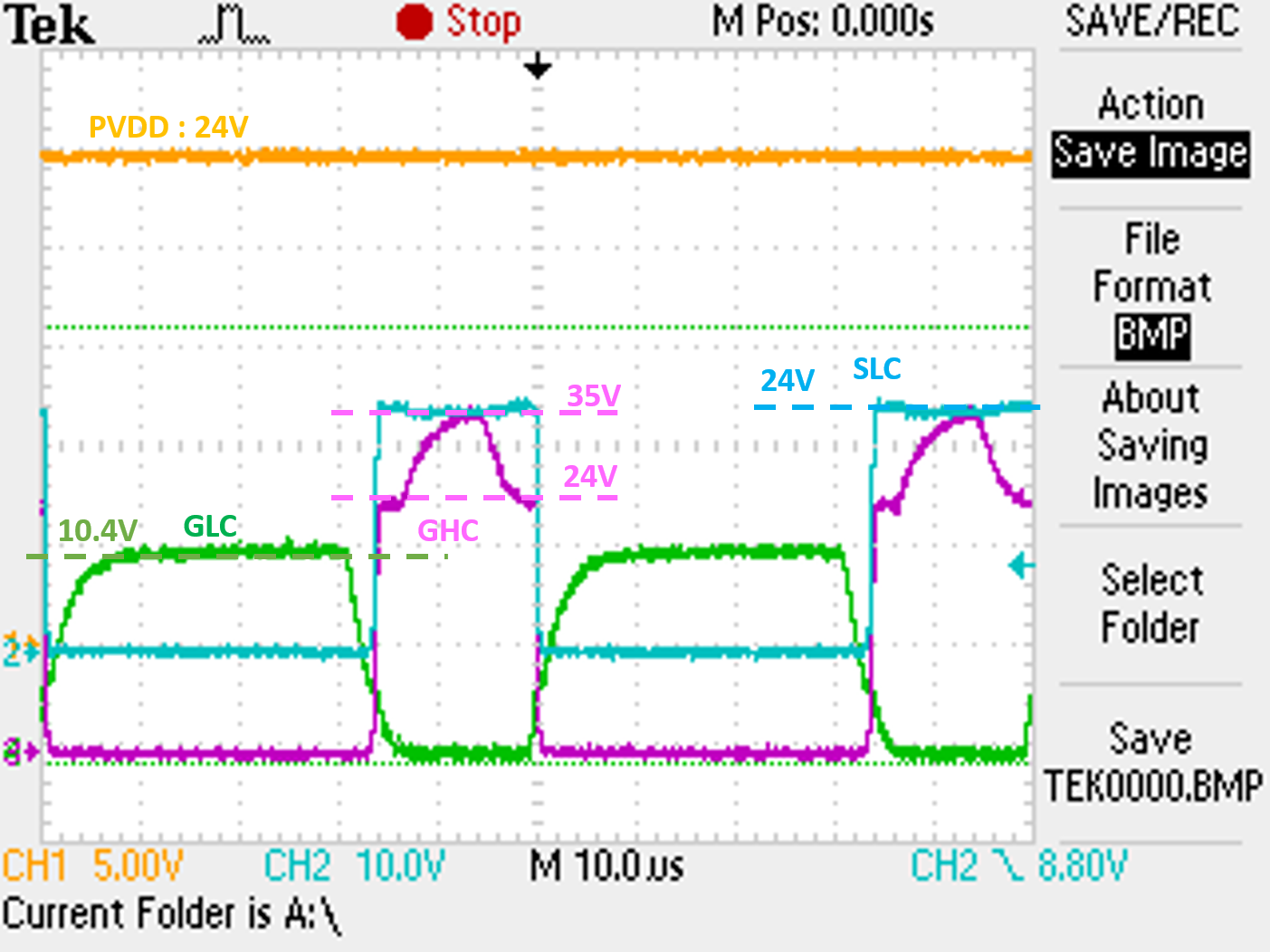

I use DRV8305 to control brush-less motor.
The attachment is the waveform of PVDD, V at SLC, V at GHC, V at GLC of DRV8305 when DRV8305 controls a brush-less motor (rotation speed is 1200rpm).
VGHC (voltage at GHC) looks very high and has two steps(24V/35V), but VGCH must be less than 10.5V accroding to datasheet.
Could you tell me why my PCB has such a problem? What parameters shold I adjust.

    Vgs appears to be correct. The voltage is the gate voltage - the source voltage, which is about 11V in your scope capture.
    Two steps is also normal. When turning off the low side, the phase voltage can increase to approximately PVDD. This will cause the gate of the high side to rise to PVDD until the high side is turned on. Once turned on, the gate voltage (Vgs) should be typically 10V above the SHx (source) voltage.
