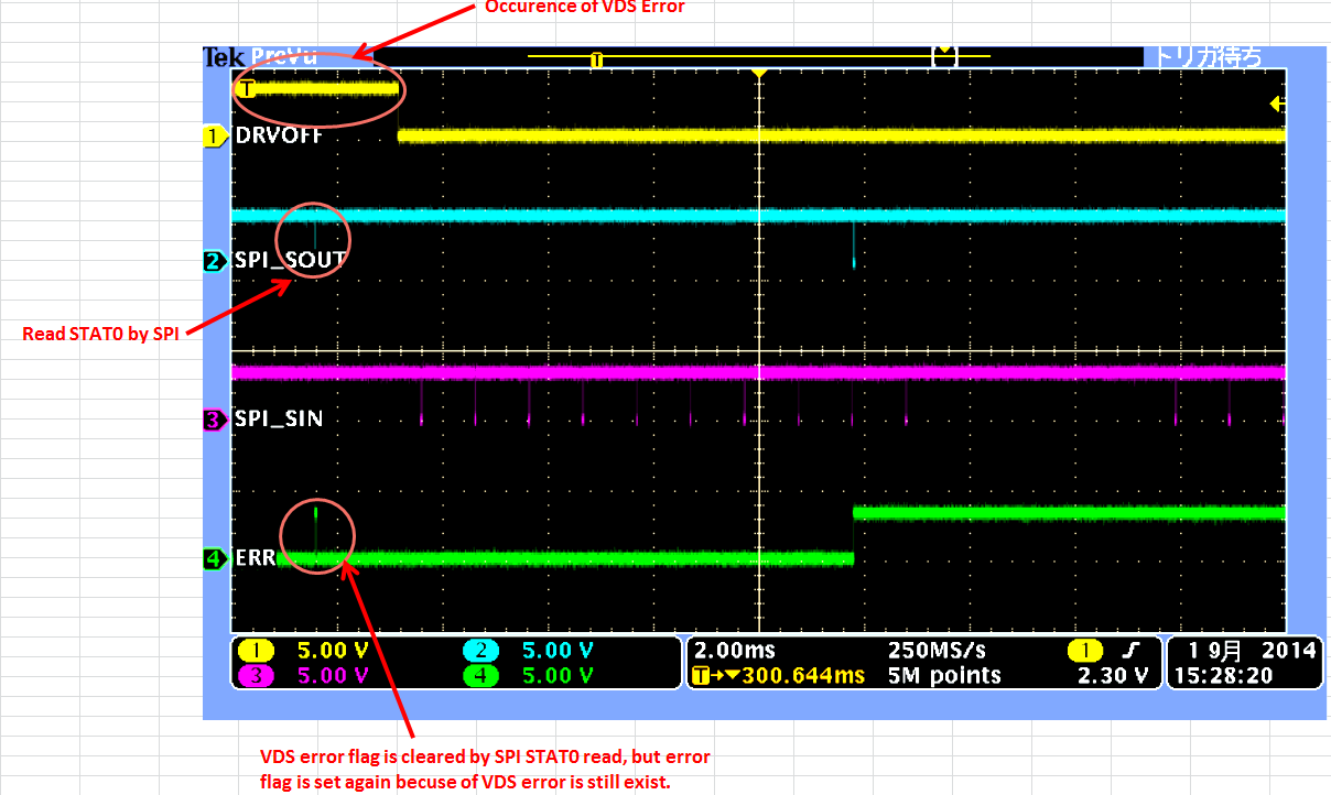

DRV3201-Q1 ERR signal and SPI STAT register read (A-67)
Please answer following question from customer.
ERR terminal goes high shortly when STAT0 is read by SPI in spite of VDS error is existing.
It can be understood because of error flag is cleared during short period of time.
Is Protective Action (Active Pull-down) cancelled during short period of time same with error flag(ERR terminal)?
