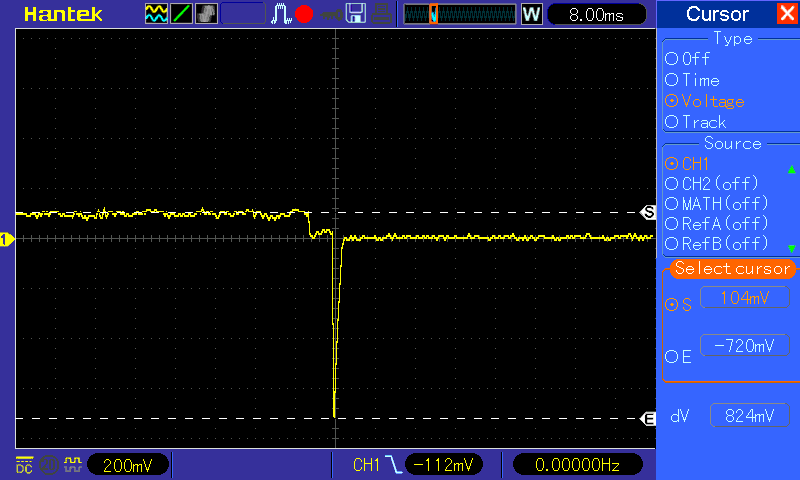

  • Hi Rick, thanks for the suggestions!
    I captured the current over the sense resistor: I measured 104mV while the motor is running (@ 0.15R) ~= 0,7A.
    The back emf produced a spike of 720mV ~= 4.8A at 0.15R. (Maybe to near to the 5A limit)
    I'll change the software to decrease current at the I4:0 pins before stopping to see if this reduces my back emf. I'll post results.

  • Hi Rick,
    I got rid of the OCP event!
    I stopped the motor with a 255-Step 31 KHz PWM, ramping it down from Full High (255) to 0 in 1ms steps, and the error does not happen anymore. I measured the current over the sense resistor (0.15 ohm) and got ~2.5A when stopping, which is OK for me.
    I'll try to reduce the Current with the I pins before stopping to see if this helps too and post my results.
    Here is the voltage over sense while stopping the motor with the PWM:
    Thanks a lot,
    Igor
