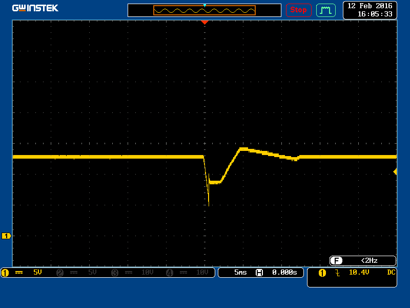

    If failing PVDD_UVLO2, this is usually an indication of lack of bulk capacitance in the system. Please monitor the PVDD voltage at the DRV8305 for droops when starting the motor.
    If drooping below 4.4V, please consider adding more bulk capacitance or increasing the power supply.
    What is the bulk capacitance and local PVDD bypass capacitance values? Please note section 9.1 for a generic guideline, and Figure 11 for a typical application showing almost 1mF of bulk plus several small bypass caps.
  • PVDD signal as shown capture. When start motor hapening short circuit and PVDD_UVLO2 fault.
    Bulk capacitance about 2000uF and power supply 8A. But when i use TIDA-00643, this board draw current 2-3A .
    If motor spin anywise, DRV8305 is burning.
