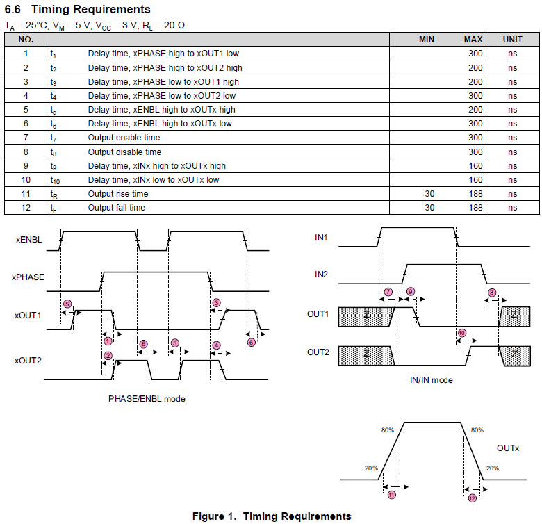

There isn't Timing Requirement for using PHASE/ENABLE interface in DRV8881E datasheet.
On the other hand, DRV8835 shows the following.
Is the Timing Requirement of DRV8881E same as DRV8835?

I understood the values of DRV8881E is the following.
- propagation delay: 450ns (TYP)
- output rise/fall time: 70ns (TYP)
