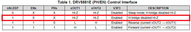

I would like to ask PHASE/ENABLE interface of DRV8881E.

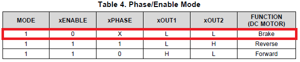

DRV8881E shows "H-bridge is disabled Hi-Z" when ENx is low.
On the other hand, DRV8835 shows "Brake(xOUT1=xOUT2=L)" when xENABLE is low.
Is seems DRV8881E doesn't have brake mode(xOUT1=L, xOUT2=L).
I wonder why there is difference although both devices have the same PHASE/ENABLE interface.
Could you tell me the background?

    I think there is no history between DRV8835 and DRV8881. Let me confirm if there is any design reason here. Anyway we need to choose using braking or HiZ only in EN PH interface.
    Some of our device will have different EN action based on decay setting.

  • Just to confirm Wilson's statements:
    The DRV8881E is intended primairly for stepper motor driving, so the ENABLE pin puts the H-bridge into a Hi-Z state. (Brake mode is more often used for brushed motors)
    As Wilson mentioned, DRV8881P with the PWM interface does support both brake and coast modes - this device is better for brushed-DC motor driving.
