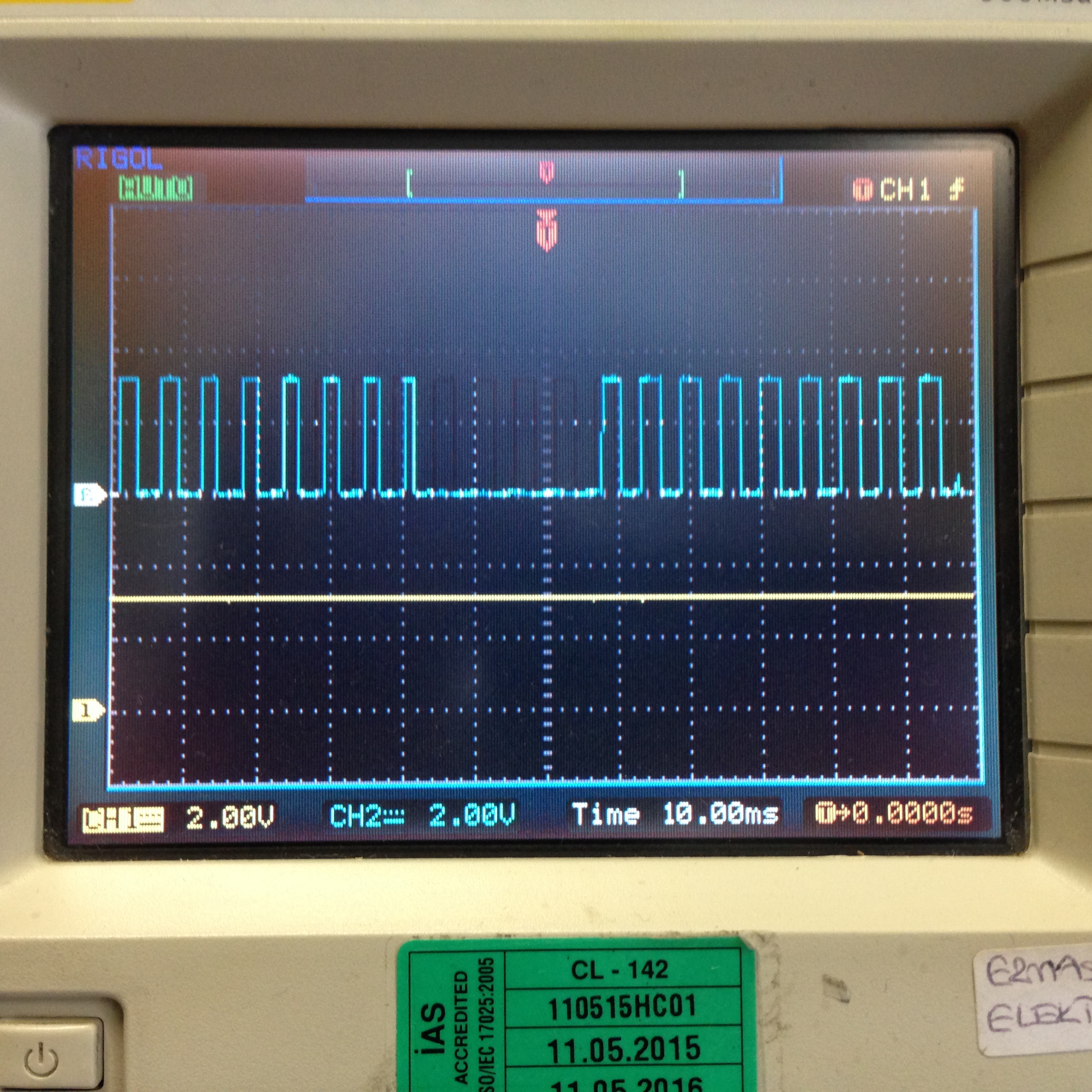

Hi everyone,
I am using a DRV8302 to drive a BLDC motor but DRV8302 Fault Pin always equal to zero. I share my drawing and measurement below;
I have run my circuit and  Code Composer program. while   EnableFlag=1, I have  observed the following values.
1) PVDD=25V
2) GVDD=11V
3) AVDD=7V
4) DVDD=3V
5) EN_GATE=3V
6) M_PWM=3.2V
 INL_A=3.2V PWM  (I saw with an oscilloscope)
 INL_B=3.2V PWM (I saw with an  oscilloscope)
 INL_C=3.2V PWM  (I saw with an oscilloscope)
 INH_A=3.2V PWM  (I saw with an oscilloscope)
 INH_B=3.2V PWM  (I saw with an oscilloscope)
 INH_C=3.2V PWM  (I saw with an oscilloscope)
BST_A=11V
BST_B=11V
BST_C=11V
BST_BK=25V PWM (I saw with oscilloscope)
GL_A=0V
GL_B=0V
GL_C=0V
GH_A=1V
GH_B=1V
GH_C=1V

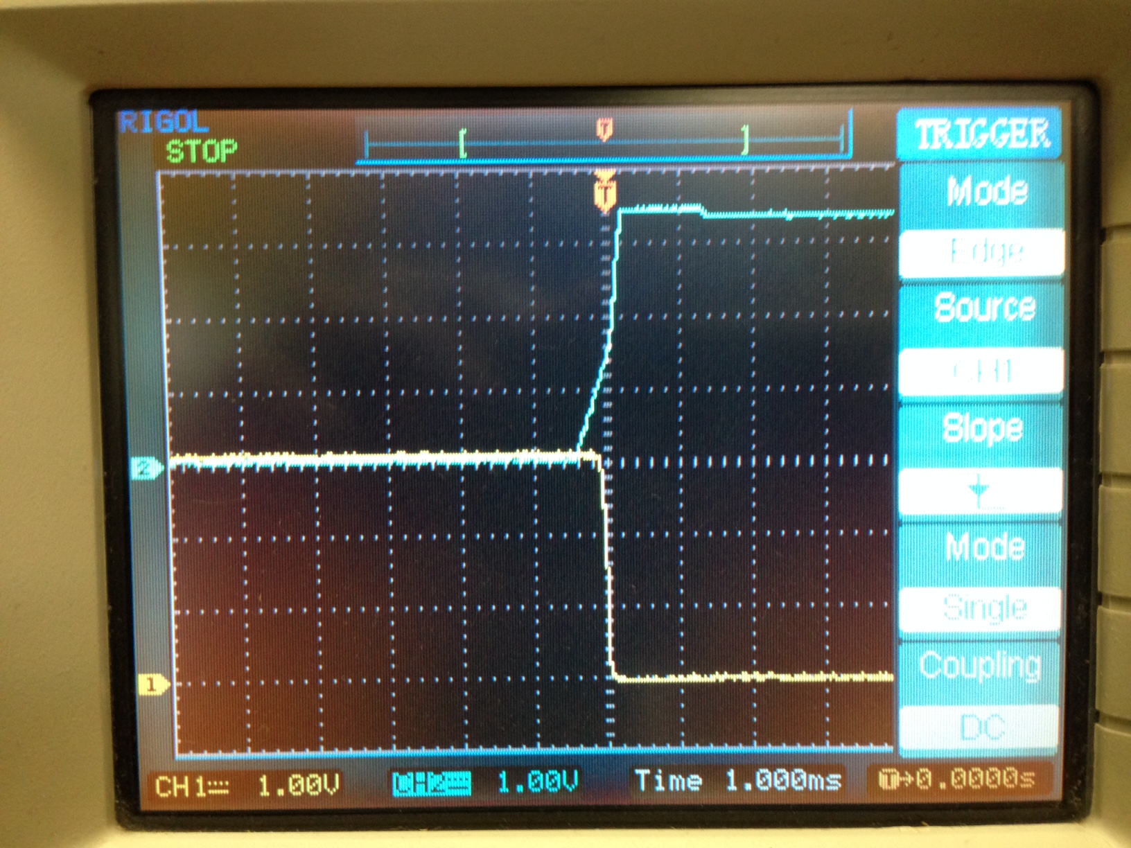

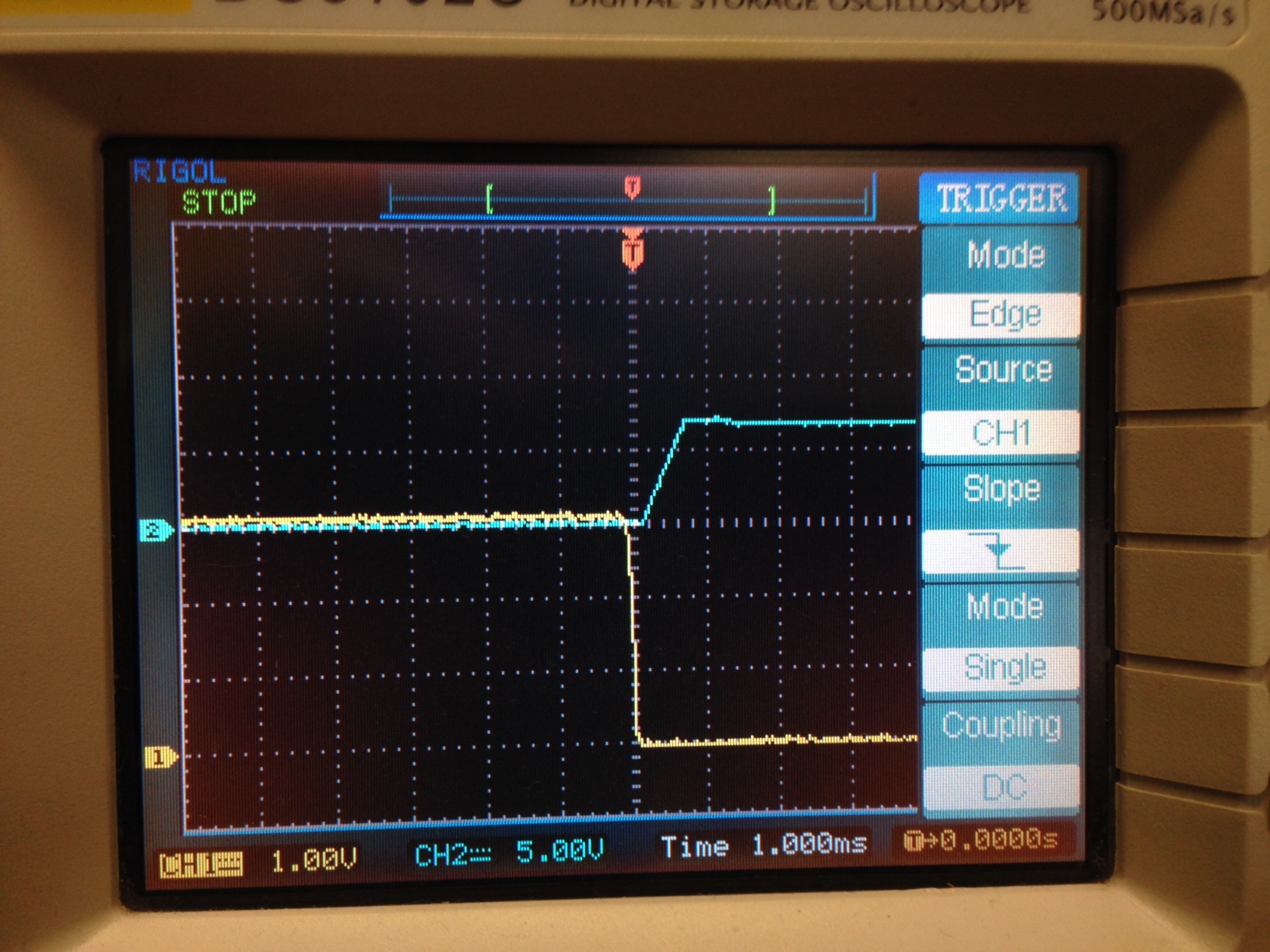

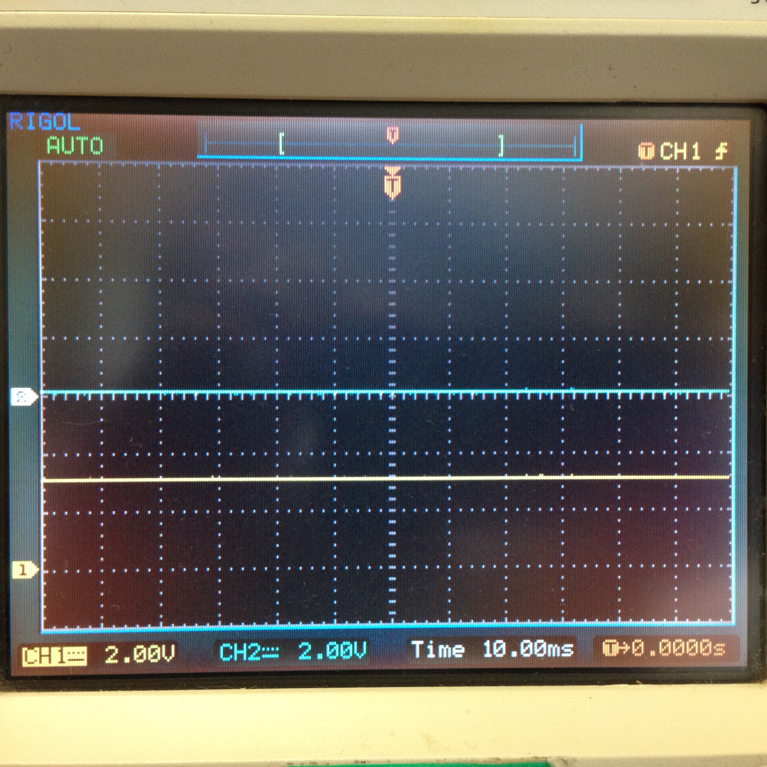

  • Hi Rick,
    I observed the following results as you wish. Now, what can I do Rick?
    First picture for INH_A and GH_A
    Second picture for  INL_A and GL_A
  • Hi Umit,
    Thank you for the scope captures. I have asked a colleague for his comments.
  • Hi Umit,
    The driver does not appear to be responding to your inputs.
    Did you design your own PCB? Is it based off of an EVM design? Can you confirm this same issues on another PCB?
    Can you check for any shorts or open circuits? Can you confirm the PowerPAD is properly soldered?

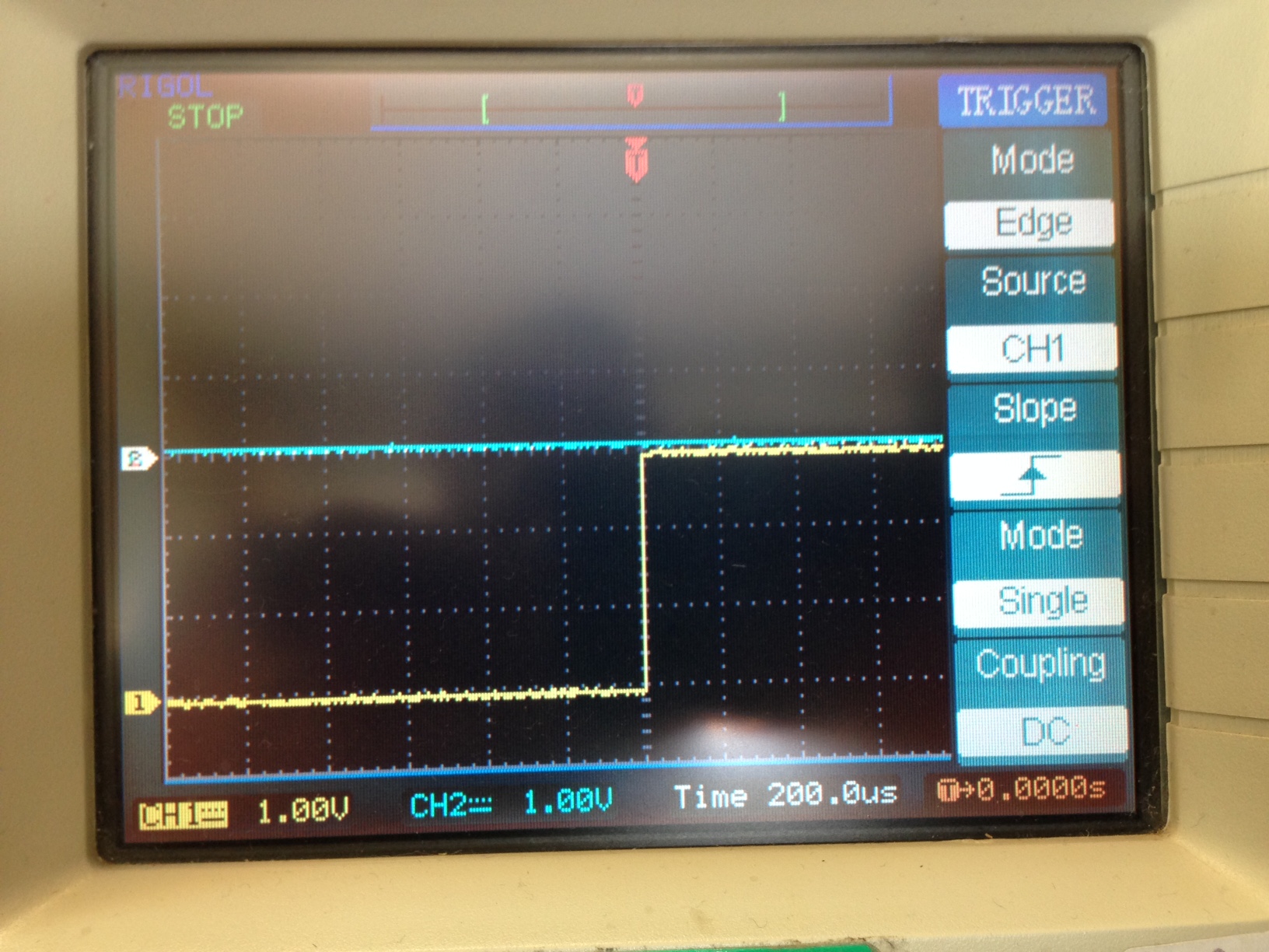

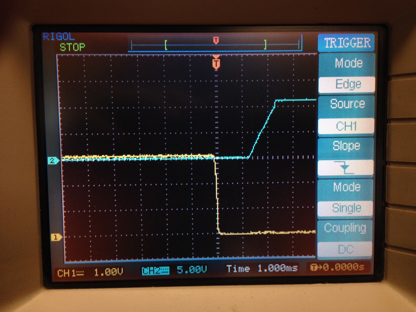

  • Hi Nick,
    We would like to thank you very much for your interest and helping.
    We captured when exactly nFAULT goes low according to EN_GATE  as you wish.
    Also we observed gate input of mosfet when EN_GATE going high.
  • Hi Umit,
    Thank you. The ENABLE and nFAULT look typical so far.
    On power up (EN_GATE set HIGH), the DRV8302 will hold nFAULT LOW until it finishes its power up sequence (~2ms). Can you capture nFAULT with DVDD, AVDD, and GVDD. Let us see how these regulators are powering up as these should be the only blocks that should issue nFAULT without nOCTW. You can use a 1ms time scale and trigger on the falling edge of nFAULT.

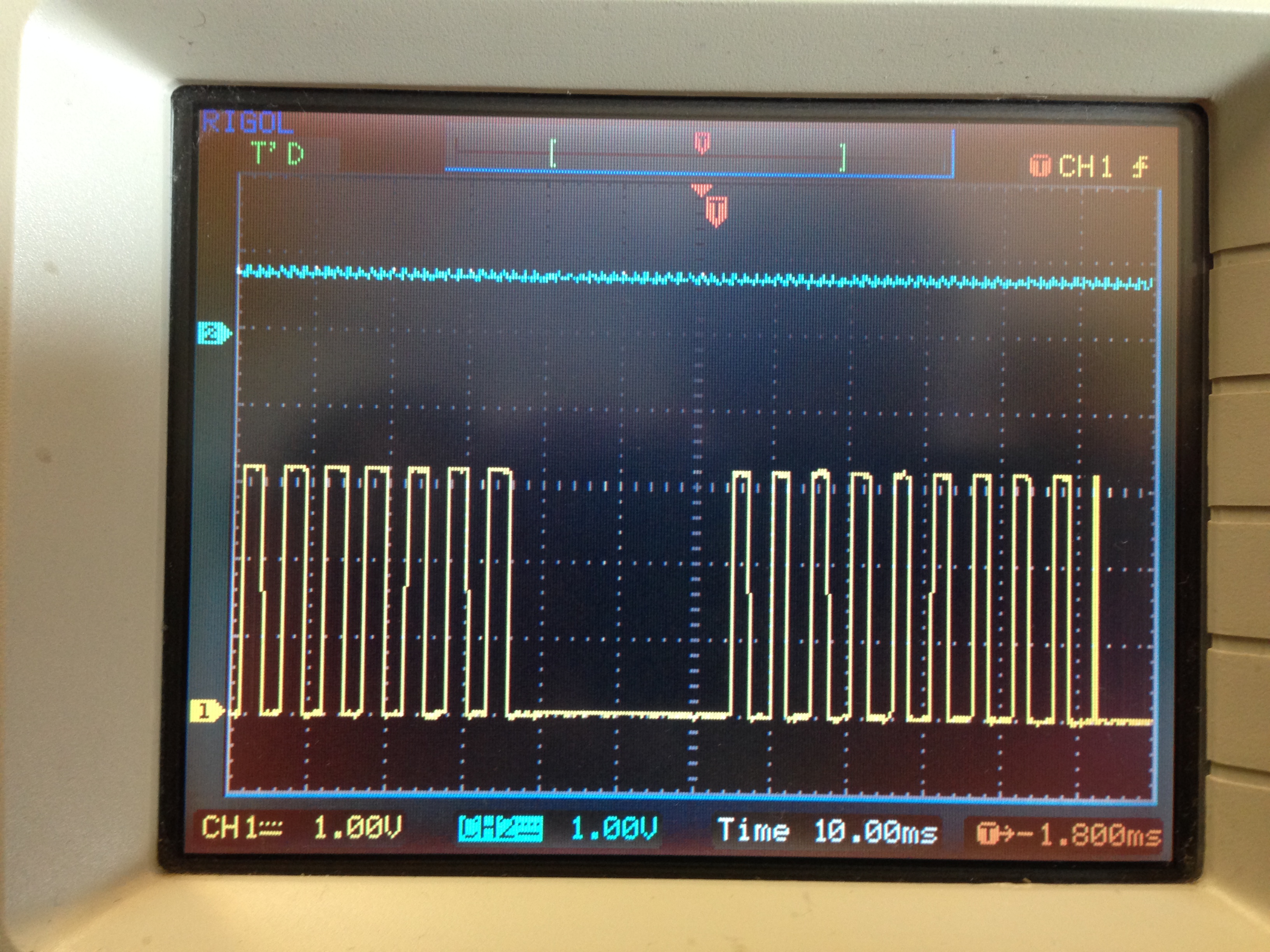

  • Hi Nick,
    We captured nFAULT with DVDD, AVDD, and GVDD.
    AVDD and nFAULT below.
    AVDD AND nFAULT below..
    GVDD and nFAULT below..
  • Hi Umit,
    Thank you for the timely response and wave forms. From these it appears all the regulators are successfully powering up....so the mystery deepens...
