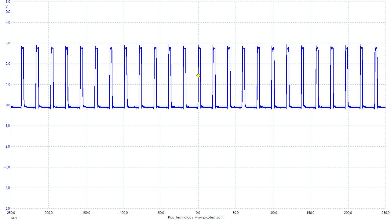

  •  Hi Rick. R=1.6ohm bUt I cannot measure the L and am out now I=4.3A for motor. ı have disconnected the sense resistor it is going fast as direct supply connection.
    Edit: R=11.6 Ohm, L=4.4 mH, Rated current is 4.3A motor model SanMotion t406 type motor from sanyo denki
    I think, probably current sense circuitry in the controller cannot sense the voltage drop on R_Sense because it is 100 times smaller than the armature winding resistor. I think I need to increase the R_Sense resistor up to 1 Ohm or more.
    Image is the output waveform when IN1 is 1 and IN2 is 0, slow decay with 0.1 Ohm R_Sense resistor.
  • Hi Rick and everybody :)
    I've solve it with decreasing the R_sense down to 0.025Ohm and now I can reach the 3 A. Thanks.
  • Hi Orkun,
    Raising the sense resistor to 1 Ohm is not a good idea. This will violate the absolute maximum ratings of the ISENSEx pins when more than 800mA is flowing through the resistor.
    The device is driving current for approximately 5us, then switching to slow decay. There are a few of possible reasons for this ( in order of ease of checking):
    1) The VREF voltage is lower than expected, or the sense resistor is higher than expected or wirewound.
    2) The current limit is exceeded to enter current regulation. This may be caused if there is a capacitor across the motor terminals.
    3) Noise on the sense pins is causing this behavior.
    If you are using a wirewound resistor, please switch to a film resistor or multiple resistors in parallel to achieve the wattage.
    If you have access to a current probe, please zoom in on the 5us where the output is high to measure the current. If it approaching the 4A regulation setting, look for a capacitor or some other reason the current is that high. You can also measure the voltage across the sense resistor to get the same information.
    I don't suspect noise at this time because the events are repetitive, but cannot rule it out.
