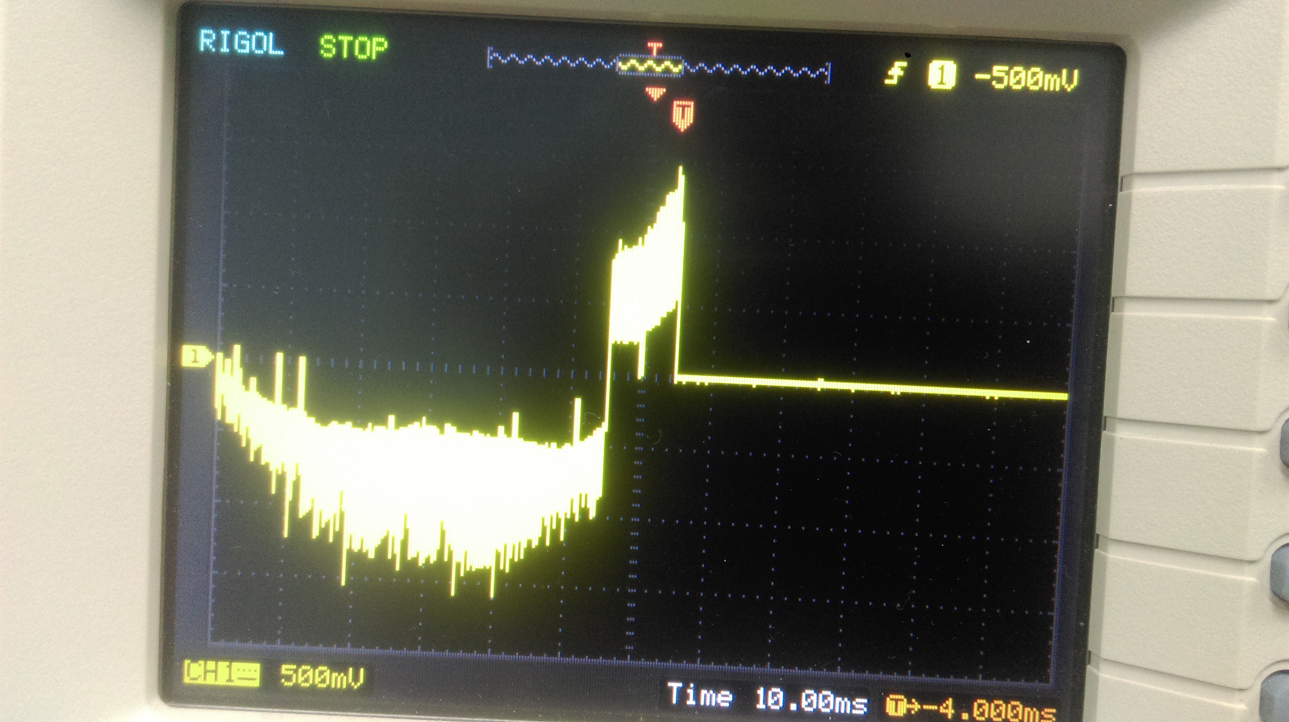

I am using DRV10983EVM with USB2ANY and GUI. Motor parameters- 3-ph, BLDC, 12-V , 1 A, 25000 rpm(max speed), 1 pole pair.
I am trying to run the motor using the drv10983evm kit. First I followed the tuning guide to find out the motor parameters. Then I tried to start the motor, motor starts initially but immediately it stops after 2-3 seconds.  I tried to change the parameters and make the motor work but it fails every time.Have no idea where to debug. VCC provided to the kit 12 V.

  • Hi Pawan,
    DRV10983 has several lock detection mechanism and I am assuming on of the lock detect is getting triggered here and causing motor to restart.
    Can you please check on 'Display tab' of GUI which 'Fault code' is displayed. One of the 5 LEDs will be turned 'ON' when motor stops, can you let us know which one is getting turned ON. Each LED corresponds on the lock detection shown on 'Advanced Settings' page.
    Can you also share with us the Phase current plots when motor stops, it will help us analyze the problem and come with recommendation
    Krushal

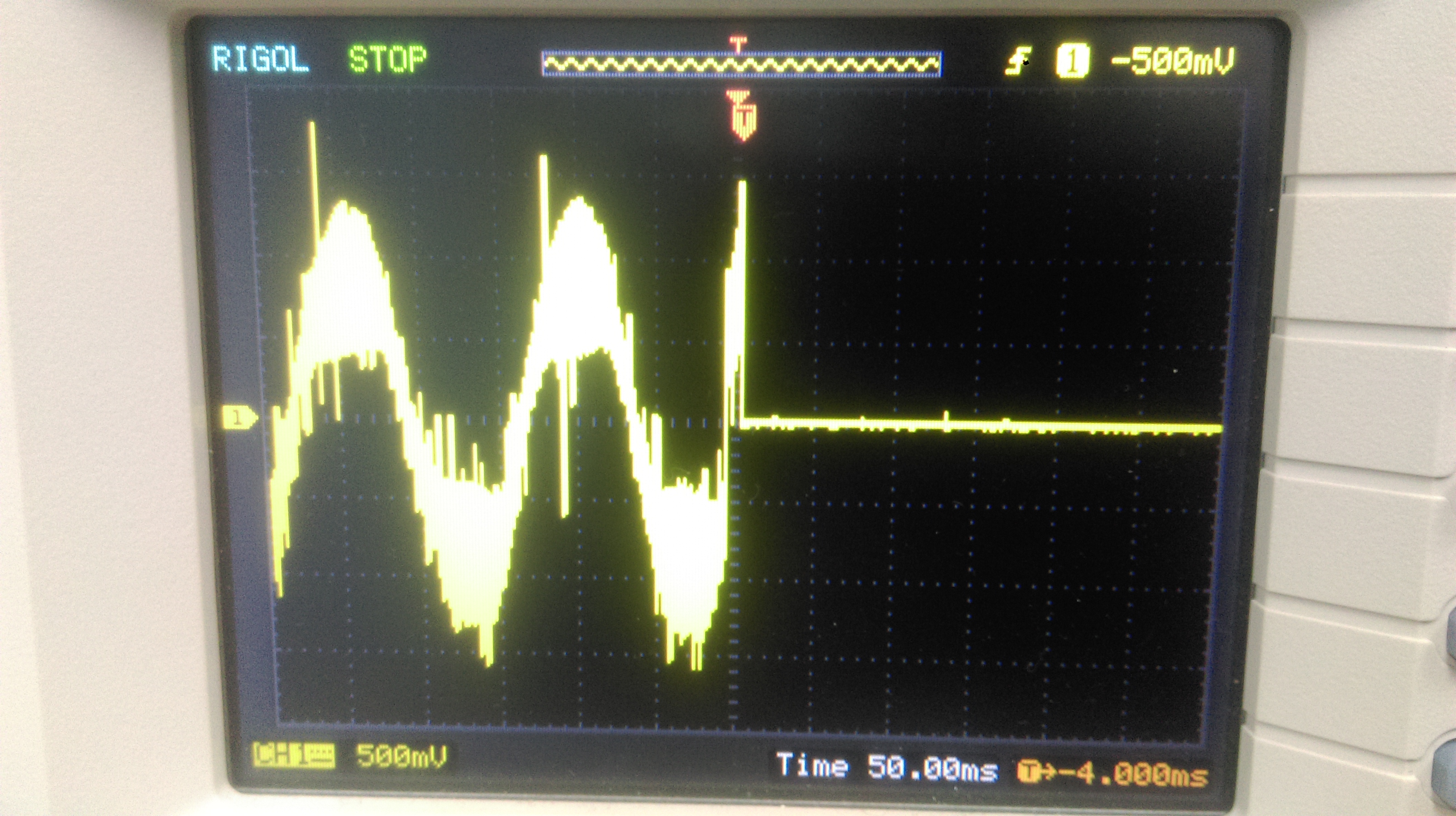

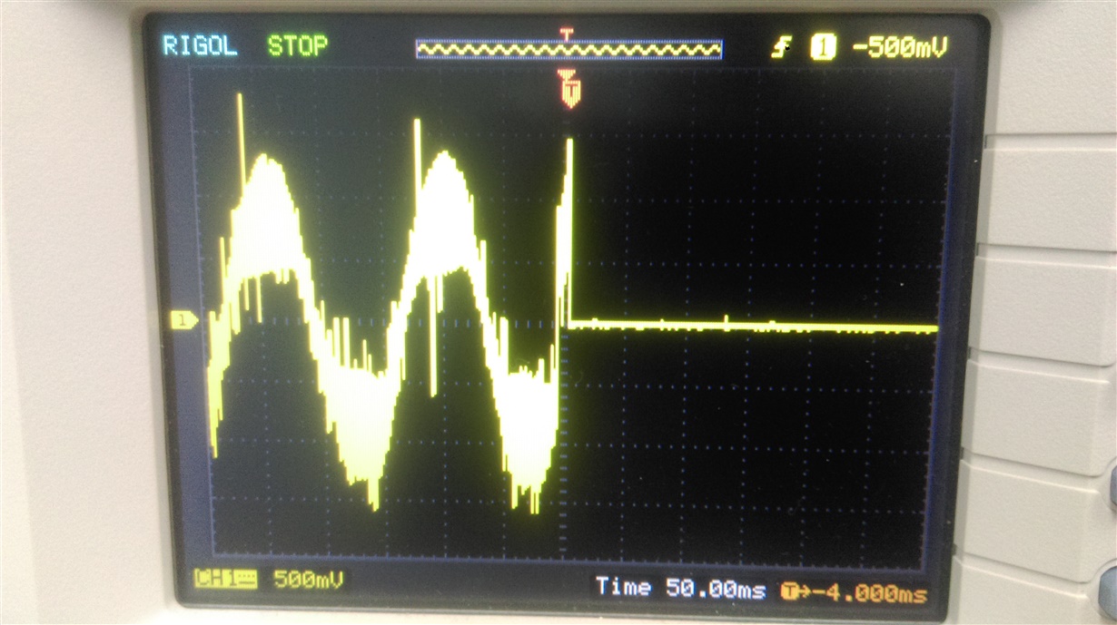

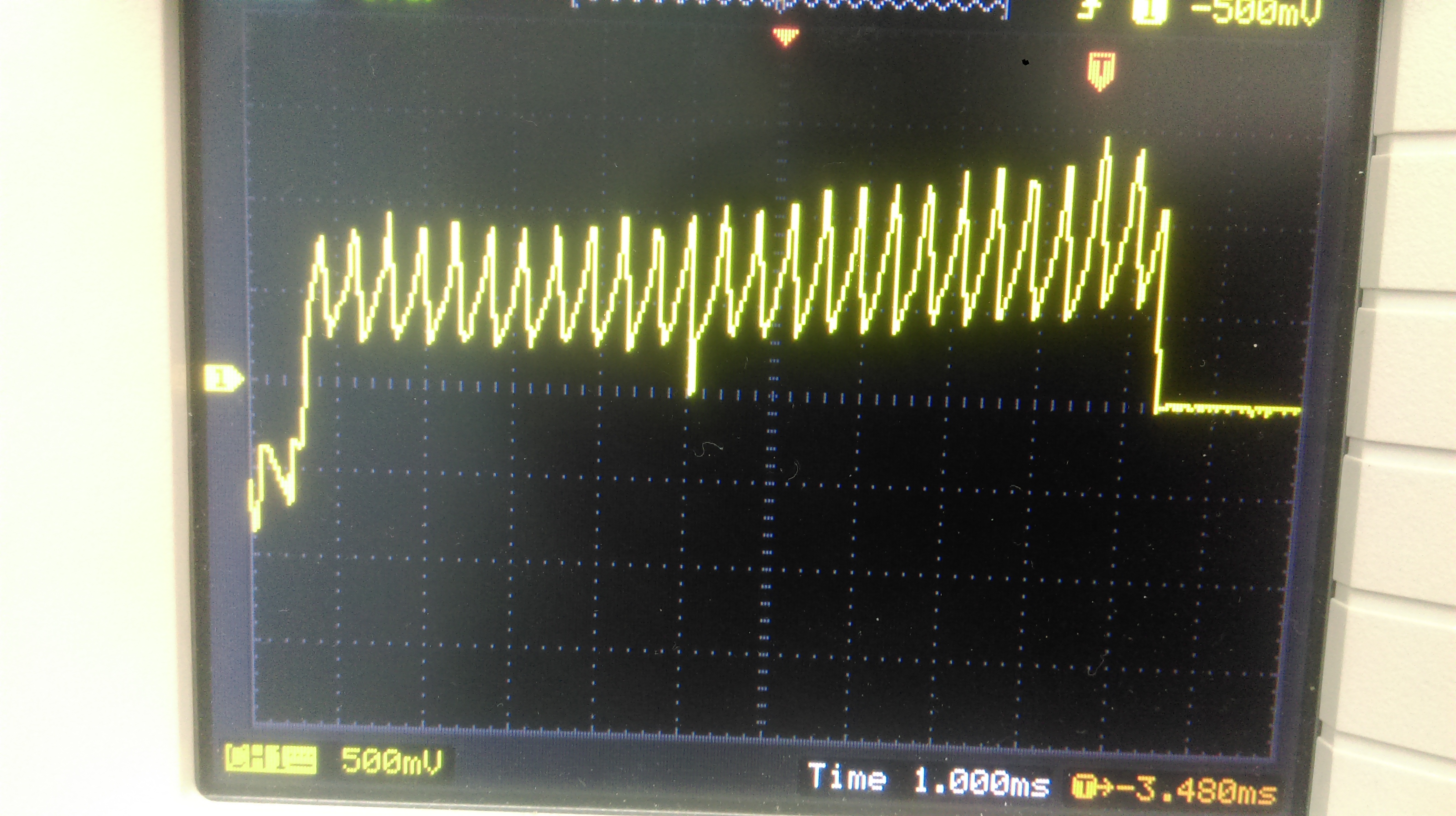

  • Fault Code is "Zero"
    Phase Current Plots are as follows:-(when motor stops)
    Zooming in......
    More Zoom....

  • Hi Pawan,
    What is scaling for phase current?
    There is no mechanism to add delay to lock detection, but you can increase threshold of current by changing 'Lock Detection Current Threshold'
    If you still encounter fault after increasing threshold for lock detection, decrease 'Acceleration current limit' on display page and decrease 'Phase to Phase Kt' value
    What are the motor parameters - Kt and Resistance for this motor
    Let me know how it works
    Krushal
