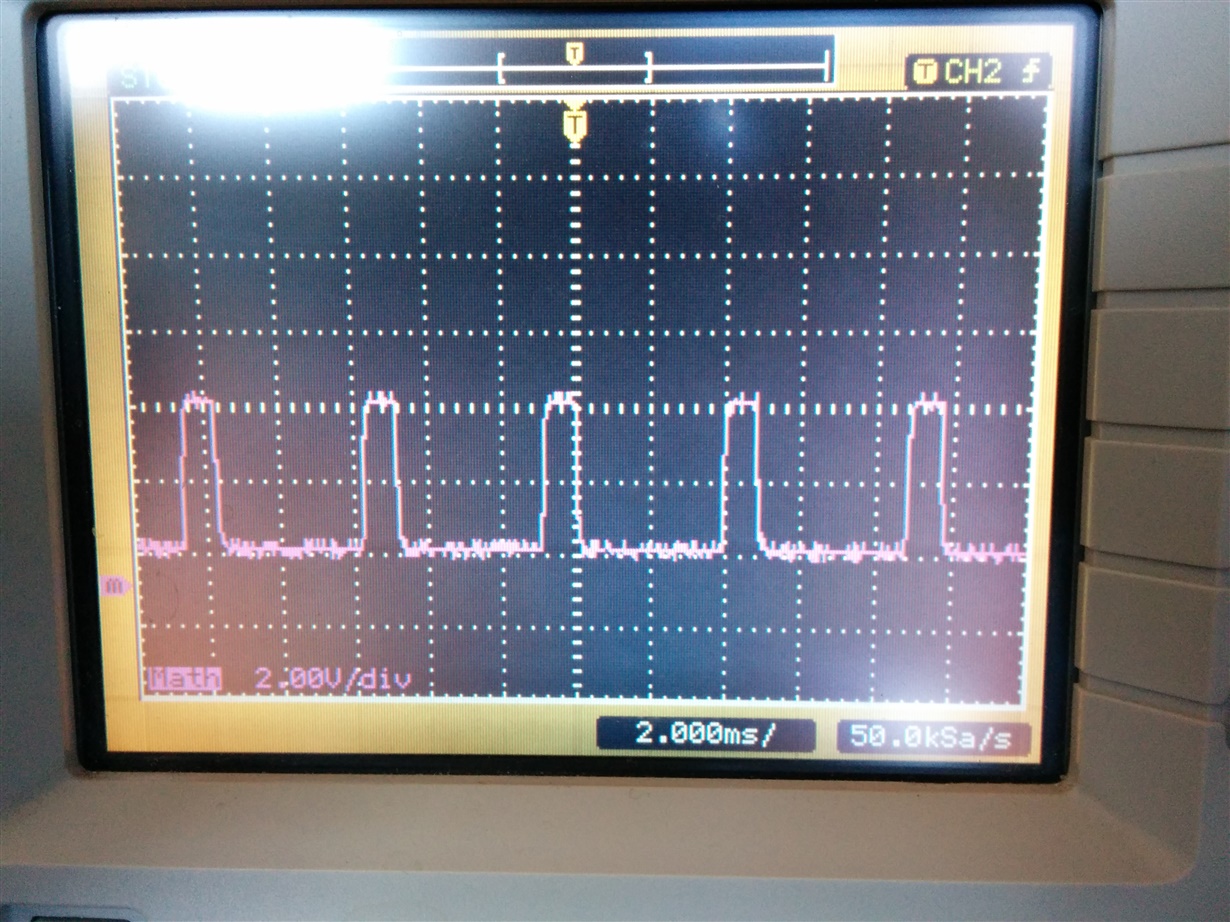

  • Hi Peter,
    Here is a photo of the output waveform after a low-pass filter:
    Does that output look OK? Again, if I change the input PWM, this signal does not change at all. I checked the signals going into the DRV2603 at the pads and they all look good (Enable toggles on/off, PWM carries the PWM signal I generate, ERM/LRA is drawn high).
    If you have any further ideas, please let me know.
    Thank you!
    Dan
  • Hi, Dan:
    i think there is some misunderstanding.
    the low pass filter cut off frequency should be 1kHz.
    for LRA (Linear resonance actuator), the drive signal is a AC signal.
    for measurement, we need to add a low pass filter to each channel (OUT+, OUT-), and use math function(minus) to get a differential drive output.
    from the scope capture, it looks like a 20kHz PWM, which is the carrier PWM frequency.
    please refer to the test setup in the data sheet, and also Figure 2 for what a common lRA driver signal looks like.

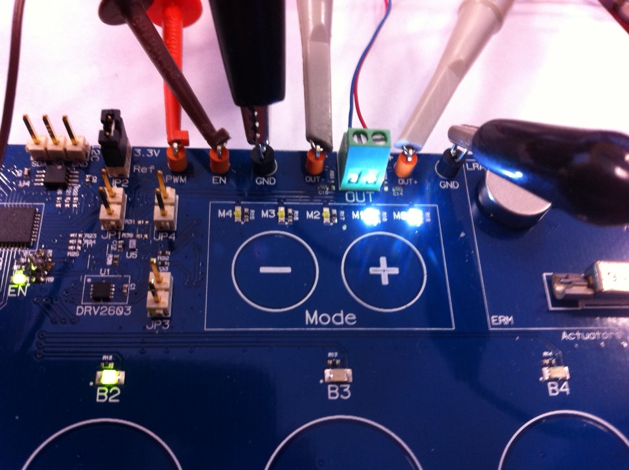

  • Hi Peter,
    I think my setup was OK except I was using 3kHz as the cut-off frequency for a digital low-pass filter (the manual suggested using 1 - 3.5kHz). I've changed it to 1kHz. I've connected the oscilloscope probes to the OUT+ and OUT- channels (which already have low-pass filters integrated) and then used the math function on my oscilloscope to output the signal I sent in the last photo. I also use a digital low-pass filter on the scope.
    With the 1kHZ cut-off frequency this is what I'm getting (traces from top to bottom: OUT+, OUT-, Math (1-2)):
    And here is my setup (inputs to PWM and ENable, oscilloscope probes attached to OUT+, OUT- and GNDs, LRA attached to OUT):
    Thank you,
    Dan
  • Hi, Dan:
    it looks like an ERM drive waveform, not LRA drive waveform.
    can you check the configuration pin of DRV2603?
  • Hi Peter,
    I confirmed that the configuration pin is set HIGH which seems to be the correct setting to select for the LRA mode. I'm going to order a few of the DRV2603 chips and try building my own board to see if I have better luck. Maybe the evaluation board I have is defective.
    Thank you,
    Dan
  • It seems there is something wrong with the Evaluation Board we received. We put together our own board with the the DRV2603 and it works just fine to drive our LRA.  Thank you for your assistance.
