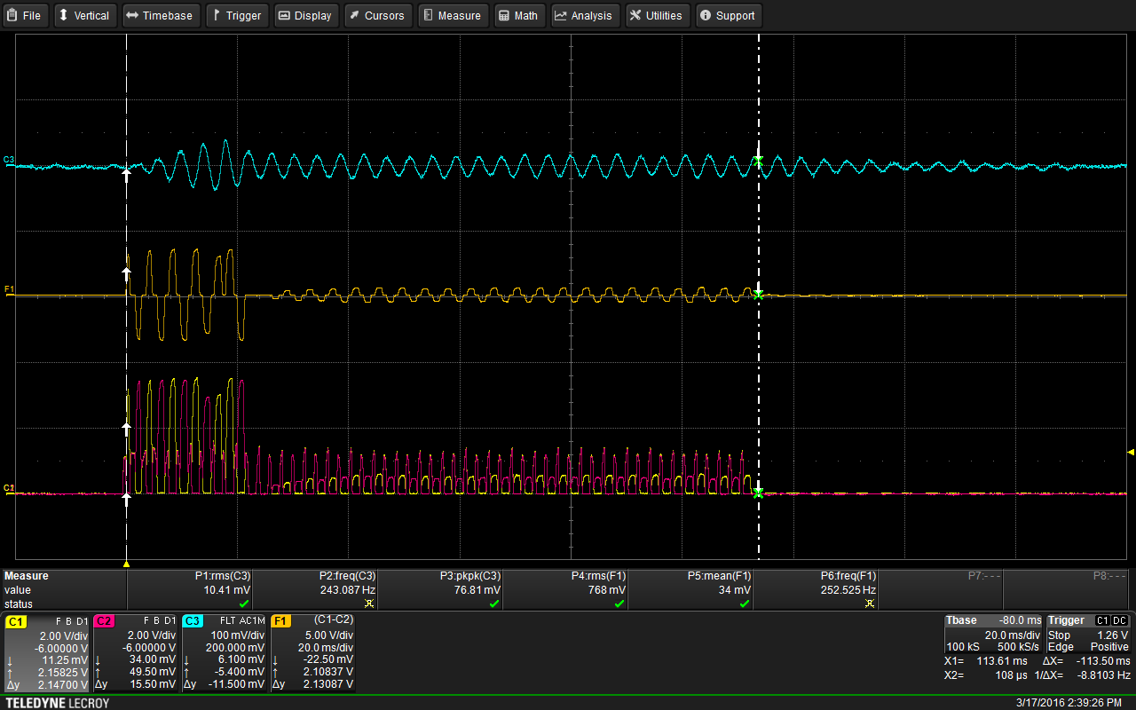

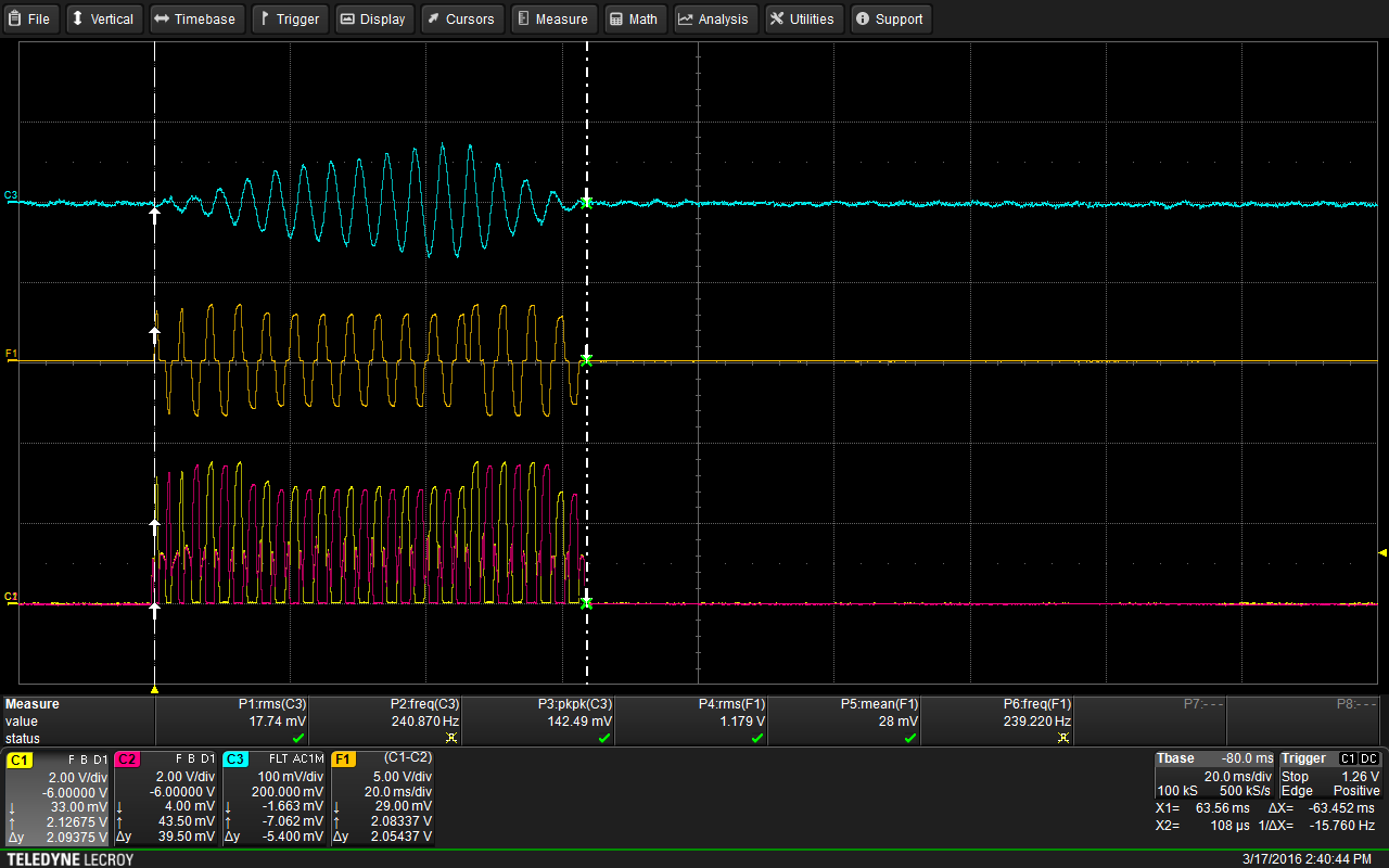

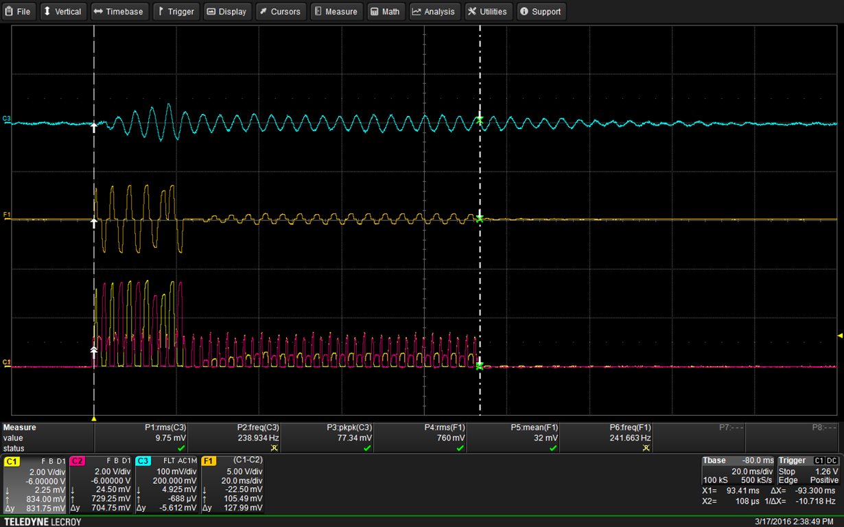

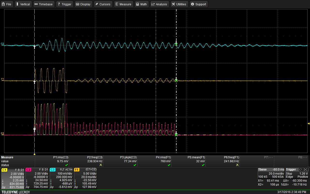

  • George,
    After doing some analysis, I too was able to expand/shrink some waveforms using SPT/SNT, and others I was unsuccessful.
    Here is what I tested setting the Sustain Positive Time register to 0x04 (therefore a 20mS offset). As seen in figure 1 we used a waveform generator to simulate what waveforms 1(strong click) and 7(soft bump) would look like with and without a SPT delay.
    As you can see both (Simulation, and scope measurement) the generated waveforms for Waverform7 had approximately a 20mS increase in the length of the sustain portion of the wave form (Figure 1 & 2).
    Then, when looking at Waveform1 you notice there is no change on both simulation and scope measurements on Figure 3 & 4 (consistent with your findings).
    Figure 1
    Figure 2
    Figure 3
    Figure 4
    Figure 5
    What it comes down to is pretty much what Peter Li mentioned in his above response. Since there is little or no sustain portion in the waveform for the Strong Click, the SPT/SNT cannot increase nor decrease the non-existent portion of the wave. You can increase both the ODT and BRT since those sections of the wave are within the wave form (I am not recommending increasing the ODT/BRT for it can damage the actuator by over driving, just proving a point).
    I did not go through all of the waveforms as you did, but from what I noticed the waveforms that the SPT/SNT did not change was due to the little or no sustain portion of the waveform.
