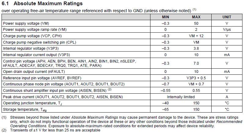

Hi Team,
I believe it is no ploblem to supply 5V for APH, BPH, ATE, nSLEEP, TOFF, nFAULT even if VM isn't supply yet.
Is my understanding correct?
I would like to confirm just in case.
