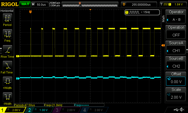

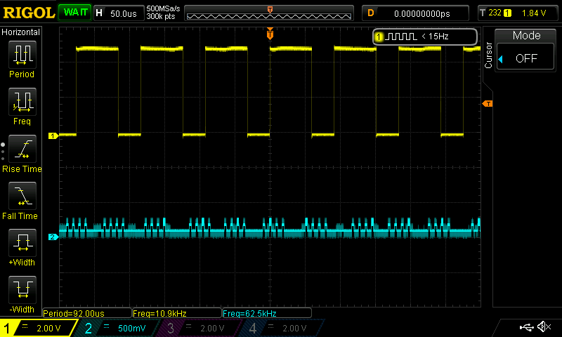

Here is a scope shot of the input PWM ( yellow) and output waveform ( blue) on one of the motor output terminal.

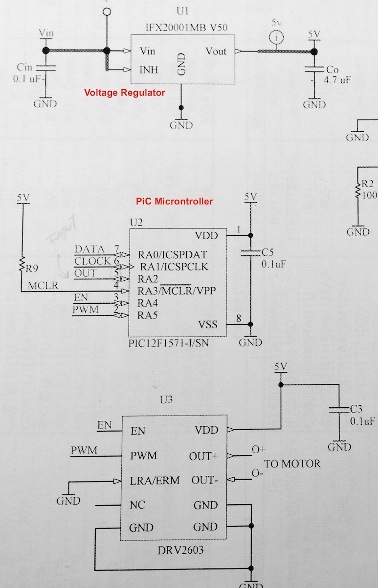

Any idea what I am doing wrong? I am also including the schematic below. I appreciate your input. Thank you !
