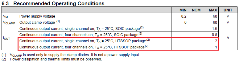

Hi Team,
The datasheet shows the following about HTSSOP package.
Is it possible to output 2A per channel simultaneously when two channels on?

    We will have to investigate. Can you provide more information about the application?
    Will the motor run at 2A continuously?
    What is the ambient temperature?

    I will put the reply as the folllowing.
    ->My customer drives a unipolar stepper motor for 2-phase full-step.
     The requirement is 1.5A continuously and 2A peak per channel simultaneously when two channels on.
    ->up to Ta=80℃
