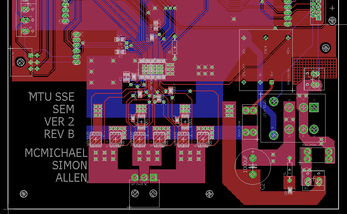

We are students at Michigan Technological University and are having issues implementing the DRV8303 chip to drive a 300W PMAC motor.  After populating our board and doing several safety checks, we successfully operated our motor with trapezoidal control under open load conditions.  We attempted to use sinusoidal code to run the motor and received 0x0600 back from status register one.  Now, when attempting trapezoidal control again, the same error occurs.  Here are the steps we took:
1. Trapezoidal commutation with default control register settings.  This worked without any errors in the status registers; however, when applying load to the motor, could stall so GATE_CURRENT was changed to peak 1.7A and OC_MODE was changed to report only (0x13E0 was sent).
2. Trapezoidal commutation works with changed settings.  Now, when applying load to the motor and stalling, the motor would continue operation after the load was lifted.  During this operation, overcurrent was reported on one of the FETs under stall conditions and then status register read 0x0000 after the load was lifted (as intended).
3. After trapezoidal control was working as expected, we changed to sinusoidal control.  The only difference in status registers was changing PWM_MODE to 1 (sent 0x13E8).  This time, we received 0x0600 out of the status register and immediately stopped operation.  We had used the sinusoidal code on the DRV8301 BoostXL board and had no issues, so this was concerning.  We checked the FAULT line and it remained low during this operation (~40 mV); unfortunately, we did not check the voltage of GVDD.
4.  Next, we decided to retry trapezoidal commutation to ensure that was still working.  Unfortunately, the same status register response occurred, 0x0600.
Due to the nature of the event, we believe this is a software error as all the hardware was working properly with trapezoidal control.  We can post snippets of our code and board layout if that will help addressing what happened and how we can fix this issue.

  • I can measure those values in 3 hours, however, here is the schematic, board layout, and a snippet of our code which handles the hall effect from our motor, and our main.c file as well.  The hall code is interrupt based.
     Sample Code.hBLDC_v2.brdBLDC_v2.schmain sample code.h

    There are a few things to try based on the schematic. After the device is replaced:
    1) You can use a power supply and lower the current limit to determine if there is a possibility for shoot through.
    2) Look at the GVDD for spikes that could damage the pin. The ground path is longer than is recommended. Please note the layout guideline section of the datasheet.
    3) As mentioned, the dead time in 3PWM mode is set to the DTC setting (50ns). Did the firmware add some additional dead time? If so, please consider changing the DTC resistor to account for that.
  • Thanks for your advice. We will replace the device tomorrow. We will add the current limits again to check for shoot through and monitor spikes in the GVDD line. There was no dead time added for the trapezoidal code. For future revisions of our pcb, what is the maximum distance you recommend from the DRV8303 GVDD capacitor to ground?

    Does the code or PWM change both inputs on the same instruction or clock in 6PWM mode? Sometimes this is not obvious, but there can be a one or more internal clock delay.
    Please refer to the DRV8303EVM documentation for a working example of the layout.  The hardware files can be found HERE
