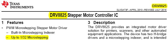

Hola,
Can DRV8841 do the microstepping with 1/32 like DRV8825?
If not, what's the minimum microstepping of DRV8841?

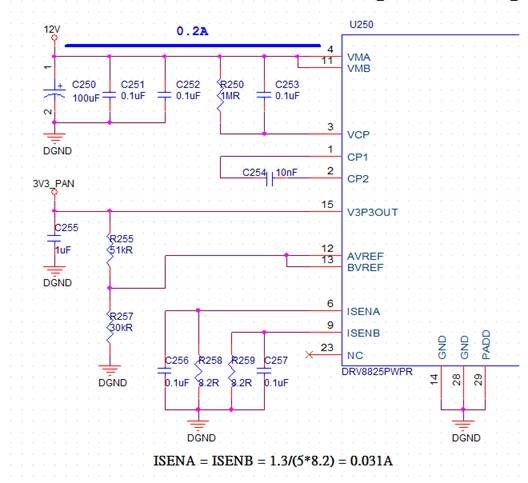

    BTW, I have DRV8825's question as below:
    May I know that Can DRV8825's AVREF and BVREF get up to 3.3V by external divider resistor?
    That's because of our motor needs a bigger torque to drive so it needs increase the current.
    In addition, I will decrease the resistance of ISENA and ISENB.
  • Yes. You can get to 3.3v for Vref. But recommand less than 2.5v and bigger than 1v for best perfermance. And the R sense should be smaller so that the voltage drop less than 0.5v.
