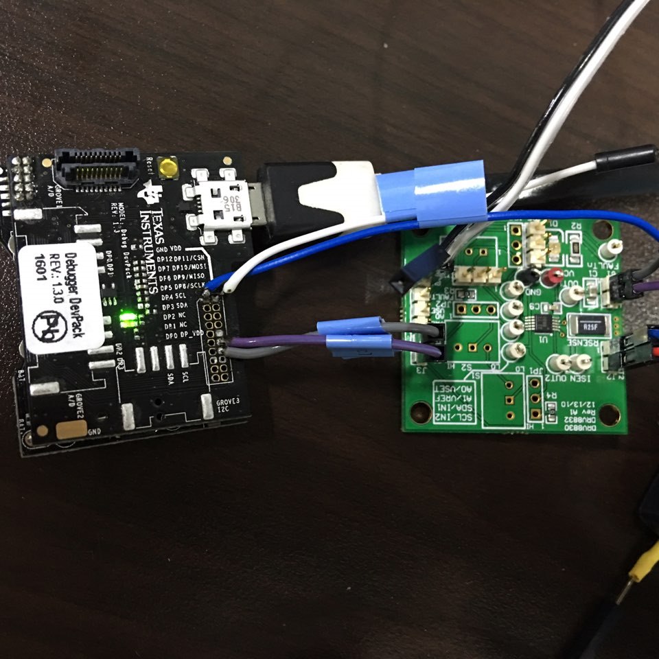

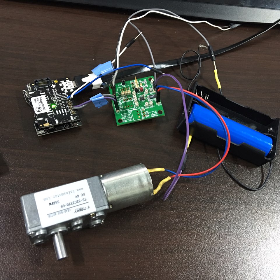

Hi!
I would like to operate motor using  cc2650STK, drv8830, DC 6V 55RPM TS-32Gz370-69.
using IAR Embedded Workbench IDE
but it didn`t operate at all....
i using Api sensorTag adding drv8830.c and drv8830.h of applying the function to be called
I2C that the connection between mcu and motor driver I`m not sure.
How can I verify that the I2C communication between two modules? The settings that are in the source code
If it is how to fix
I will source attached.

  • Hi Park,
    I am moving your post to the motor driver forum for better support for DRV devices.
  • Hi Park,
    Thank you for supplying pictures of your motor setup.
    Do you have a solid ground connection between the DRV8830EVM GND and the CC2650STK board GND? Without that the I2C signals will not be read properly by the DRV8830.
    Ensure the driver is correctly powered on with the VCC supply before initiating I2C commands.
    Your JP4 and JP5 configuration is correct for the I2C base address used in the supplied code.
  • Hi Park,

  • hi Phil Beard
    GND and between my cc2650STK DRV8830 state is not connected. The power supply to the serial port on cc2650STK state and was connected to a battery DRV8830.
    Why is the solid ground connection? I wonder.
    thank you. Buy one board at ti seems to be a choice not regret it.
  • Hi Park,
    Without a ground connection between the CC260STK board and the DRV8830 board there isn't a complete circuit for the I2C communication.
    Unplug the USB power from the CC260STK board.
    In your picture supplied the Blue wire connected to the CC260STK should be the GND connection for that board. Try connecting the blue wire to the black test point labeled GND on the bottom front of the EVM.
    Make sure the motor is connected to the DRV8830 EVM.
    After making this connection power on the DRV8830 EVM then plug in the USB cable to the CC260STK board.

    hi Phil Beard
    Thank you
    As was your advice. But it was not working.
    1. Do I need special settings such as open pins?
    2. Pin and sensor initiation process, I would like to know what made.
    3. The slave address of the driver drv8830 not checked when debugging.
    This is the content of the add watch 1 in IAR.
    The SENSOR_SELECT () in the drv8830.c a slave address that appears when a break point.
    It comes out 0xC8 is thought to normal, but did not.
    I look forward to your kind reply
    Thank you!!
  • Hi Park,
    All of the Jumpers should be removed from the board to get the I2C base address called in your C file (0xC8).
    Was the DRV8830 EVM powered on when you tried to read the base address?
    With both the CC260STK and DRV8830 powered on, can you measure the voltage on the SCL and SDA pins? These should both be pulled high while the I2C bus is idle.
