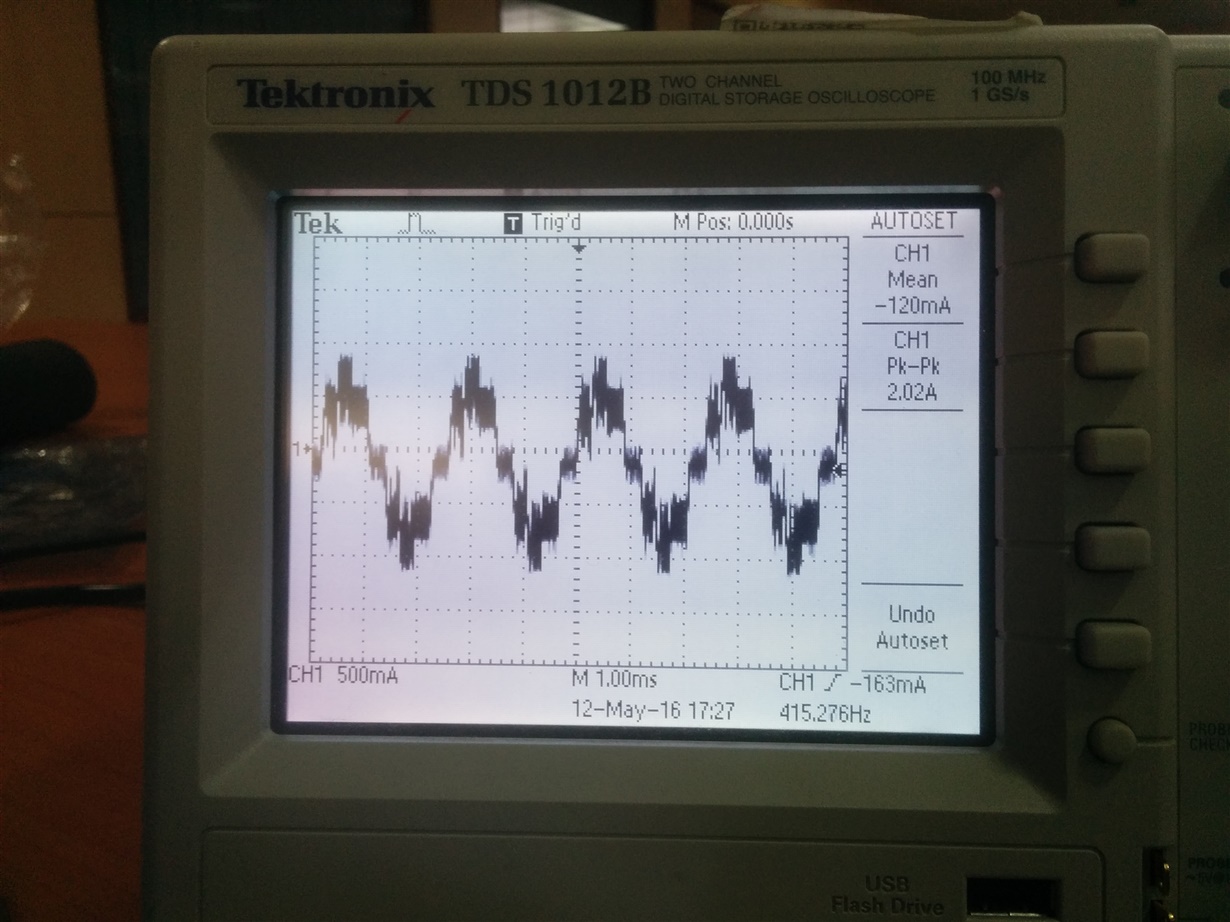

  • Hi
    Please find the attached current waveform image . We are still observing motor getting heated. Can you please let us know how to overcome the issue ?
    Pls let us know if you need any further data / image.
  • Hi Pavan,
    Do you still have the IFS set to 1.45A? The current waveform looks lower than expected.
    What microstep rate are you using?
    The motor will heat up due to the current through the windings. There is approximately 1.5W generated in the motor based on the image. RMS current = .707 * 1A peak = .707. I2R = .75W/winding * 2 windings = 1.5W
    The motor specification does not detail the expected temperature rise.
  • Hi Rick Duncan
    I have set the chopping current to 1A.
    We have set the micro-stepping rate to 1/4 micorstep.

  • Hi Pavan,
    The temperature of stepper motors increase as the motor is operated. The current waveform appears to be normal.
    It is suggested to contact the motor manufacturer. In the datasheet, there is a note stating
    "Temperature rise of the windings is 176°F (80°C) or less measured by the change resistance method when equipped with an aluminum heat sink of 6.89 x 6.89 in., 0.20 in., thick. (at rated voltage, at standstill, 2 phases energized)"
    Do you have the aluminum heat sink mounted? If not, it is suggested to contact the motor manufacturer to determine the temperature increase in the motor.
