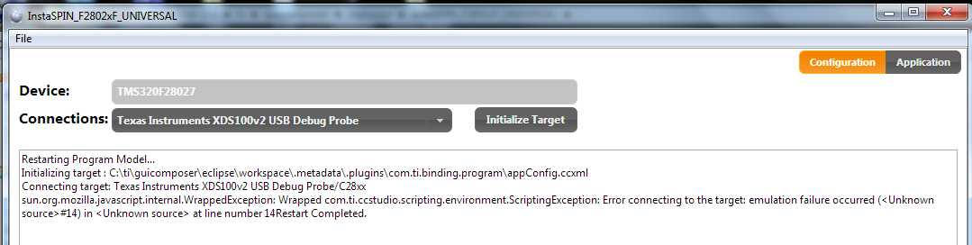

    Can you confirm the BOOSTXL-DRV8301 works with the GUI and controller board?
    Can you provide a screen capture of the GUI interface message? If there is a details button, please press it and provide the details also.

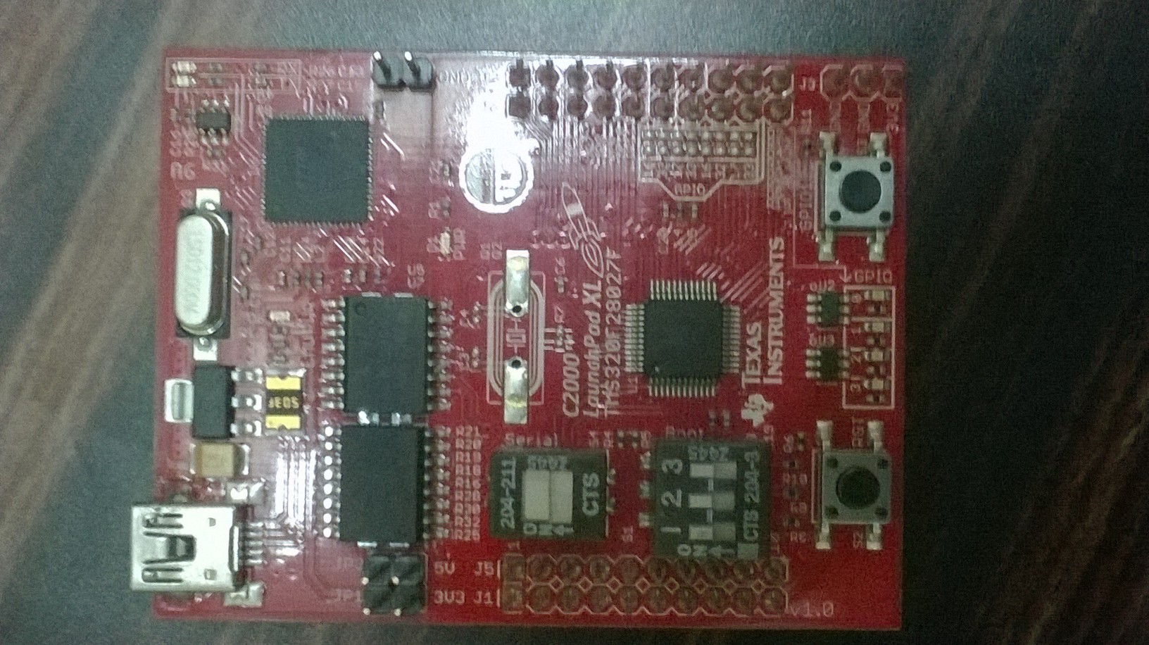

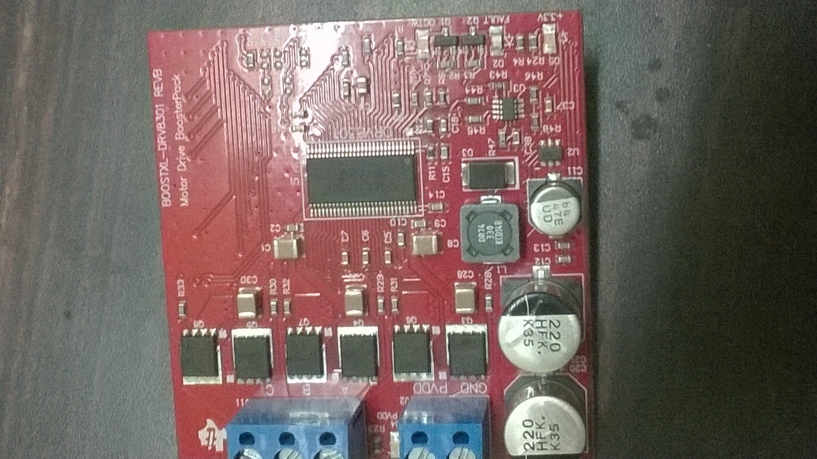

  • Respected Sir,
                               Below shown Fig 1, iFig 2, Fig3 are BOOSTXL-DRV8301 purchased kit,  launchxl-f28027f purchased kit  and  Locally manufactured BOOSTXL-DRV8301 board.
                                                                                                                                                              Fig 1. BOOSTXL-DRV8301 Purchased kit                                                                                                                                              Fig 2. launchxl-f28027f purchased kit

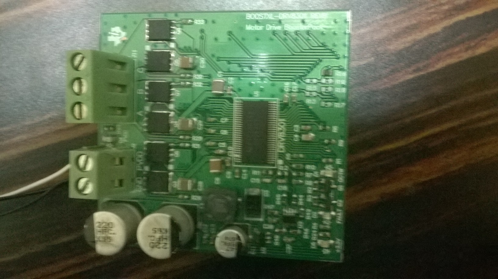

                                    Fig 3. Locally Manufactured BOOSTXL-DRV8301 board
    When I power up the BOOSTXL-DRV8301 purchased kit and  launchxl-f28027f purchased kit  ( Fig 1 and Fig 2) the BLDC  motor is running perfectly and GUI interface working fine.
    But when I tried connect Locally Manufactured BOOSTXL-DRV8301 board and   launchxl-f28027f purchased kit  ( Fig 2 and Fig 3) the voltage at OCTW PIN of DRV8301 is 0V ( as it is open drain it is indicating over temparature or over current ) , as the DRV8301 IC was not heated up it is obviously over current condition and the OC_AdJ_Set register has a value equal to 0x21 ( ie., VDS limit = 0.730V ).
    Here the BLDC motor was running but when I tried to interface it to gui, below are the errors I faced
    Fig 4 GUI Error Message
    Fig 5 GUI ERROR details
                                                                                                                                                                              Fig 6. operating parameters details.

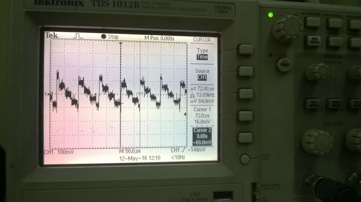

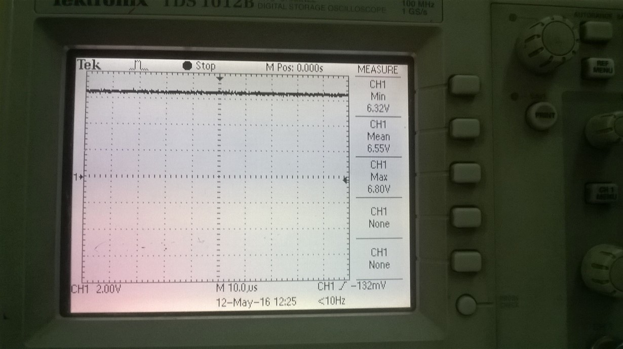

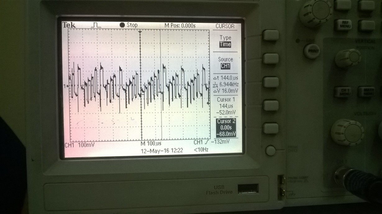

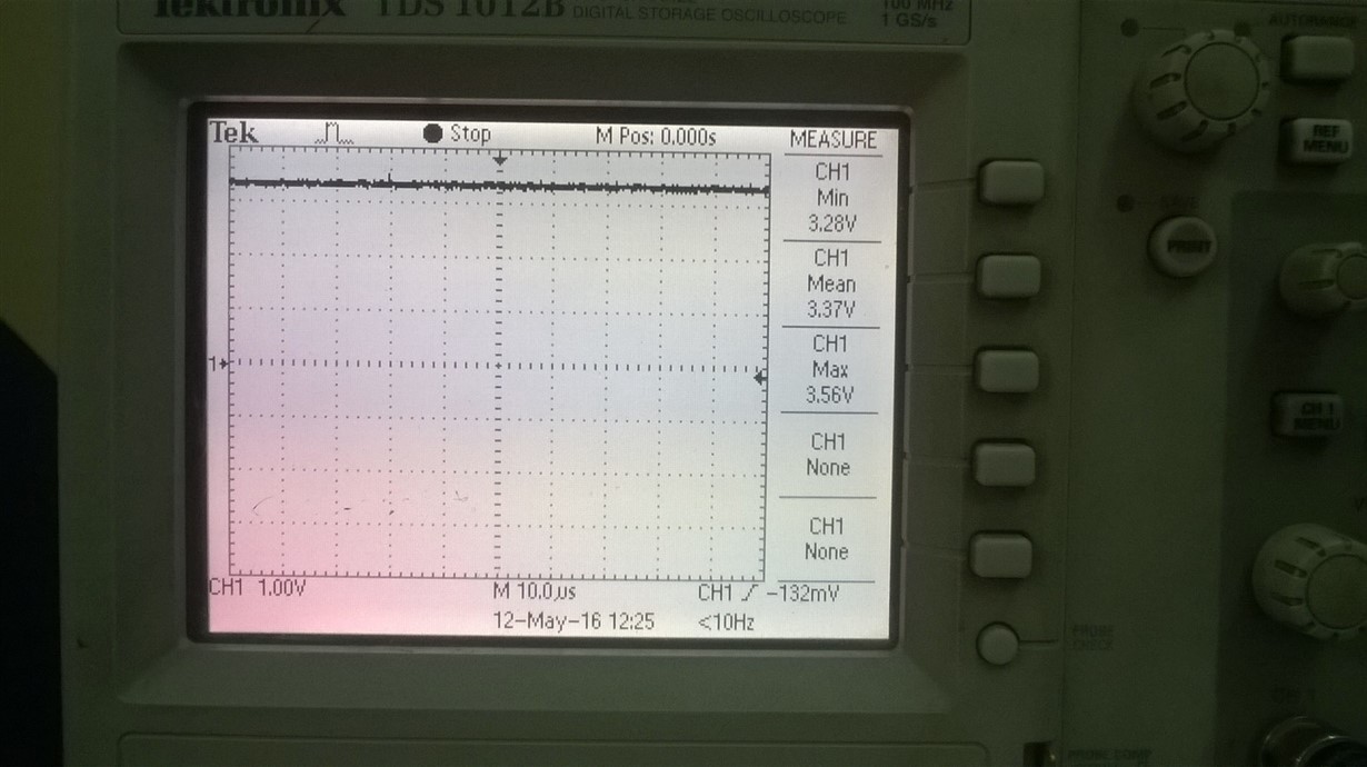

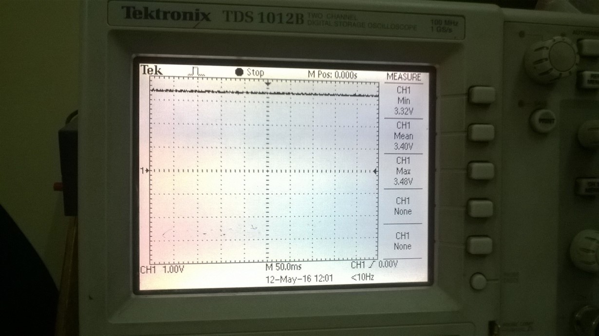

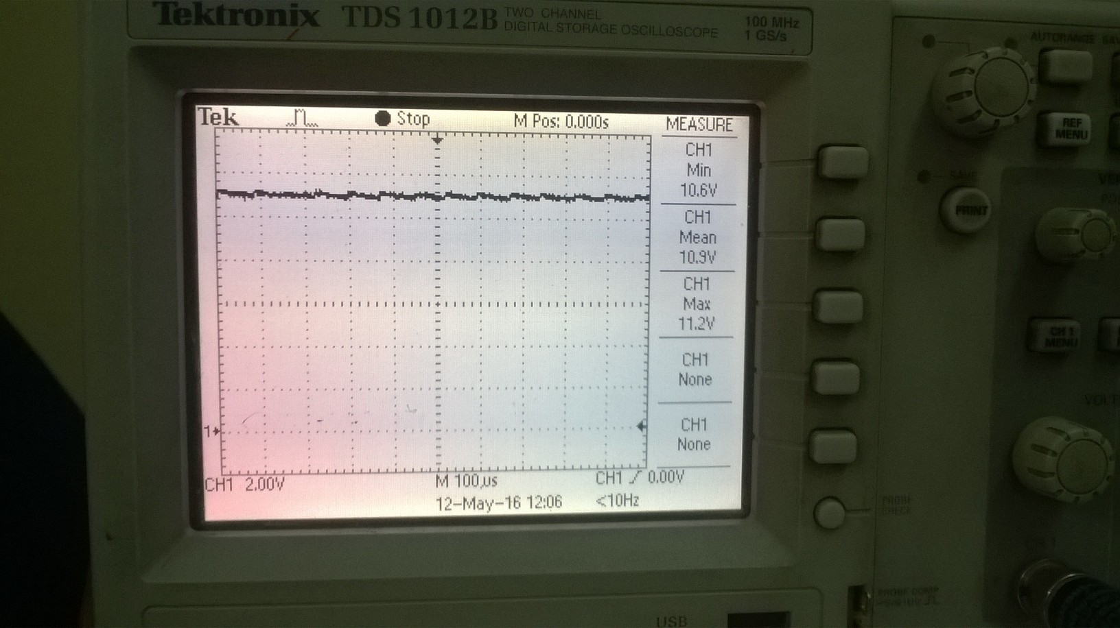

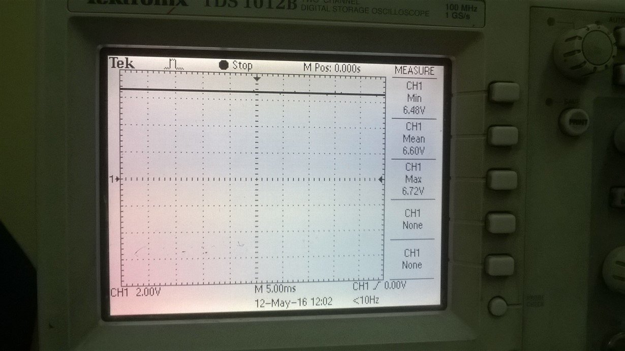

    The voltage at DVDD, GVDD, AVDD are as follows
    DVDD = 3.3V
    GVDD =  10.6V to 11.2V
    AVDD =  6.48 to 6.72V

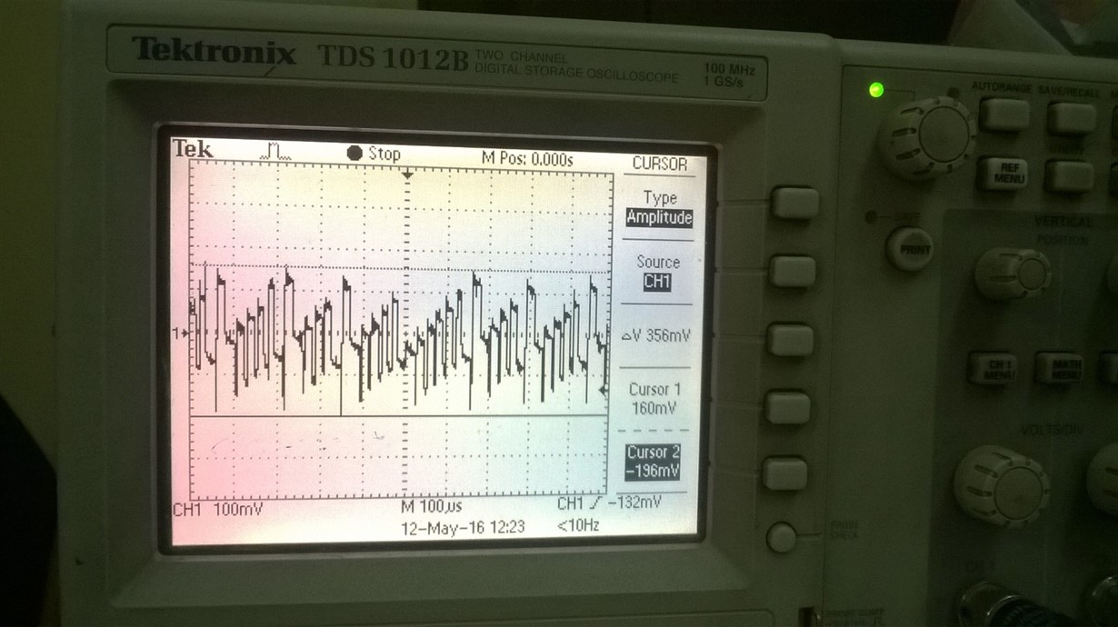

    And below are the images without Motor and with Motor load.
    Fig 7 DVDD with out Motor Load                                                                                                                    Fig 8 AVDD without Motor load

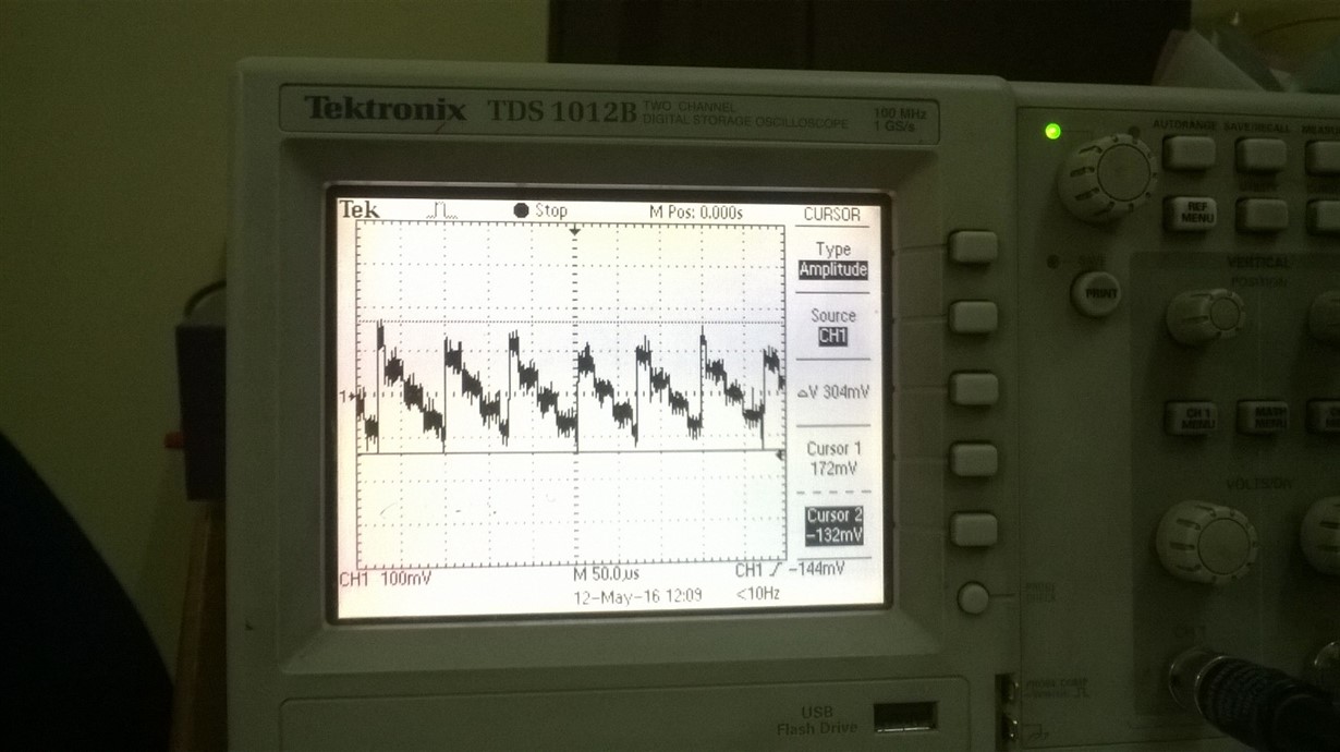

    Fig 9 GVDD with out Motor Load                                                                                                         Fig 10 GVDD ripple without Motor load
    Fig 11 GVDD ripple frequency without Motor load
                                                     Fig 12 DVDD with Motor Load                                                                                                                    Fig13 AVDD with Motor load
    Fig 14 GVDD with Motor Load                                                                                                         Fig 15 GVDD ripple Frequency with Motor load
                                                  Fig 16 GVDD ripple with Motor load

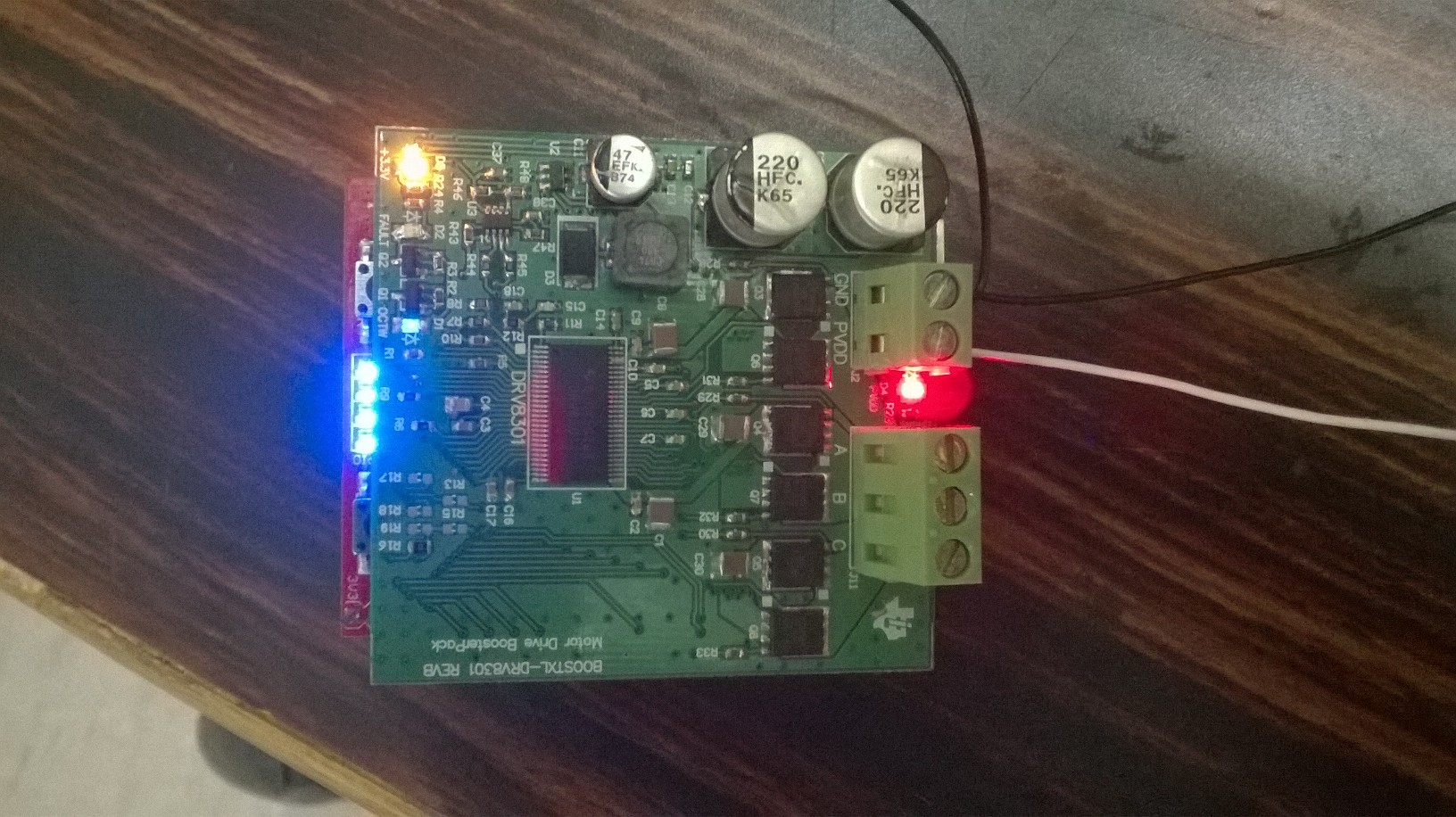

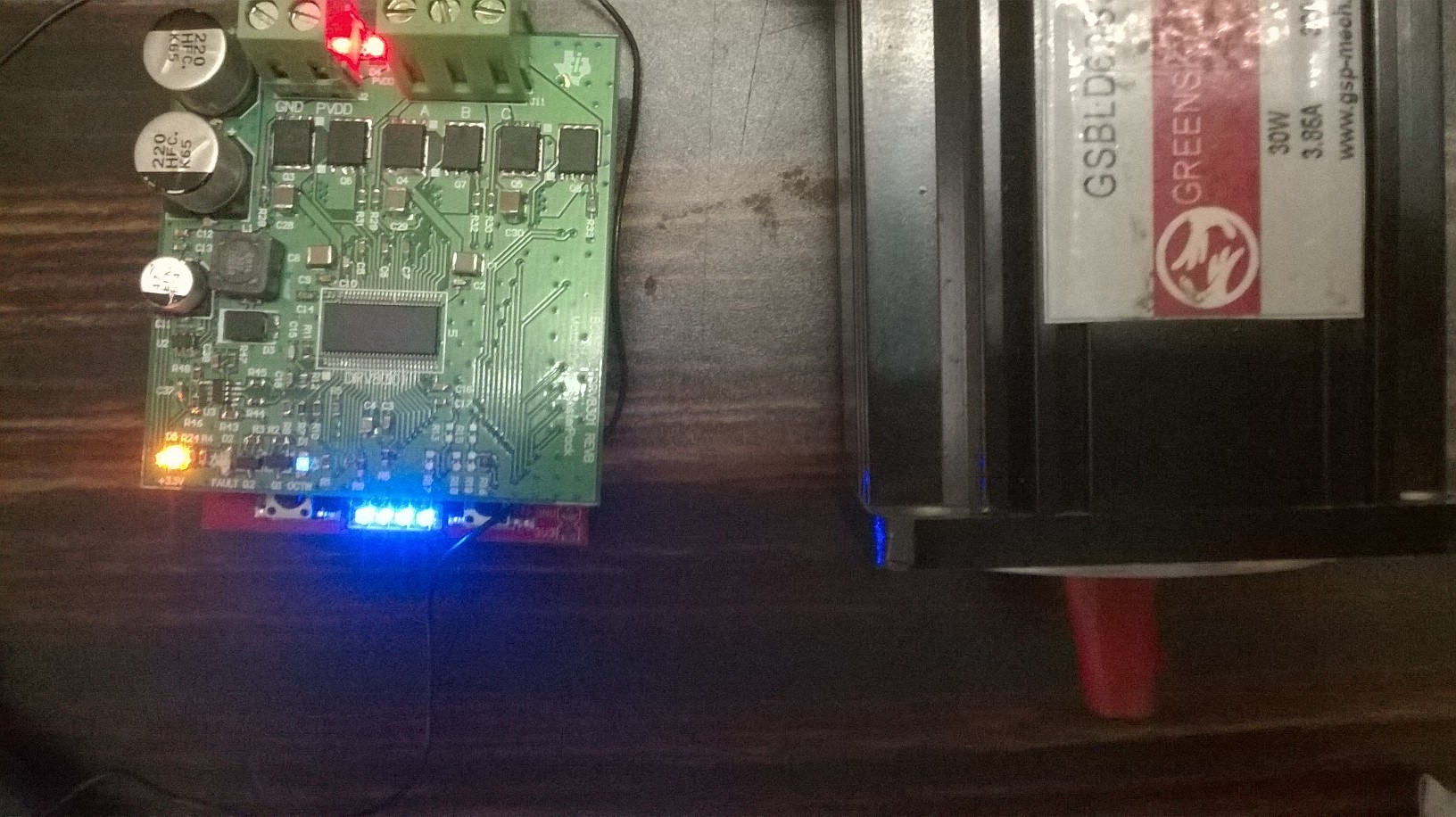

    Below are the PCB Images when I powered up the board ( Fig 2 and Fig 3 Integrated )
    Fig 17 Unit with out Motor load and OCTW LED is glowing
                                   Fig 18 Unit with Motor load and OCTW LED is glowing                                                                      Fig 19 Unit with Motor load and OCTW LED is glowing
    Note:
    Green Colour BOOSTXL DRV8301 is Locally manufactured, but the below Red Color is launchxl-f28027f purchased kit
    Anuroop
