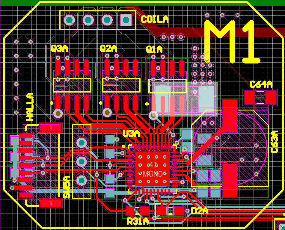

    Could you provide a picture of your PCB and the three half-bridges assembled? The "Use rich formatting" button on the bottom right will allow you to insert images.

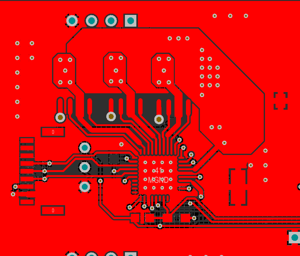

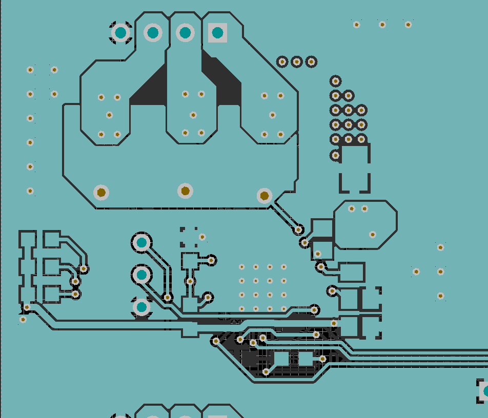

  • I don't know if you'll get anything from a picture of the physical board, especially because I can only take it with a crappy flip phone camera.  Here are pictures of the PCB in Altium.  The highlighted component is the current sense resistor.
    Layers with polygons on:

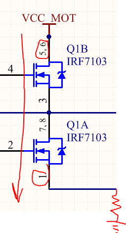

  • I realized while looking at this that my probing was incorrect.  I was testing the wrong pins.  It seems that pins 5,6 and 1 are all directly connected, which means there is a short through both FETs from VCC_MOT directly to MGND.
  • Hi Jon,

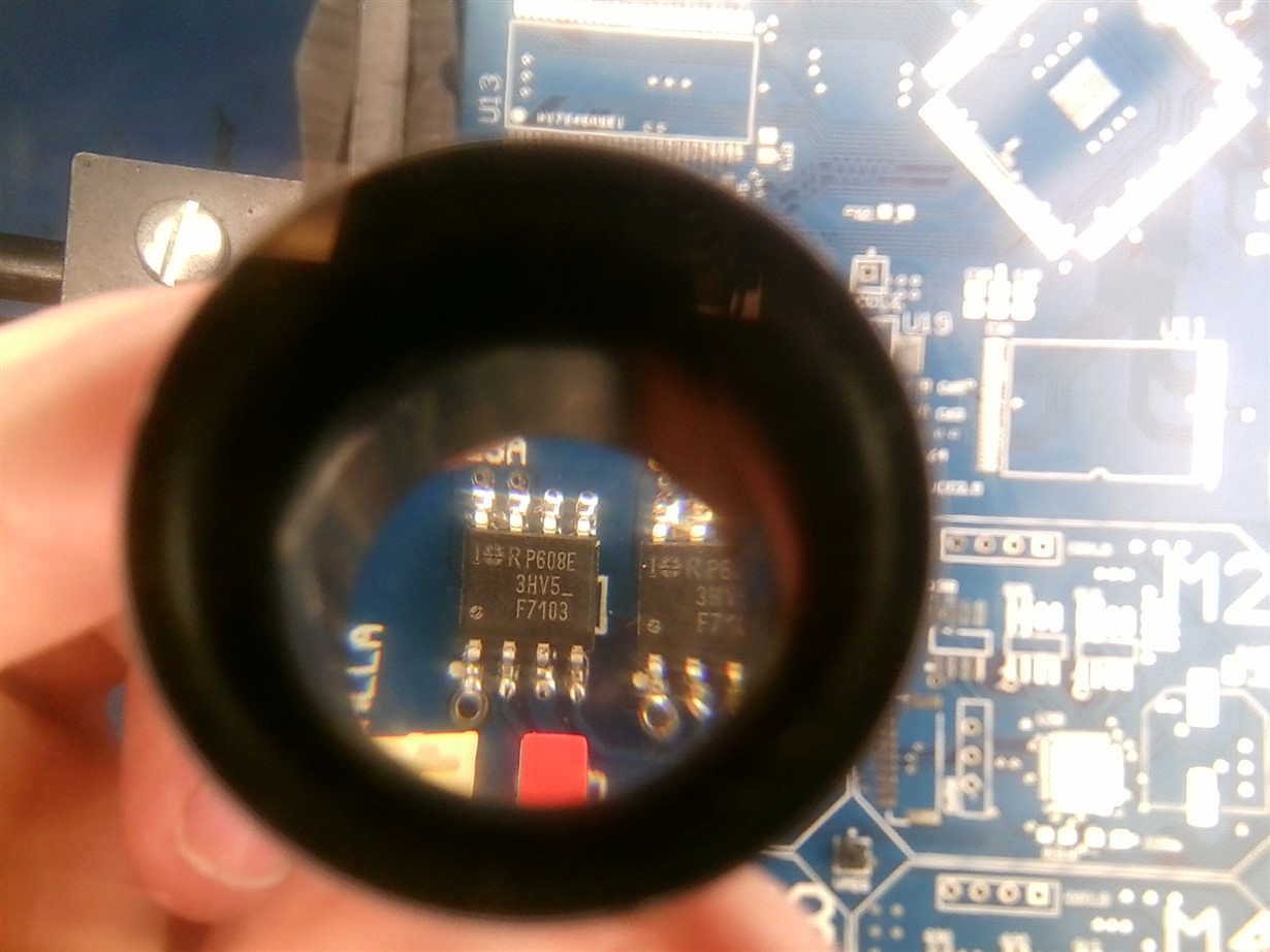

    Did you check the Pin 1 designator of the IRF7103 package against your silk pin 1 designator? If the MOSFETs were populated incorrectly then the body diode of each MOSFET in the package would conduct between VCC_MOT and GND. This would also explain why removing the sense resistor opens the short you're seeing.
  • MOSFET on PCB.  Pin 1 designator is definitely matched with silk.  All three look the same.
  • Hi Jon,
    Thanks for the image. I would suggest you try removing each MOSFET package and measuring the VCC_MOT and GND resistance. This will allow you to determine if one of the MOSFETs has been damaged. I would also suggest measuring the VCC_MOT and GND resistance once all of the MOSFETs have been removed to determine if there is a possible board defect on the internal layer in your PCB.
