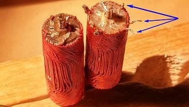

for my nephew who has a micro drone quad,
as well as repair she asked me to improve it.
The average life of a brush motor is really short.
He does not want another toy, he wants to improve what he has.

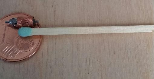

I started to edit the brush motors in a brushless, it is really simple:
Even fly it easily if they have 3 windings.
The minimum size is 3x2 mm for now:

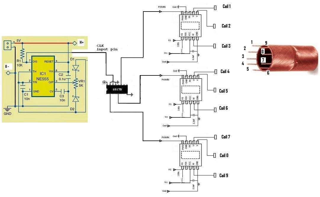

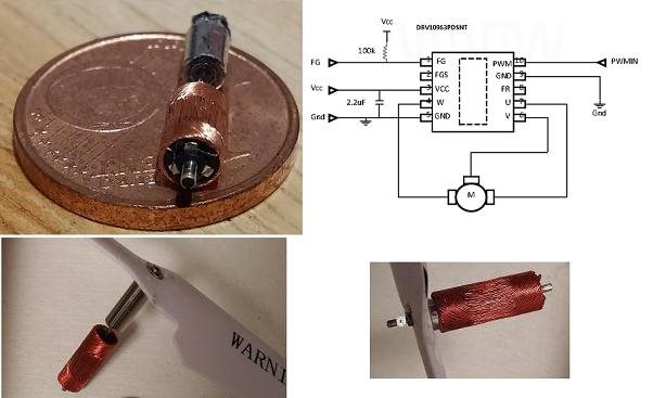

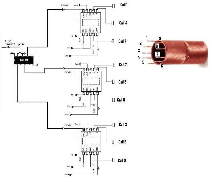

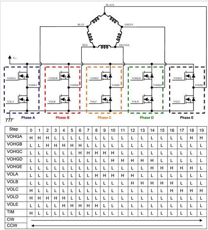

The problem is how to drive 5 windings in delta mode:
Transforming the winding in a STAR configuration is also possible but so too complicated, given the size of the tiny engine.
Any suggestions about a chip / circuit for a 5 winding delta mode
about 5Vdc and 500mA ?
